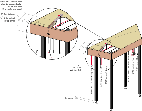

 Posted - October 28 2014 :  5:42:26 PM Link directly to this reply  Show Profile  Add Barry to Buddylist
This drawing shows an interesting connections . . . e.g., not to worry so much about perfect track alignment . . . have some cables below table to do the power . . .
