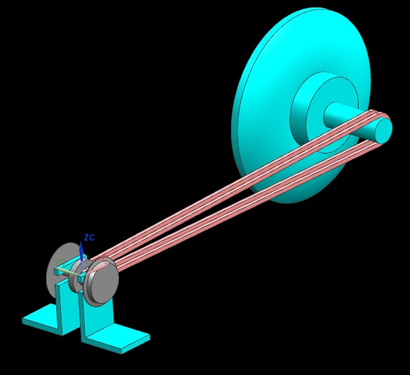

About twenty years ago, a reader submitted his setup to MR for grinding down AHM flanges. I remember the details very well, but not the exact issue - it was in MR Workshop or Clinic, I think. He recommended his improvised setup despite having a lathe, because the old AHM driver centers were fragile and their metal tires slipped easily. The setup was designed to avoid heavy stresses or heat buildup.
I've drawn up the grinding fixture in CAD. I've never used this setup myself for AHM drivers, but I tested it with some plastic wheelsets, at the time, and it did work.
Two metal strips were bent into ells and slotted partway through their uprights. A wheelset was placed between them and driven by a rubber band or rubber bands looped around its axle and the output shaft of a small AC motor. The original motor was from an old food mixer. You could use a drill motor with a piece of rod chucked in it. Speed was high (maybe 2000 rpm?) but torque was minimal. "Light finger pressure on the driver tire should be enough to stop the wheel from rotating". Plastic uprights were recommended when using this setup with plastic-axle wheelsets.
The flanges were ground down by brushing a cutoff wheel in a Dremel tool lightly against the flange (obliquely ) while the wheelset spun. (A grinding wheel also works, I find.) The reader also recommended that any bulging traction rings be carefully trued after the flanges were ground, in the same fixture ( I guess with an emery board or sandpaper or something, he didn't specify a tool for it).
Despite the deliberate lack of any radial cutting action (which would tend to slip the metal tires), the job goes quicker than you might think. I found it easy to take too much material off plastic wheelsets this way. I would recommend adding some kind of steady rest for the hand holding the Dremel tool. Nothing complicated, just something to rest the hand on - a block of wood would do. Taking hand steadiness out of the equation is a key to delicate work with simple tools.
The reader ended with a subtle suggestion that more information on rebuilding low-cost trainshow equipment for renewed service on model railroads would be a Good Thing for other MR readers. No significant evidence that the hint was ever taken. :/
