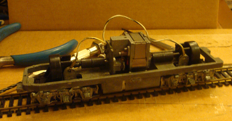

I acquired an old Athearn F drive
It would run sporadically with no pulling power so I oiled and greased to no avail. Upon disassembly,
I determined poor performance must be caused by bad bearings in the trucks

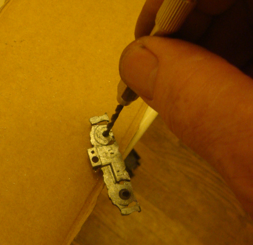

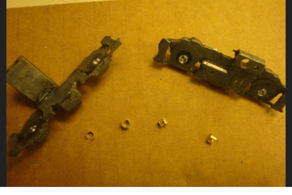

I decided to make some bearings. I want a good fit without stressing the zamac side frame. First I cut a channel long ways in a piece of 1/8 inch brass tubing.
Using a 7/64 drill I reamed out old holes in the zamac side frames and squeezed the brass bearings into the slightly undersized holes
After filing brass flush, I reassembled the trucks and the now the F-unit runs better than new.

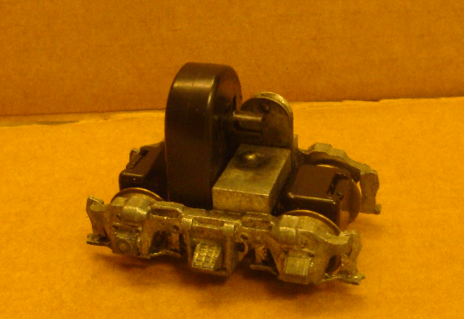

I know this is almost a year and a half since the last post. One other thing to look for on older Athearn units is the kingpin for the trucks.
I rebuilt a whole box of these that had been in the family since the 50's and 60's. Cleaned and lubed, including the kingpin ball and socket, put them on the test track and got the old familiar Athearn stutter and headlight flicker.
It was the kingpin ball and socket.
No matter how much you clean, the pot metal just is not a good conductor in that area.
