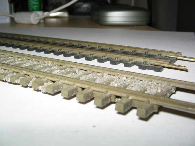

 Posted - April 10 2007 :  9:55:25 PM Link directly to this reply  Show Profile  Add Brianstyco to Buddylist
Here are pictures for side by side comparison of code 83 and code 100 track. Both examples are Atlas brand. Track in left photo is code 83 and track to right is code 100. The code 100 is from the 80's. The newer code 100 has smaller tie spikes just like the code 83.
