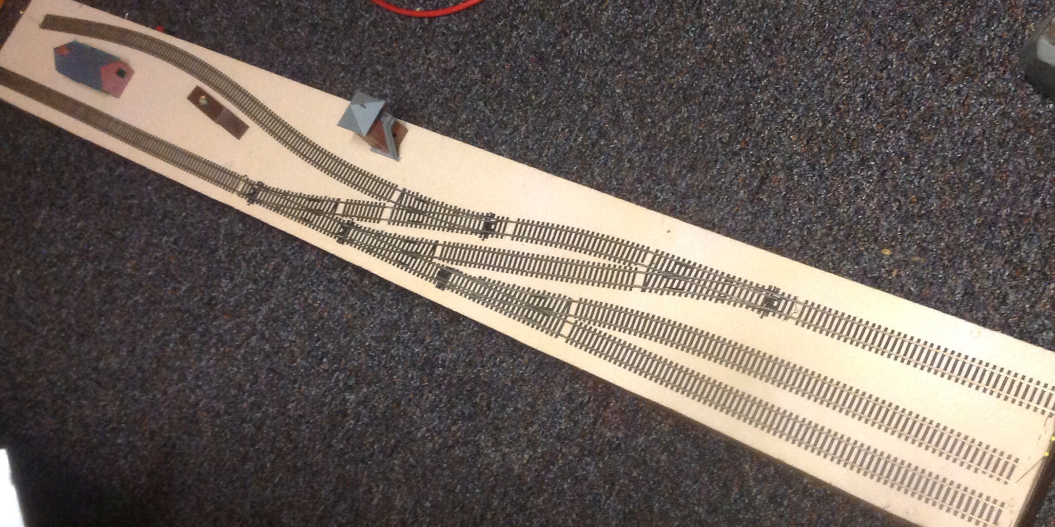

Just wanted to post my little shelf/switching layout. It's a bit similar to a "timesaver" plan. The whole thing measures eight inches by six feet. Track wires lead to a connector in the framing, so a power pack can easily be attached. The framing is 1x3 with quarter inch plywood topped with half-inch homasote. All track is Peco flex with power-routing turnouts, so no block wiring. I may build another six foot section to add to the left end as a staging yard. Here in Texas during the summer I can have this inside when the garage is too hot for the big layout. Chris

I love switching layouts!I apologize, I got a little excited there.The reason why I like switching layouts is because they're not just a circle of track where the train goes around and around on it although those are fine too, they're more "realistic" and slightly more challenging therefore being more fun to run trains on.

Cool idea Adams. I just came across a 1979 Tyco Model Railroad Manual that has some great ideas for shelf and switching layouts and interestingly, some great tech tips that remain relevant today.

Barry--Yes, I like those old sources. I have the Tyco Layout Expander and a Tyco Catalog that have track plans--none of mine have switching layouts, though. One of my favorite shelf/switching plans was in a '67 Model Railroader, called the Iron Mountain line. Hope I'm not breaking any copyrights here!

I had a " time saver" layout in the 50's and loved it. Living in an apartment and limited to a corner of the living room, it was the only thing I could use. You have inspired me to build another one. I may integrate the the Iron mountain plan to it
