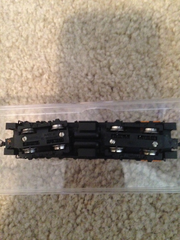

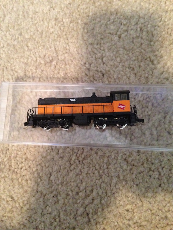

My Arnold N scale S-2 switcher in Milwaukee Road livery runs choppily on the N scale track I use. It runs smooth then just jolts to a stop and keeps on going. I think it might be the ginormous flanges but my code track is code 80 Kato Unitrack and the highest code of track where the flanges will hit the rails is code 70. I have no clue what the problem is. Can you help? Here's some photos of my model.

Not sure about your sudden stopping issue - but check the height of the coupler pins, sometimes they are too low and will catch on a switch, grade crossing or other trackwork enough to temporarily stop your loco.
I would think if the issue was the flanges it would run choppily all the time, but you say it runs smooth and then will stop with a jolt....and I have seen this happen many times when the low coupler pins were catching on things.

Well, when I first put it on the tracks, it runs choppily all the time. After a couple of minutes, it starts running smoother, only stopping from time to time. Of course, I will try this. I may just end up bringing it to Eastside Trains in Kirkland. They've almost never let me down when it comes to model trains. The only time they ever did was with the Flying Scotsman when they didn't have the right part but that's okay. They're only available in the UK so that made sense. This one however is American so I am almost guaranteed to find the part or whatever I might need to do to it there. I just wanted to see if you guys had any good suggestions before I went which I will sometime this week.

If by choppy you mean that it sputters down the track, that black crust on the wheels might be causing the problem.

I cleaned a bit of the crust off on one of the wheels and a ton of filth came onto the cloth that I used. I made sure I cleaned the entire wheel and I will make sure I test it at some point to see if it did anything. Thank you for your help, man! You're awesome!

Update: I also found a huge carpet fluff in one of the front wheels. It was so big that it must've been blocking the wheels from turning, causing the locomotive to run choppily.I got it out and any other carpet fluff out as well.

Ah yes, the biggest problem with carpet layouts (especially in small scales). Carpet fluff, sand, metal shavings and any number of other small debris are all locomotive-killers.
