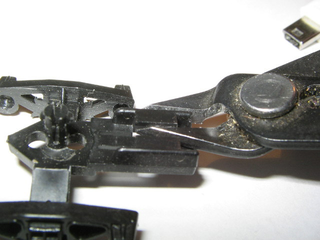

this picture shows truck being trimmed for body mounting coupler using sprue cutter. hold your cutter even and snip both sides and original coupler pin off.
this is what it looks like after trimming original-should be close to smooth and even-

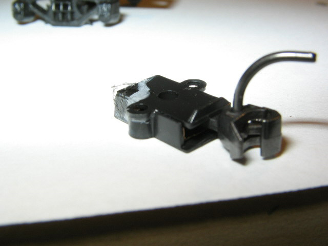

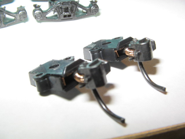

This is what your kadee coupler pocket should look like assembled for body mounting couplers

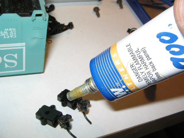

apply goo to coupler pocket
place coupler on center of car. trim the outer holes off coupler pocket for maximum turning on curves

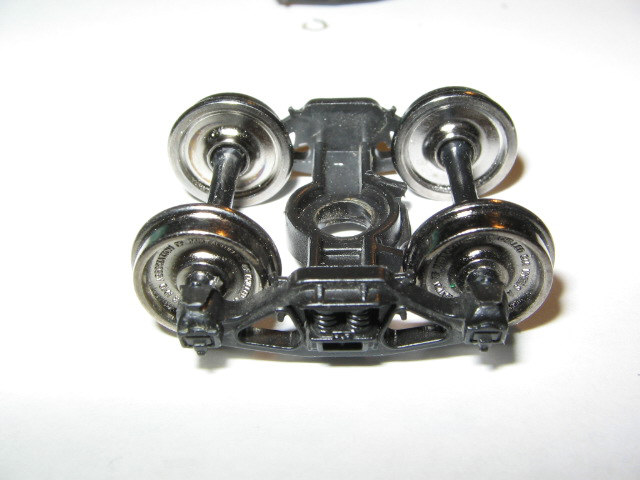

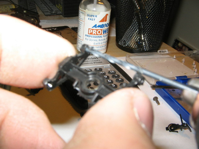

using 5/64 drill bit and holding truck-carefully enlarge holes on truck to install metal wheels. you must do this for them to roll freely. if you are going to use stock wheels skip this.(drilling tip-let drill bit go into hole slightly-make sure all plastic is out of hole

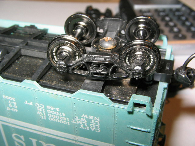

this is what it looks like with metal wheels installed
completed car with metal wheels and kadee coupler installed.

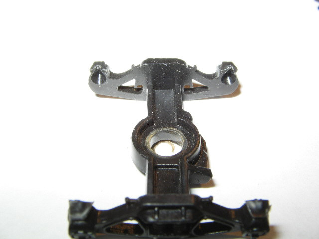

for mounting couplers on original truck using kadee housing-trim sides of original coupler pocket even( as shown in picture below)

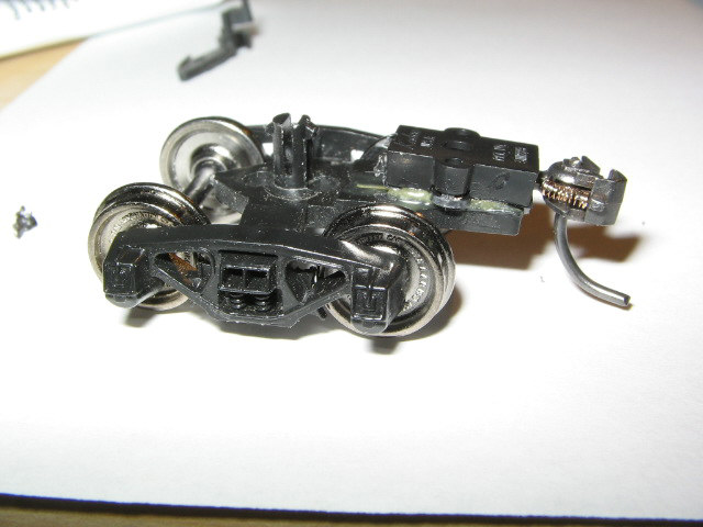

This is what your mounted truck coupler housing will look like assembled
picture of coupler mounted on truck and metal wheels installed.
