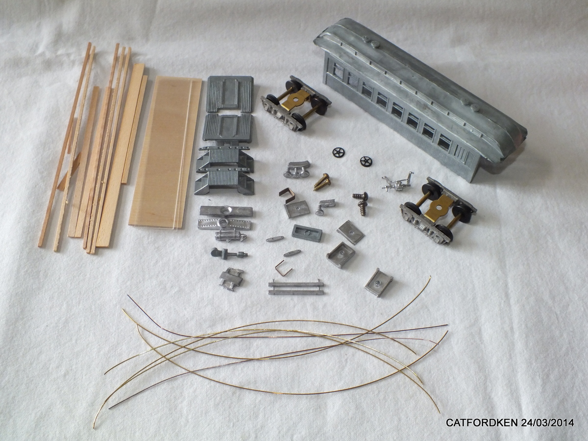

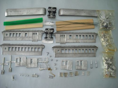

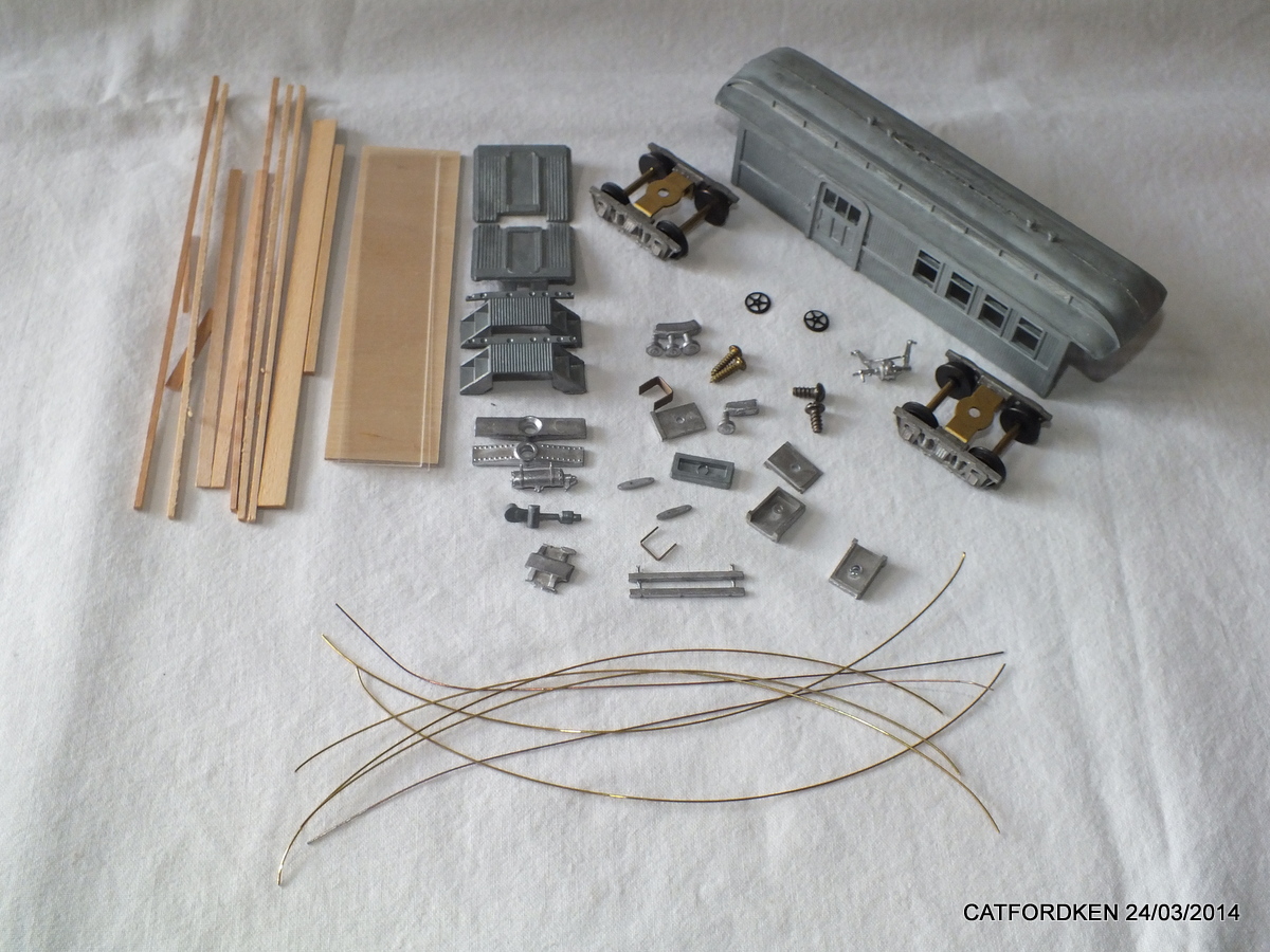

got this Selley coaches. question is how to paint them. need sugestions how to paint the floor and the inside walls and seats. also do not know what color i should use for the outside! maybe I color them in the G+D livery but I do not know the exact colors! maybe someone has some pics too! - Erich

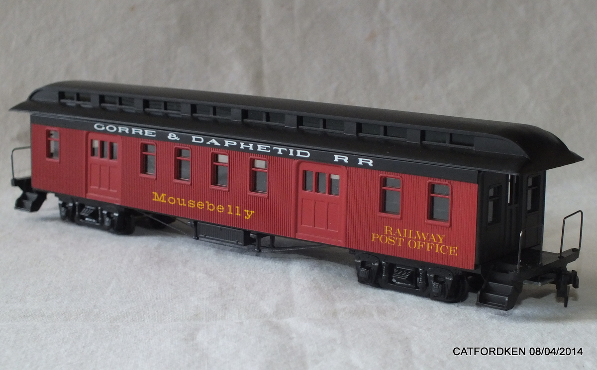

 Posted - April 22 2014 :  10:45:14 AM Link directly to this reply  Show Profile  Send catfordken a Yahoo! Message  Add catfordken to Buddylist

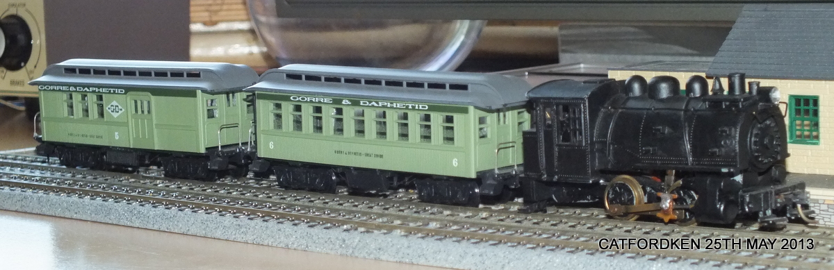

nearly same as mine erich,ken
g&d cars

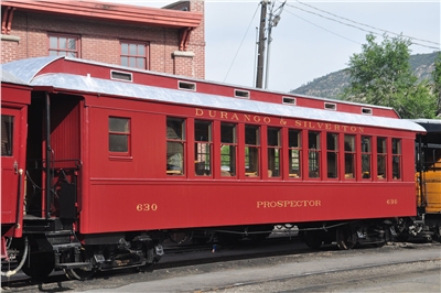

Thanks Ken ! found this pic
hard to tell what color it is........................is it oxide red?
found also some pics of green coaches made by Roundhouse.

Ken your coaches are diecast i think and easier to assamble (think they are later versions).
mine are made from pewter and naturally a bit weak! - Erich

Thanks for the instructions, now I can imagine how I'm going to paint them. The colors need not be the same, but should match the coaches. Outside I will color them in a more or less reddish brown. Think I use Boxcar Red.

 Posted - April 23 2014 :  08:14:04 AM Link directly to this reply  Show Profile  Send catfordken a Yahoo! Message  Add catfordken to Buddylist
hi erich the colour of the cars from what i have seen is more red than boxcar ken

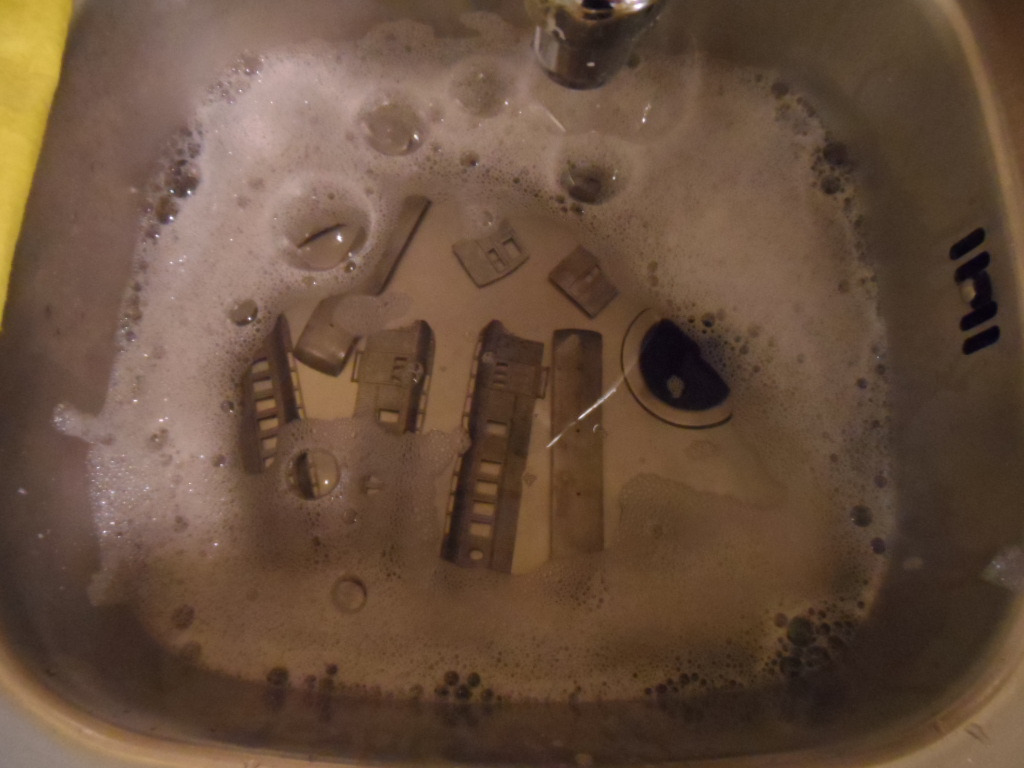

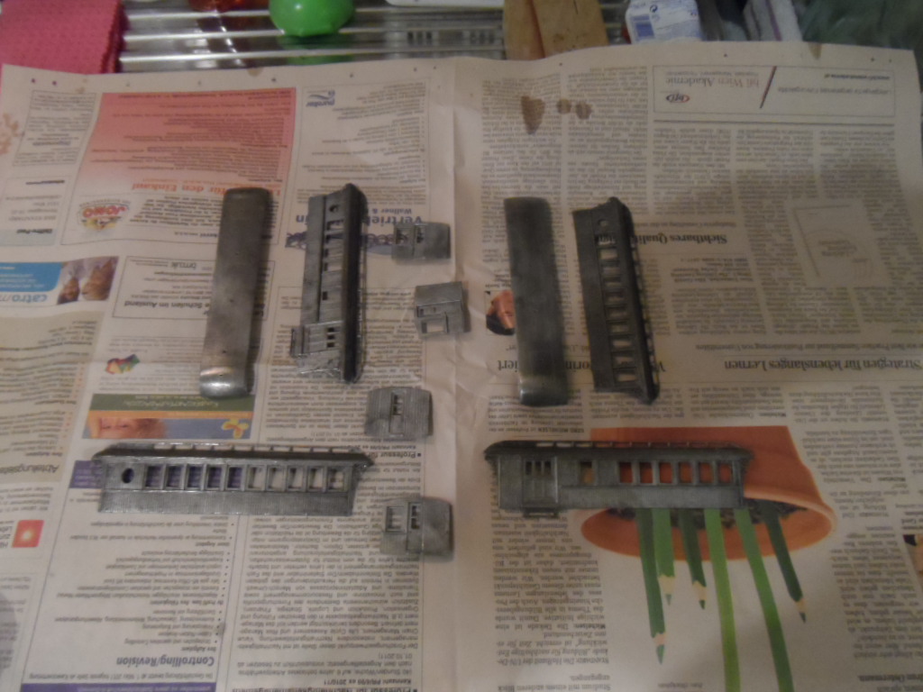

Just remember you are working with metal here. For a good paint finish use a primer first ( I use automobile shake the can primer then LIGHTLY smooth the surface) and then use only paint designed for metal ( I use SCALECOAT 1 ) Good luck. Can't wait to see the results.

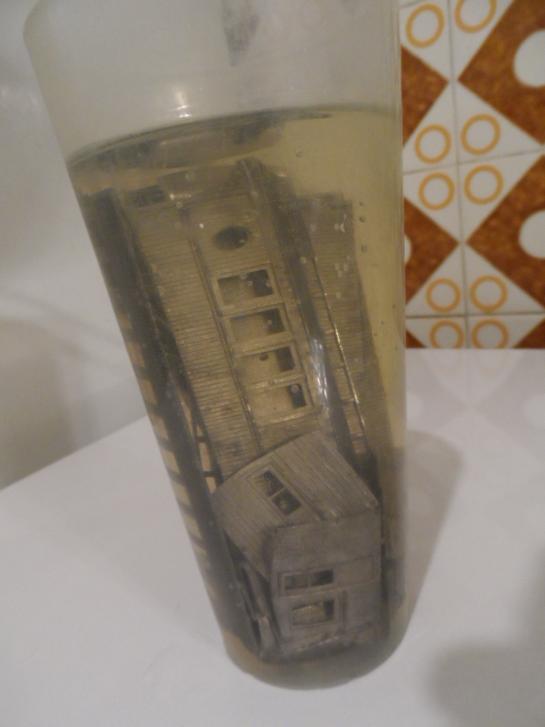

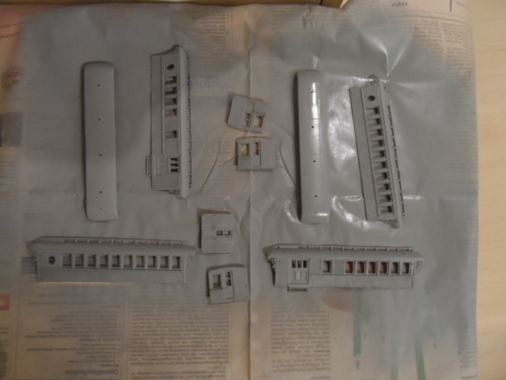

main parts at the kitchen sink in the dish water
in the vinegar
ready for prime
primed! - Erich
