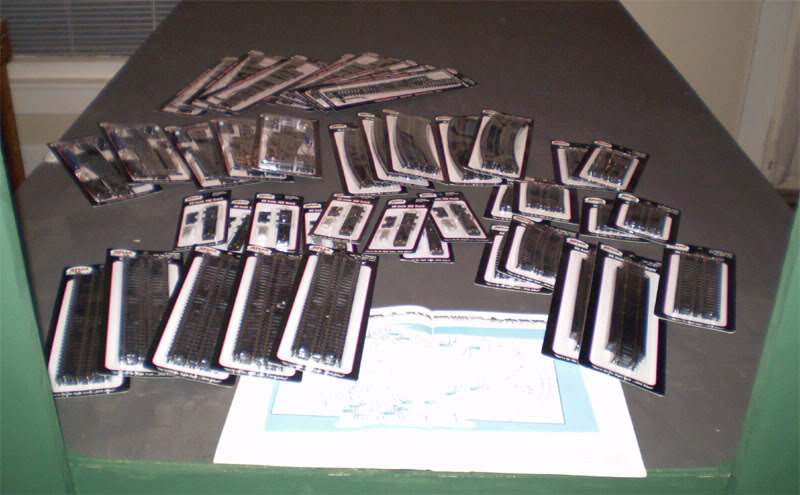

Friday night I brought home my collection of snap track. Here it is on the board...
You might notice I painted the layout's frame and pillars a dark green over the week. Also painted the layout's top a gray color.

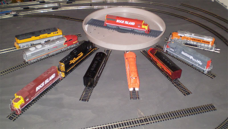

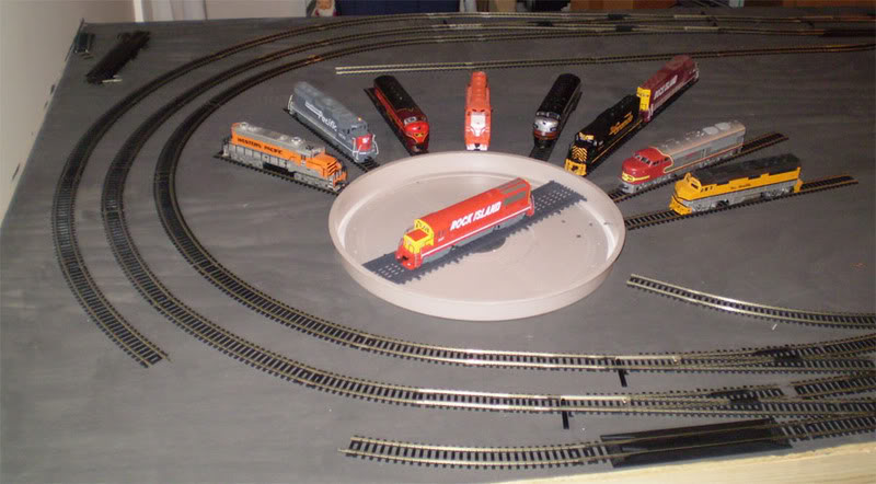

Here's a look at the future engine area where the turntable will eventually be sunk into the board...
In case you're curious...the locos here in the pic are a custom painted Rio Grande Bachmann-Spectrum F40PH...done years before the Ski Train stole my idea and did their own...a Proto 1000 ATSF Erie Built...a custom painted Rock Island Athearn GP-40-2 paired with a recent run Atlas Rio Grande GP-40...an MRC Espee Black Widow F-7A...a Proto 2000 TP&W GP-18...Proto 1000 GM&O F-3A...a custom built and painted SP GP-60 made from the Athearn GP-50 model...a classic TYCO Western Pacific GP-20...and riding the turntable base is the recent run Bowser-Stewart Executive Series Rock Island U25B.

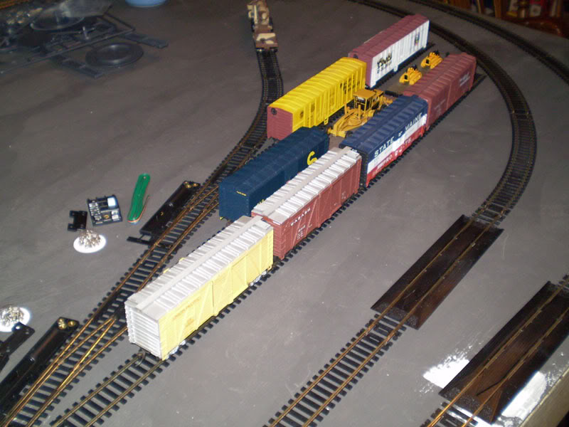

Opposite the engine area is a small yard area...
I picked up a case of cork roadbed yesterday and will begin working on that this week.
