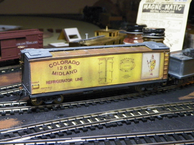

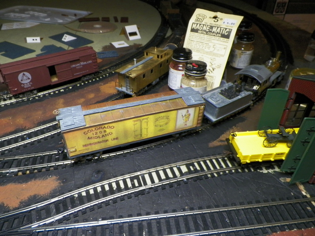

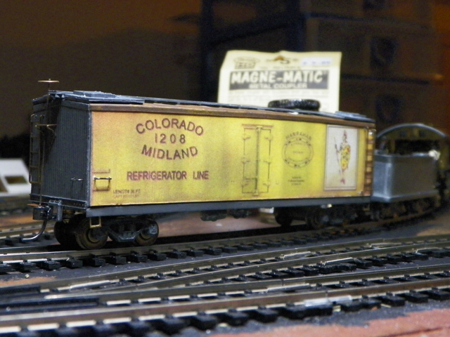

Choked up the cash for some new printer ink and printed a color card stock side for the Mantua Metal refrigerator car. Here it is entering "paint canyon" . . .
I pretty much left the other parts as is with the exception of cleaning and using some clear coat for protection. The only thing that got painted was the outside edges of the floor which were painted gray to cover the shiny aluminum.
Once again, I learn the value of photography as I see in the photo that the roof apparently has a tweek in it (shows up when the top line of the "framed" Indian drawing looks crooked). Need to get psyched to take the car apart again and straighten it!

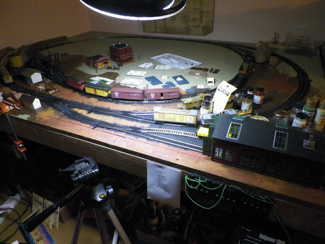

And just for grins, a shot of my layout/workbench . . .

Hey Don, I believe I found the image either on eBay or on Google [images], right clicked to save the photo, cropped it in the Windows Paint program (to remove wheels and everything but the side of the car) and saved it as a .jpg file. Then I brought the .jpg file up and printed it 4 X 6; as if it were a photo. Then I calculated the length I needed (5 9/16) divided by the length of the cropped image (6) and came up with that I needed to copy the image to 93% of the original (4 X 6) size. I ultimately had to trim a tiny wee bit with a razor knife that was hanging over the edge of the aluminum car sides. It was easier for me to do this with the Mantua refrigerator car since there weren't any opening doors to deal with (as on the box car). To attach the card stock side to the aluminum car side, I used one of those "roller glue tapes" where you unroll the glue on the back of a photo or whatever you have. It will hold good. Big problem is if you don't lay the paper down straight to begin with.
