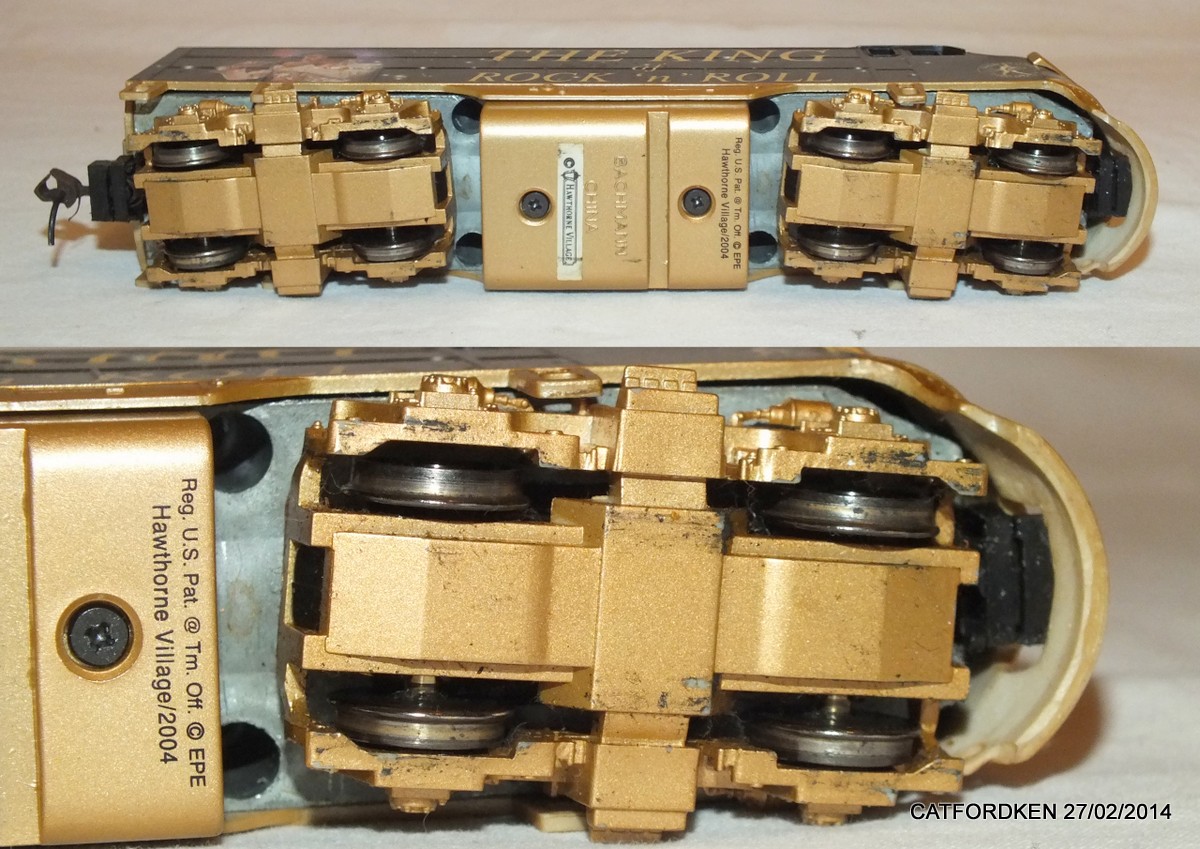

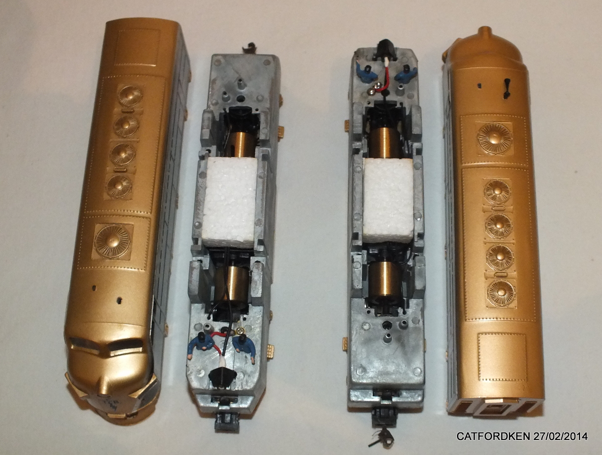

 Posted - March 02 2014 :  1:56:40 PM Link directly to this topic  Show Profile  Send catfordken a Yahoo! Message  Add catfordken to Buddylist
i have been trying for ages without much success,according to bachmann,you only need to undo the 4 screws,just gets stuck,i think its fault of the large coupler on front,ken
even bought a second one to see if it was just the first one that had the problem

 Posted - March 02 2014 :  2:09:17 PM Link directly to this reply  Show Profile  Add Erich to Buddylist
first lift the back and then slide it over the coupler bar! - Erich
Edited by - Erich on March 02 2014 2:20:27 PM
 Posted - March 02 2014 :  2:24:20 PM Link directly to this reply  Show Profile  Send catfordken a Yahoo! Message  Add catfordken to Buddylist
hi erich,sorry does not work on either,the coupler is far to forward for that to work ken
Edited by - catfordken on March 02 2014 2:25:09 PM

 Posted - March 02 2014 :  2:28:20 PM Link directly to this reply  Show Profile  Send catfordken a Yahoo! Message  Add catfordken to Buddylist
done it at last,but dreading putting it back ken
 Posted - March 02 2014 :  2:29:51 PM Link directly to this reply  Show Profile  Send catfordken a Yahoo! Message  Add catfordken to Buddylist
a lot of creaking but did it slowly with a screwdriver as you said,not what i call a tight fit but dangeroulsly tight ken

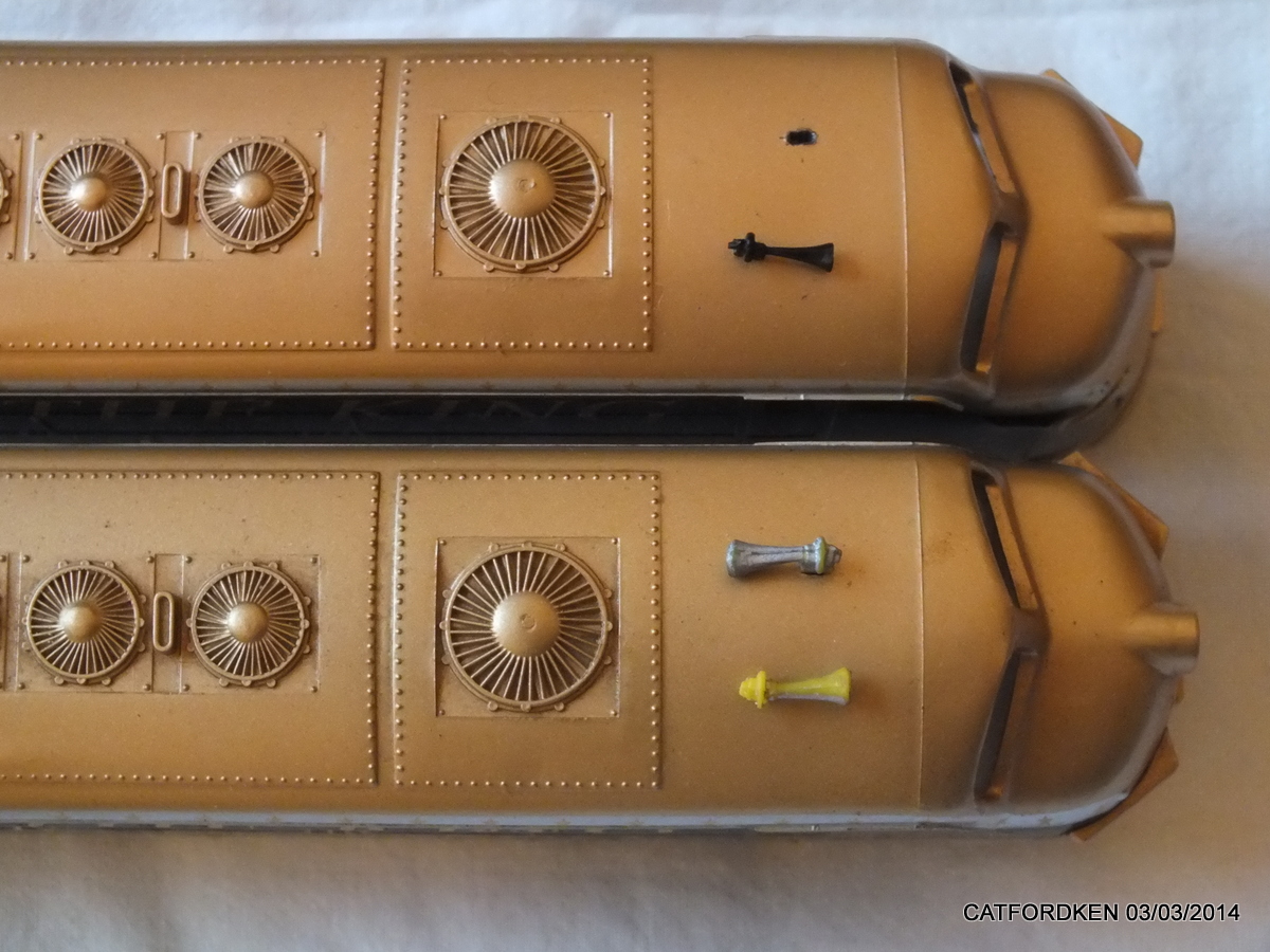

 Posted - March 04 2014 :  1:58:54 PM Link directly to this reply  Show Profile  Send catfordken a Yahoo! Message  Add catfordken to Buddylist
this is my horn problem,i want it as close to original as possible,the older horns are fragile,the newer ones are not much better but look better ken

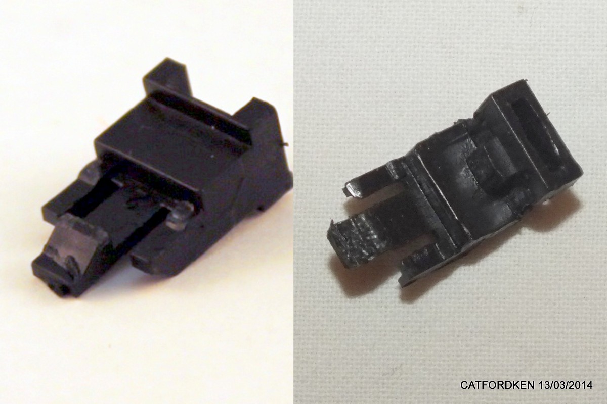

 Posted - March 13 2014 :  9:34:12 PM Link directly to this reply  Show Profile  Send catfordken a Yahoo! Message  Add catfordken to Buddylist
have noticed that on the newer versions the a/b cars are closer than on these,removed the front coupler box and body slips on/off with ease,so its the box that is the problem,ken
left new box,right the old one
Edited by - catfordken on March 13 2014 9:54:31 PM

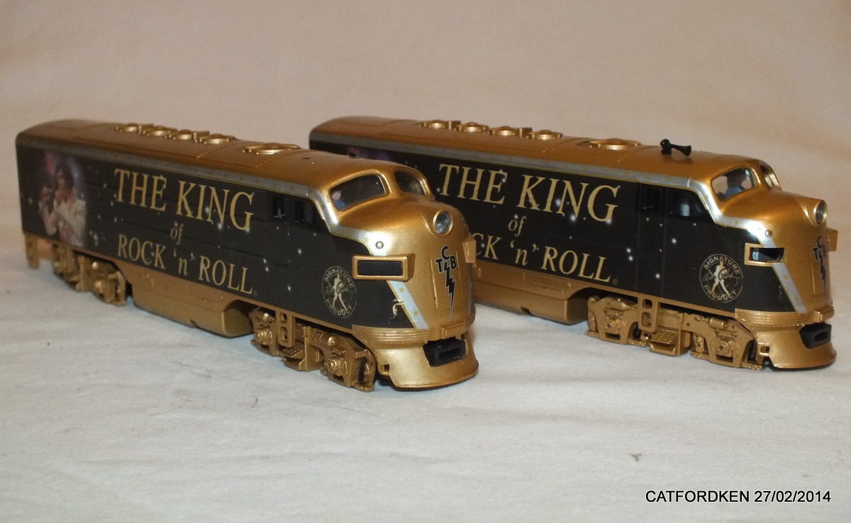

ZeldaTheSwordsman
G2 Slingshot
 Posted - December 09 2015 :  11:13:20 PM Link directly to this reply  Show Profile  Add ZeldaTheSwordsman to Buddylist
i know this is an old thread, but I'm curious: Are those diesels' shells painted gold, or actually cast in gold plastic (it looks like the latter, but I can't be sure). Gold plastic is a tricky business to get right; Hasbro and Takara's formula from the '90s is infamous for being brittle and prone to crumbling, which is compounded by the fact that it also suffers from slight swelling that makes parts rub tightly against each other. If these shells are gold plastic it could be that they have a similar swelling problem.
dastumer
 Posted - December 10 2015 :  09:01:02 AM Link directly to this reply  Show Profile  Add dastumer to Buddylist
Looks cast white and painted gold. Look at the fphotos on the top, the bottom view. You can see the inside she'll color
-Peter
ZeldaTheSwordsman
G2 Slingshot
 Posted - December 11 2015 :  12:35:55 AM Link directly to this reply  Show Profile  Add ZeldaTheSwordsman to Buddylist
You're right, I didn't spot that at first.
