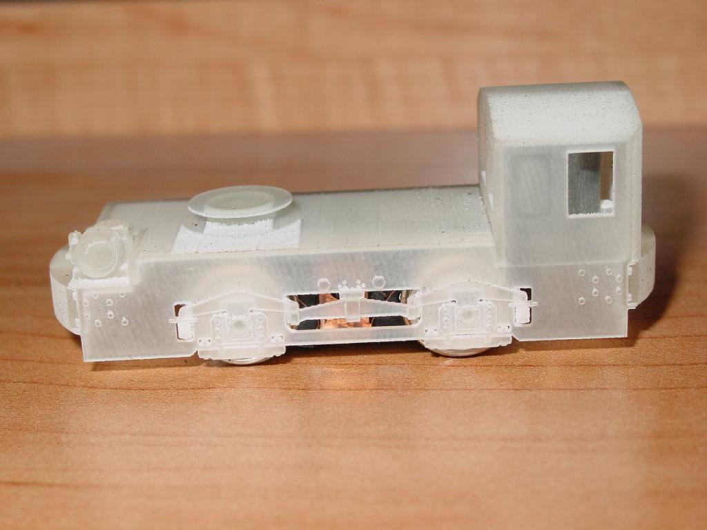

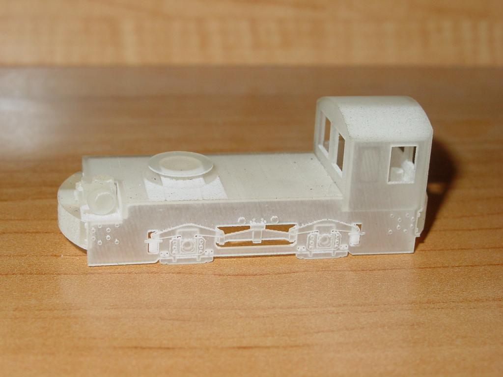

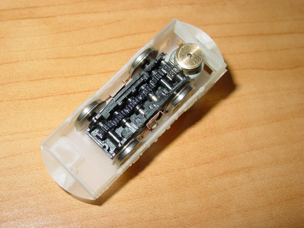

In my search for another small model to make a powering project and all the talk about 3D printing, I ran across a company called Shapeways. They'll 3D print pretty much anything from user created 3D software models, and they've built up a pretty good catalog of unique model railroad items. One of them is a very small GE 20-ton electric used on a few industrial lines, designed by "tschwartz1274". It was made to be a static model, so naturally, I had to power it.

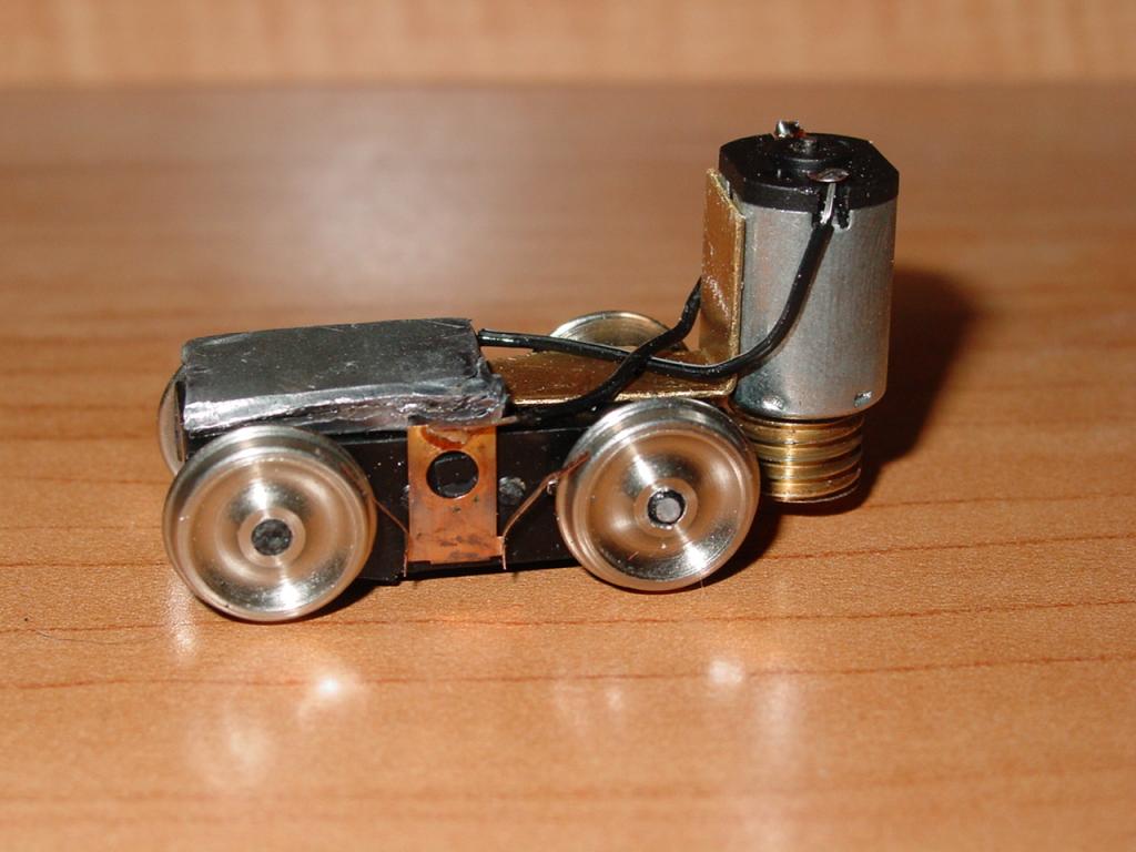

There's the base model, except I'd already removed the 3D printed static wheels. Finding parts to easily and inexpensively make a fitting chassis turned out to be more difficult than I thought, but I eventually came up with this:

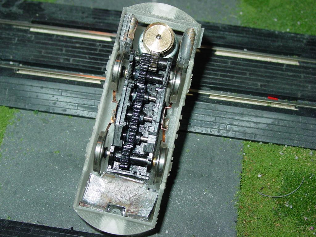

It's a modified Bachmann 44-tonner power truck, with NWSL wheels, the incredibly tiny yet powerful 1215D-9 motor, and some Kadee springs for wipers. This is the original defective truck from my Mack 15-ton project (on the MRR forum), but I was able to semi-repair the gears, tune it just right, and strengthen it with solid axles and metal axle bearings. It's not a perfect runner, but it's still pretty good!
It all just barely fits! The whole model is so tiny that the NWSL 1215D-9 is the only motor I could find that would fit without an extremely complex chassis design, and even with this it's pretty tight!
The wheelbase isn't perfect, but it's close enough! All I need to do now is detail it, paint it, put couplers on, and add a little more weight, and this'll be a good looking, good running critter!

Filled it full of lead today, and brought the weight up to about 4oz or so, making it one of my heavier plastic critters.
I also pulled the wheels out of gauge a bit, because it was having some trouble running over switches. It has that 4-wheel waddle, but it's a good runner overall.

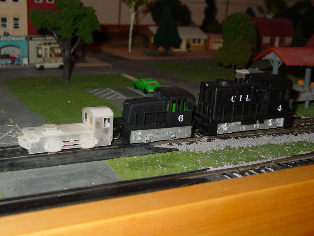

I thought I'd give a little example of how tiny it is, so here it is next to a Grandt Line 25-ton and an Athearn Hustler.
Darth Santa Fe, doing weird and challenging projects for the fun of it!

No shoe horns required. I made it so the shell drops right onto the chassis, and I'll lightly glue it in place once it's painted and finished.
The printed plastic is about the same as clear window plastic. It's very tough, and has a little bit of flex, but it will crack if you're not careful.
The idler gears in the 44-tonner truck are a slip fit on metal pins like with most Bachmann drives, but the original wheels were press fit with half-axles, like Athearn. Of course, this makes it easier for the cheap gears to warp and crack, so I drilled them out a little for a light press fit on a solid axle, and I drilled out the axle holes and pressed small pieces of brass tube in so the wheels roll in all metal bearings. This should help it last much longer.

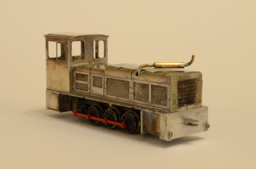

hi Darth Santa Fe,nice work,came across this,and thought how similar they are ken
