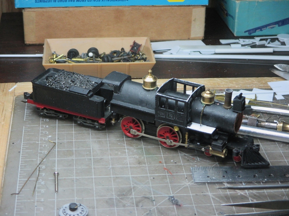

* Now I did a little today and my photo shows problems. One the steam dome is just a new base for the dome. The second is the boiler is 1/8" to short. So tomorrow I'll work on making it 1/8" longer.
* just like today and a hole lot of other days this month most of my will be spent shoveling snow. It seem we have gotten snow about every 4th day this month. Today we were to get 3 or 4 inches. We got 15. That would be so bad but we got 10, 3 days ago. 4 days before that 8 inches, and 2 other show events before that. It is raining right now. it should turn to show soon. It is now to stop till 5 or 6 AM. They say another 3 to 5 inches. If I do my math right and 3 to 4 give 15 inches of snow. Than 3 to 5 should be more. Maybe 16 or 17.
* well here is the 4-4-0 today.
Edited by - toptrain on April 20 2014 6:05:34 PM

** Now a update before more work is done. **
* this is my thinking ahead post !
* I have replaced the front pilot section which includes the cylinders. On the old one when I was trying to bend up the pilot section before I cut the old broken pilot off I broke the part where the platform joins with the cylinders. I really don't think that a glued joint would have held long, so it is replaced. This is probably just temporally. Maybe I should put the old one back . I am certain I have another one with a broken pilot. I have a longer old fashion pilot that is seen in the drawing. It came off of the Mantua Reading P7 I kitbashed.
* The headlight is large. The Headlight, smoke stack , and sand dome all must look the same in size, as on the drawing. That will be hard to do.
*Also on the cab of which I modeled #615 and not 424, because I know I won't be able to decal the name James Donnalley on the cab side one letter at a time and do it straight. This is why I chose to do 615 instead. I need to do only 3 numbers. Less chance of messing up. Now the center section on the cab side with the wood grain detail isn't the best of backing for decals . I most likely make a number board to fit the space. I have choices to make here and 615 may become 424 again for obvious reasons.
* That's enough thinking ahead for now. I've already been out shoveling the snow away from around the house. Now I got to go dig out car again. Wonder of wonders. They are talking about snow again on Saturday or Sunday. How nice. It is nice and sunny right now and should melt away some of the snow.
* Have a nice day everybody.

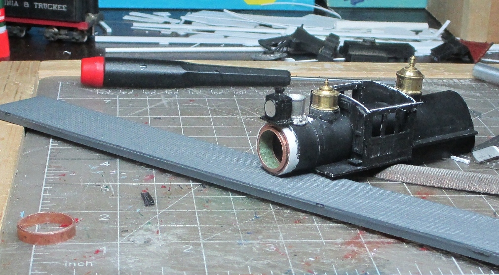

Now to fix the boiler being 1/8" short. I made 2 rings using brass pipe of 2 different sizes. One 3'8" long, fits snuggly inside the brass pipe used in the boiler. the other 1'8" long is of the same pipe as the boiler. I krazey glued the smaller inside the boiler leaving 1/32" lip extending out of the boiler. That is where I am now.
* You can see everything I have just described. Also the second ring ready to install.

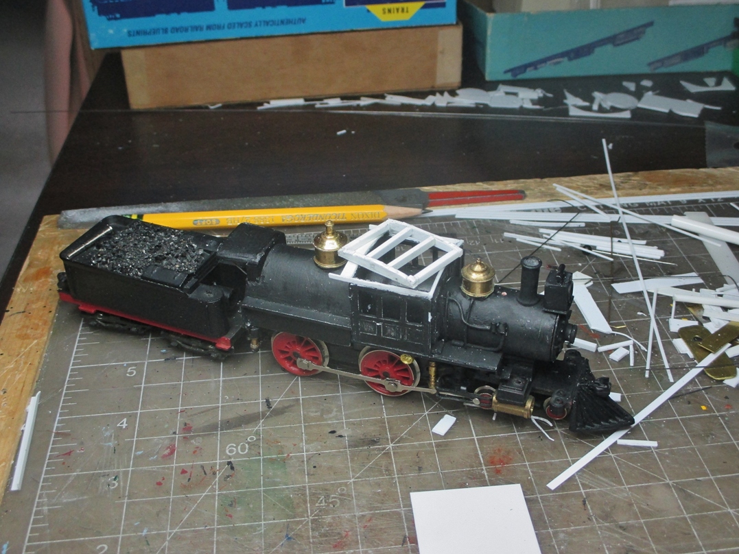

* Now here is the unfinished lengthened boiler. Now is the time to make the boiler look nice.
 Posted - February 28 2014 :  11:12:41 AM Link directly to this reply  Show Profile  Add toptrain to Buddylist
* Now I have with the addition on another spacer between boiler and cylinders I have a straight boiler. It is supported at a good height for the ash accumulator box to placed on the pilot under the boiler smoke box.
* Now for the walkway steps front and rear, and handrails.

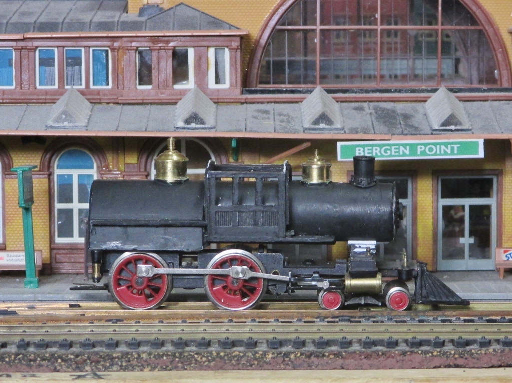

Thanks Mike. I have put 3 hours in this 4-4-0 this morning. I made a light. I had a front casting of a light from a MDC climax and just added everything else. Even a shelf. Because of the time waiting for glue to dry, I worked on the tender filling in around the motor. This is a coal burner so I will fill the tender with coal covering the plastic overlay. I am sure all will work out alright. Thanks for the offer Mike.
* Here is the 4-4-0 right now.

* Here is the 4-4-0 with coal in the tender. the new light painted black, the fireman's shelter supported, sand pipes installed, I changed the smoke stack, front walkways resurfaced, hiding all the times I have changed them.

Now some of the piping is done and I've started on the removable roof. I want always to be able to get into the cab. For various neato reasons.
first with the removable roof frame in
Next with it out.
 Posted - April 13 2014 :  6:17:26 PM Link directly to this reply  Show Profile  Add toptrain to Buddylist
My new removable roof is a success. Looks great and comes off easily. Lots of handrails put on and other details.
 Posted - April 14 2014 :  12:09:08 AM Link directly to this reply  Show Profile  Add NickelPlate759 to Buddylist

 Posted - May 01 2014 :  5:38:16 PM Link directly to this reply  Show Profile  Add toptrain to Buddylist
Some touchups and a even coat of paint.
 Posted - May 04 2014 :  8:12:39 PM Link directly to this reply  Show Profile  Add toptrain to Buddylist
Almost done! Maybe I am.
About my choice of road number. Number 5 is the locomotive "David Laury" A man with quite a history of service to his comunity and the Lehigh Valley railroad. This locomotive was chosen to pull the first run of the "Black Diamond".
