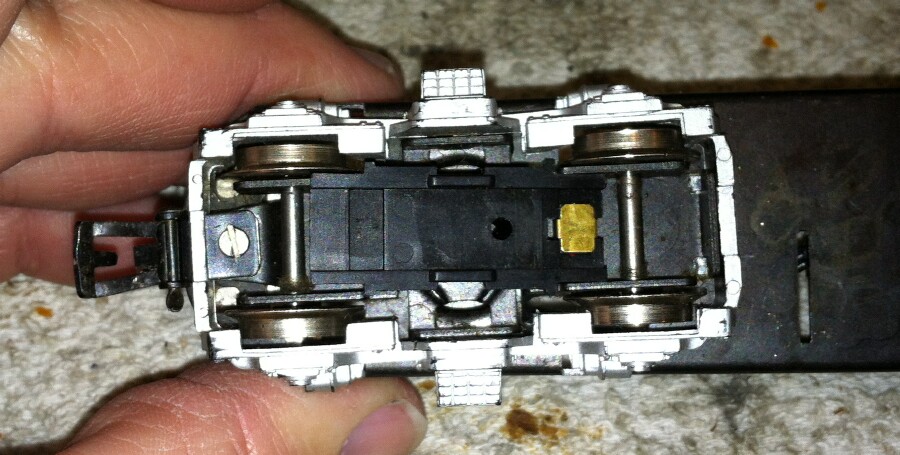

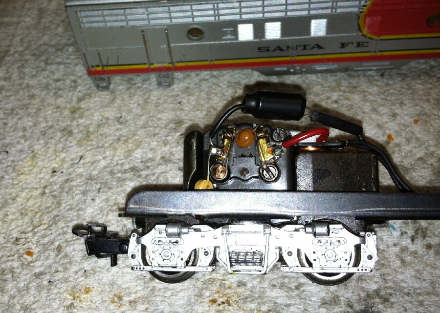

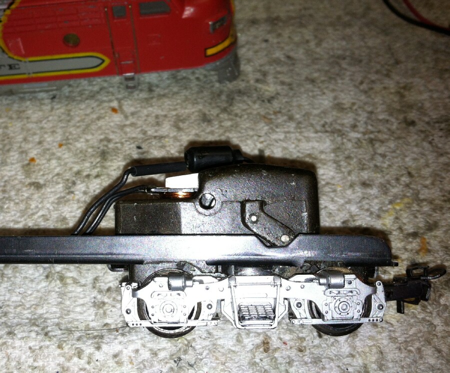

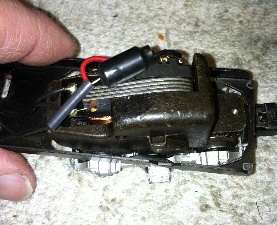

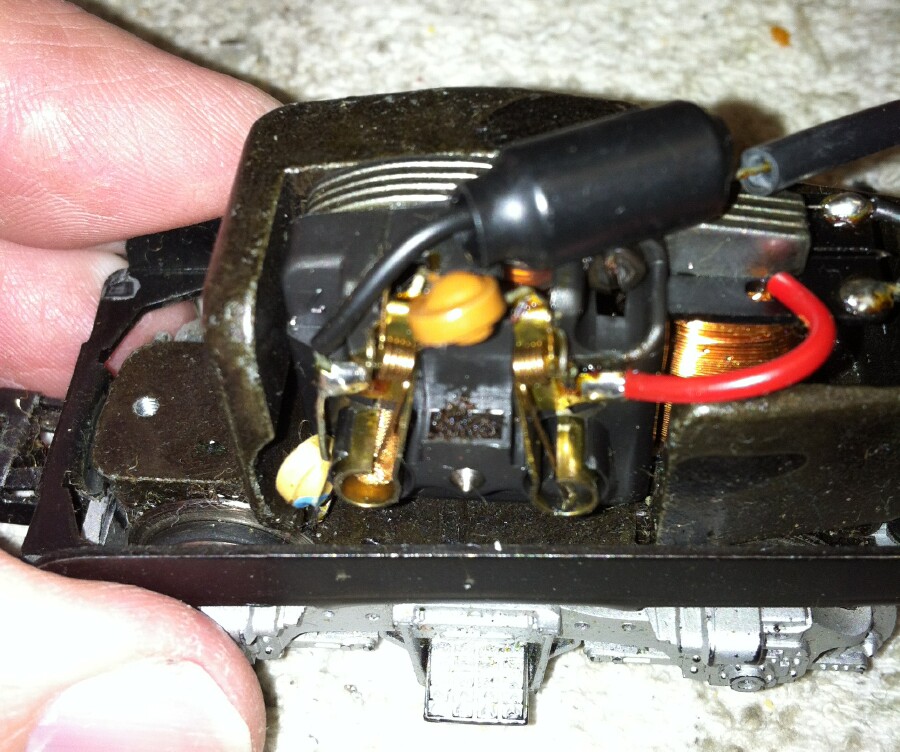

Another interesting repair I'm working on is a vintage Marklin HO diesel, a Santa Fe F7? which runs off AC voltage. Wasn't running, and after some vigorous gear-twisting, I got the motor to finally break loose and turn over, then run. Oiled it a bit, and it's humming along fine. Needs some parts ( 3rd rail pick-up slide is missing ), but at least its working so we know it's worth repairing. Going to try to find parts online. Another neat thing about this old engine, is that the motor shafts actually have hot boxes to oil them! Tiny little boxes with a small foam plug that you oil, and it keeps the shaft oiled. Pretty nifty, them Germans! The shell is all metal, too. Here's some pictures of said Marklin engine -
Anybody know of a good source for vintage Marklin HO parts? I've done some searching, but haven't found any definitive source I could order from yet. All it needs is the center rail contact slide, and the screw that holds it on ( I think ). Would be nice to find a parts diagram for it as well. Vintage stuff can be challenging to work on. Appreciate any leads on the Marklin.

If you can find out what the original shoe looked like, you might be able to make one out of some phosphor bronze, even if it's just a stand-in until you find the part.
Interesting that Marklin made pancake drives, too, but they look like they were built to last a lifetime instead of just 40 hours. I also noticed in your closeup that they used a combination of carbon / rolled mesh brushes just like Rivarossi. I always thought RR was the only one to do that, but maybe that's where they got that practice.
