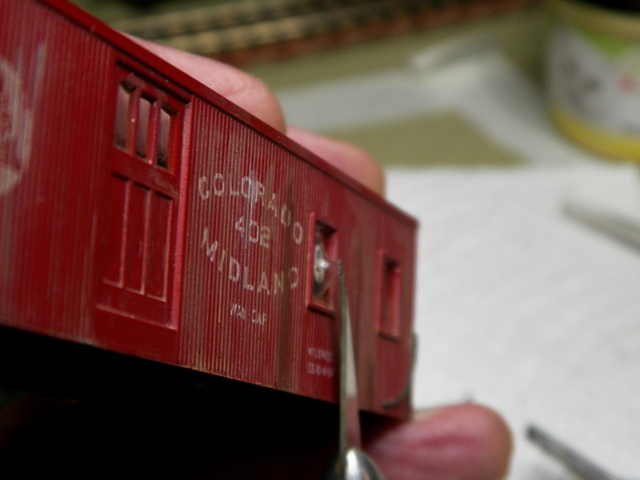

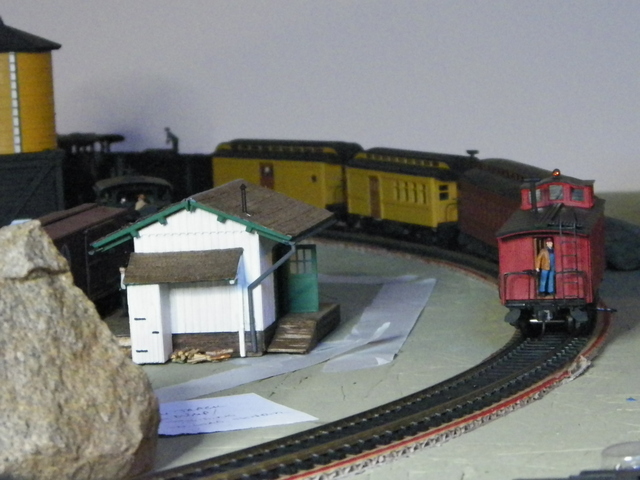

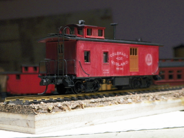

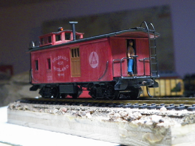

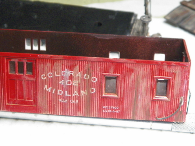

I got this caboose ready built because I wanted a Colorado Midland caboose, and, when I got it, I thought it was really cool because it was "weathered". Recently, I began looking at it with a little more scrutiny and began thinking that the weathering was a little "over the top" . . .
I wanted to remove the weathering and preserve the factory (Roundhouse) painted Colorado Midland lettering scheme. Well . . . after rubbing and rubbing with a q-tip and alcohol, I was able to get enough of it off that I could live with it for awhile ("push comes to shove" and I'll strip it and just do without the lettering, but for the time anyway . . .) and I didn't destroy too much of the lettering.

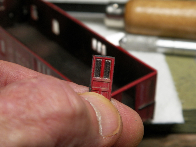

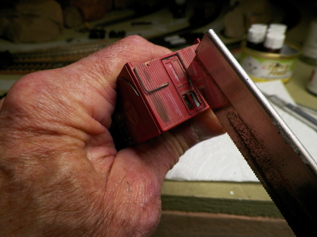

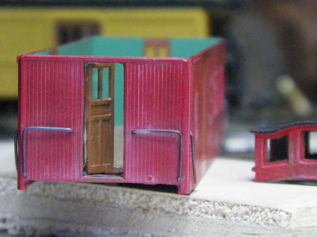

Then, I couldn't resist messing with it. I have another of these cabooses without the lettering and on that one, I'd cut out one of the side doors to be able to model it partially open. This time I decided to get after one of the end doors. It turns out that a razor saw was easier for me to work with (less straying from the cut) than a knife . . .
There was something with this model that I had never seen before and that was the way the glazing was done. All the windows were glazed when I got it, but while it was a very tidy job, the windows looked phony because they were a bit convex (equally convex, but convex none the less (you can see this a bit in the first photo above). It's like the windows were made out of something similar to that stuff they use to sell to kids where you squeeze it out of a tube and it's like a permanent bubble; if you recall anything like that. Anyway, that stuff was quite a pain to remove . . .
This next photo is putting the door in place (you can also see how I painted the interior (though if I do get around to really detailing the interior, I will need to redo my glazing; mine looks good from the outside, but I was rather cavalier about cutting the glazing to exact size) . . . Also, in this photo, you can see how most of the weathering came off; now maybe just enough left to look a bit more realistic.
I also replaced the ladders (one day perhaps, I'll try to get serious about the quality of my bending and use a jig . . . not very happy with the curves over the roof . . . seems like real ladders would be made of heavy enough steel that they wouldn't get beat up like these). The Roundhouse ladder set-up has the ladders ending underneath the roof . . . need to be Spiderman to get on the roof.

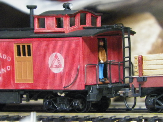

Anyway, here's a few photos of the "finished" caboose . . .

That's a cool looking caboose. I like the added touches like the open door and the painted interior.
That's also a rare bird. I've never seen another MDC caboose quite like it. I have an MDC side-door caboose, but the cupola is more like the one they use on their other cabooses, and the windows are arranged differently. It looks good with your other period equipment.
By the way, is the roof fastened down yet? I think the cupola might go above the end that does not have windows. Typically, there are cabinets and closets under the cupola and the seats and bunks that would be by windows would have more head room if they were not where you put your feet when in the cupola.

I was wondering about the position of the cupola Don (and regarding that, the Colorado Midland was one of the few . . . I wont say only . . . that used that style of cupola) . . .
I should have reviewed the above photo, but . . . the roof is only attached as much as the ladders are, so I think I can get it off and put it back on without too much damage.
I need to review more photos of caboose (with cupola) interiors to see how that plays out in terms of steps or a ladder going to the cupola seats, etc.
Thanks for the tips Don.
 Posted - January 18 2014 :  02:12:42 AM Link directly to this reply  Show Profile  Add Barry to Buddylist

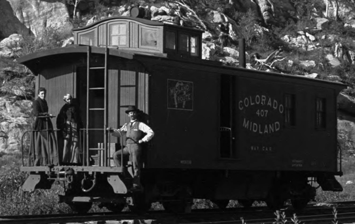

And, Don, actually looking at that prototype photo again, I see I should redo the ladders anyway and just have a grab iron on the roof. It's interesting to me that the cupola seems set off to one side in the prototype photo.
Originally posted by Barry - January 18 2014 :  02:12:42 AM
I think that may be an illusion caused by the camera angle. The roof walk is centered on the roof and the center window of the cupola is centered on the roof walk and appears to be centered in the cupola. Funny, though, that the roof walk goes around one side of the cupola but there are grab irons on both sides.
It'd be interesting to know more about why things are how they are on that design.
 Posted - January 18 2014 :  11:57:24 AM Link directly to this reply  Show Profile  Add microbusss to Buddylist
Plus it looks like the roofwalk goes AROUND the cupola
 Posted - January 18 2014 :  12:30:18 PM Link directly to this reply  Show Profile  Send catfordken a Yahoo! Message  Add catfordken to Buddylist
nothing wrong with caboose,just perspective of photo makes it look offset but its central,line up window and roofwalk ken

Well I just couldn't sit still and live with that ladder error . . . Don, I want to thank you again for pointing that out. That emphasizes to me once again the value of this forum.
Plus an alternate photo of a Colorado Midland caboose . . .

You know, sometimes it seems like it just never ends . . . I'm looking at what I just posted and see that I should have put the ladder on with the rails welded to the interior side (comparing to the prototype photo) . . . the value of a camera! Well . . . at least that glue seems to pop off easily.

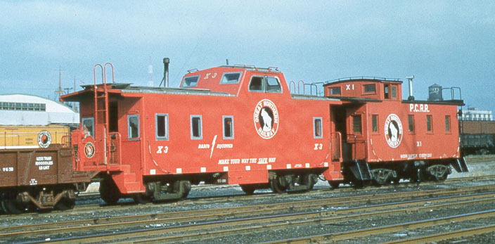

Ken, do you know the story behind a caboose with a Great Northern herald and PCRR reporting marks? Maybe some kind of subsidiary?
 Posted - January 18 2014 :  5:52:01 PM Link directly to this reply  Show Profile  Send catfordken a Yahoo! Message  Add catfordken to Buddylist
hi scsshaggy,cannot find out a thing about the p.c.r.r. ken
 Posted - January 18 2014 :  6:08:43 PM Link directly to this reply  Show Profile  Send zebrails a Yahoo! Message  Add zebrails to Buddylist
Pacific Coast...
Sort of a personalization of a particular use for the caboose. I believe it is also a precursor to an international use caboose, since the Great Northern had lines into British Columbia.
The streamlined caboose was an experiment, albeit there were about five or seven of them.
To ward off the hard cold air as it struck the cupola during the winter seasons. Also note the high-speed trucks!
That's what I know.
p.s. You must respect the nicknames of these "end of train" devices... The prototype and model of your rehab is a "Waycar"...
Cabooses, Hack, Crummy, Glory Car, Waycar ... these are merely five of approximately 30 different names of these things.
