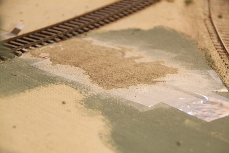

I thought maybe a few people might be interested in my method of applying ground cover. Most methods involve some means of covering gaps in benchwork to provide a smooth surface. Mine is as easy as using pieces of those plastic grocery sacks we seem to accunulate in inexhaustable amounts.
I cut them into strips that I place over the gaps, then hold them down with scotch tape, then I put a layer of ground cover over them and fasten it down with a liquid latex and water mixture. This allows the ground cover to remain flexible so it will expand and contract and not break up
I have also usedpaintable window calk to fill gaps
String Bob

String boB
 Posted - December 25 2013 :  8:31:06 PM Link directly to this reply  Show Profile  Add String boB to Buddylist
Looks good Ken. I see you've got a couple different levels of track. Do you have your siding and spur tracks pretty much laid on the "ground"? Merry Christmas! Barry
Originally posted by Barry - December 25 2013 :  12:22:06 PM
Actually, what you're looking at is two legs of a wye across the top of what I call Mooar Yard. I use it to turn locomotives and passenger trains that arrive and depart from here. The two tracks converge in the upper right of the photo at a place called Mooar Junction
String Bob
