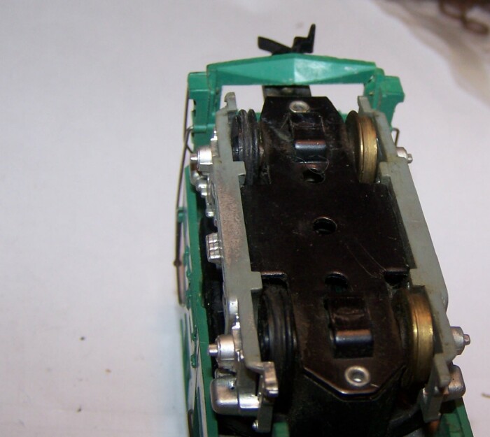

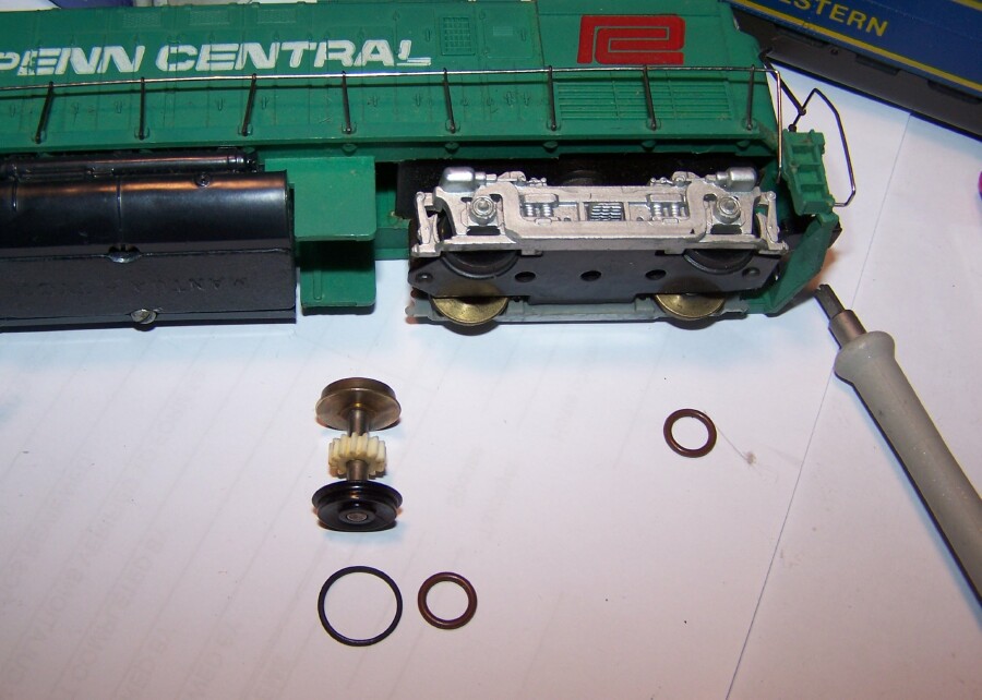

 Posted - December 08 2013 :  11:32:37 PM Link directly to this reply  Show Profile  Send AMC_Gremlin_GT an AOL message  Send AMC_Gremlin_GT a Yahoo! Message  Add AMC_Gremlin_GT to Buddylist
I just replaced the O-rings on the GP-20 engine, and I didn't have to take off the side frames.
In the bottom picture, the Mantua traction tire is on the left ( bigger black ring ), the smaller brownish ring is the GP Sorenson Fuel Injection o-rings someone mentioned in another post on MU-2 repairs. They're thicker, stiffer, and would require removal of the side frames to get them on. I stole a pair of original tires off an F9 unit that had cracked plastic wheels on it. So you can replace original types without having to remove the side frame, but any thicker O-ring will probably not go on that easily. FYI....
