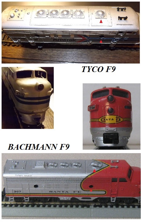

Is a Tyco F9 Really a F7? The dynamic brake fan is the smaller fan used on most of the F7s and the location of the front port hole is correct for the F7. I have included some images that show a Bachmann F9 with these details modeled correctly for and F9.

John - you got me curious and I set off on a Google search. The differences between the F7 and F9 are mainly gradual and unseen, and even the diameter of the dynamic brake fan is not reliable in determining what is what.
This is probably the best guide I found: http://trainweb.org/jfuhrtrain/CF7frames/F7Phases/F7phase.html
The only reliable difference, mentioned by many sources, is the existence on the F9 of vertical louvers before the first porthole (and ironically I don't see louvers before the first porthole on either example you posted!).
But anyway, there is plenty of interesting reading from many sources when I entered "differences between F7 and F9" on Google.

The research I've done indicate the following:
1. Some late F7As had 48 inch brake fans.
2. The placement of the port hole was unique to the F9A.
3. The F9A new units were never built with 36 inch Fans.
Many F units were upgraded to later units, so the TYCO Fs could represent a unit upgraded to F9 status. The TYCO units resemble new F7As.

I would agree with all that, based on what I've read too.
Although it could very well be a F7 that Tyco just decided to call a F9, it's impossible to 'prove' otherwise

Tyco's original F shell was a clone of the Athearn/Globe F7. They likely called it an F9 to try to confuse the issue.
The F9 usually has a different style of vents in the porthole band, paired rows of slots instead of stamped louvers.
