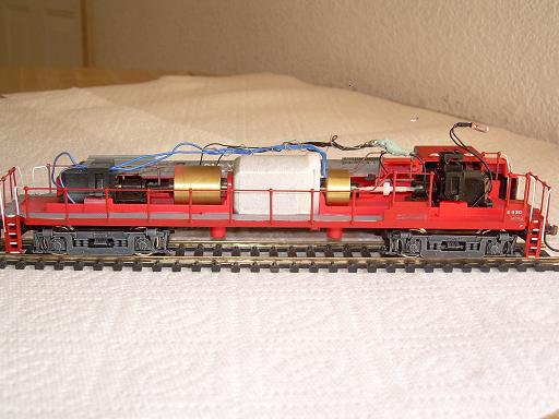

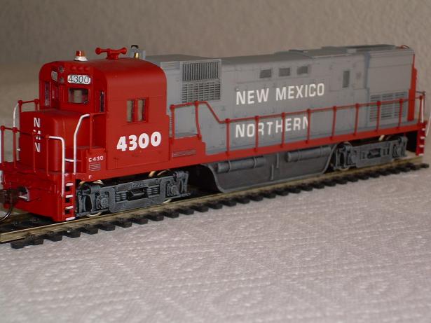

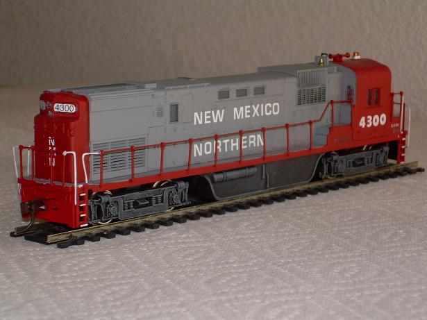

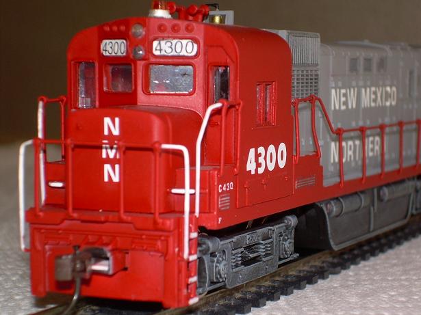

Here are some photos Of An IHC C430 that I rebuilt. I stripped the original paint as the first step. All hand rails were replaced with bent brass wire and Athearn stantions. I sanded off the molded grabs and replaced them with brass wire as well. The truck mounted couplers were cut off and body mounted knuckle couplers were added. I also filled in the piolet with sheet plastic. I added the rotary beacon and brass bell to the roof.
There are 2 errors that I did not fix. The fuel tank looks nothing like the prototype. It may be possible to replace it with something better, but that was beyond the work I wanted to do. The second error is the missing DB resistor grid on the roof. I did not realize it was missing until I had applied the last coat of clear flat.
The only mechanical alteration was to add 2 flywheels.

WHat? It's not "4301"? BLASPHEMY!!!
J/K. GREAT work as always!
How did you drybrush the trucks? They seem to have that "frosty" look that reminds me of, like, everything Mellow Mike ever does.
Agreed on that fuel tank. Where on earth did they get that from?
A great model nonetheless! [}:)] You do good work. Just add some MU hoses and the like, and she'd hide her pedigree even more.

#4301 IS in the planning stages. It's an IHC C430 that has been converted into a dummy unit. Not a Tyco, but still numbered 4301.
I painted the truck flat black and drybrushed/scrubbed on medium grey. Nothing fancy, but it helps pick out the molded on details.
I'd like to add more small details, but my primary operators are 8 to 4 years old. Small details just don't take the punishment well.
