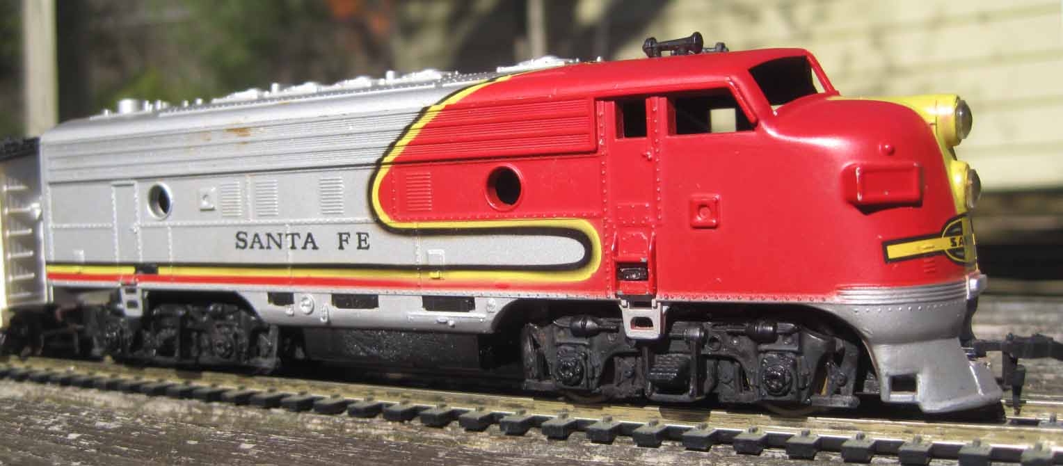

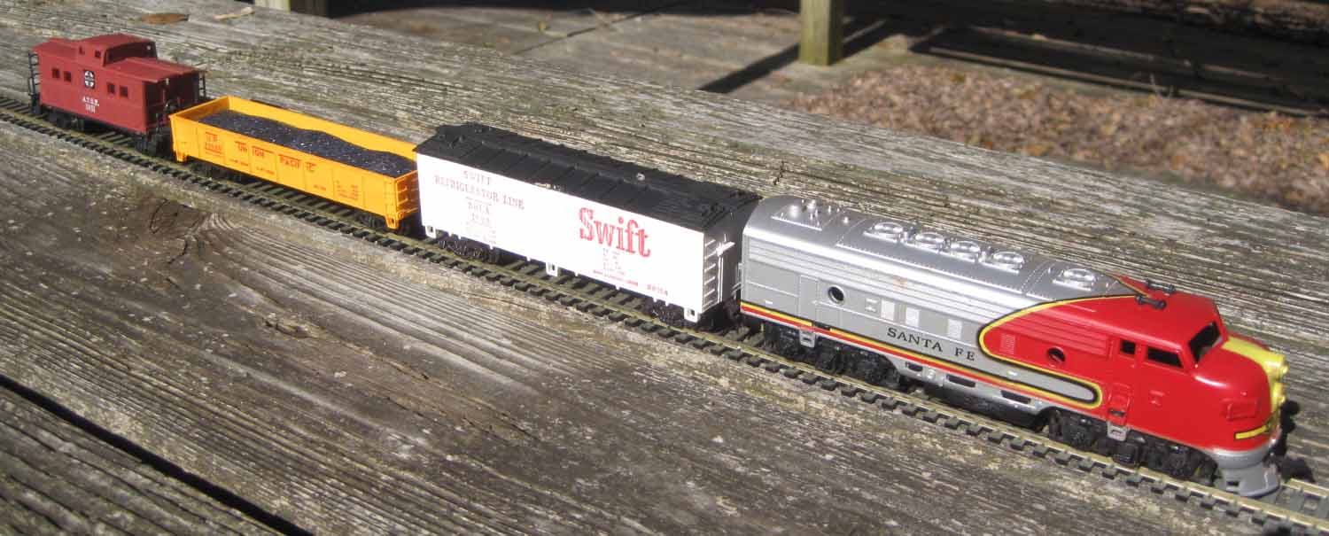

 Posted - November 14 2013 :  12:19:07 PM Link directly to this topic  Show Profile  Add JNXT 7707 to Buddylist
This came in a box of "stuff". No markings on anything except Made in Hong Kong. not 100% sure the Swift reefer, UP gondola and Santa Fe caboose went with the loco, just assuming they did.
Believe it or not the loco ran after cleaning the wheels and the commutator, but it will not pull anything, the wheels just spin. All the wheels on the rear truck are traction tires, look more like O-rings.

 Posted - November 14 2013 :  12:35:38 PM Link directly to this reply  Show Profile  Add rbturner to Buddylist
It appears to be Life-Like to me.
Randy
 Posted - November 14 2013 :  1:12:12 PM Link directly to this reply  Show Profile  Click to see EM-1's MSN Messenger address  Send EM-1 a Yahoo! Message  Add EM-1 to Buddylist
What exactly do you mean, "The wheels just spin"????? The loco isn't heavy enough to get traction to pull or, the wheels aren't touching the rails, or something more?
It looks to be a Model Power unit, BUT that difficult to call on due to not being able to see the underside of the frame as that will tell who made the unit......
The cars, are definitely, Life-Like products....

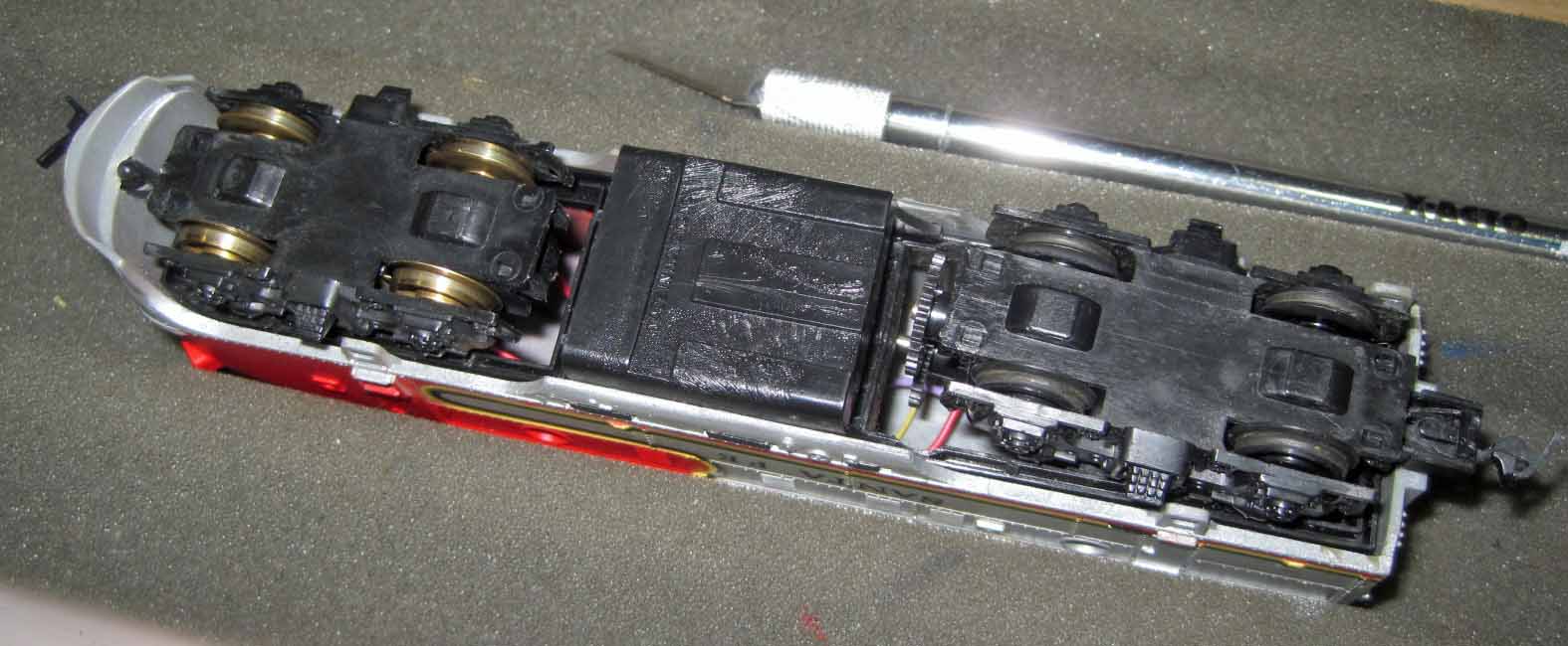

 Posted - December 04 2013 :  8:09:19 PM Link directly to this reply  Show Profile  Add JNXT 7707 to Buddylist
a cheep, no real cheep train set engine. The kind that when in falls over even if it is not broken you throw it away, anyway.
Originally posted by toptrain - December 04 2013 :  7:22:03 PM
Well, the Life-Like F9 at the top of the page - yes I would agree with you. But this is a red box Tyco F9 that I would love to get running again.
Edit: speaking of which, my DOA Tyco F9 is alive I am so pumped. Tonight I drilled out the rivets on the bottom plate, took the truck apart, soaked everything in alcohol, cleaned and lubed it....and then, what to do? I was thinking I could tap for 2-56 screws but the holes were too big Fortunately (never throw anything away) I had a couple of long screws in my mixed hardware box that were JUST long enough to get a solid bite into a pair of nylon nuts. crazy setup but you would have thought it was made that way. BUT...the moment of truth - I set the loose trucks (still wired together) on the track, said a prayer and HUZZAH....those things took off like they owned the place. WOW. Never had a Tyco MU2 before, and you all were right, it's got to be a bulletproof motor...and very smooth too. Of course I have yet to give it a good solid run session until I but the trucks back into the shell, but I'm thinking it should do OK.

 Posted - December 05 2013 :  09:58:32 AM Link directly to this reply  Show Profile  Add rbturner to Buddylist
Hey Jerry, glad to hear that she is running. When I drill the rivets out I tap the holes for both the top and bottom for #3-48 threads. Then I use about a 1/4" screw from each side. This way, later on, you can just remove the bottom plate without having to pull the whole truck out. And I seem to have one heck of a time with the engines that came with the long screws and spring holding the truck in.
The #3-48 screw is also the size that Atlas used for the snap switches so it is handy to have that size of tap around just so that you can use up some of those Atlas screws that I seem to have a million of.
Good old Atlas; everyone else standardized on #2-56 screws so they went with #3's.
