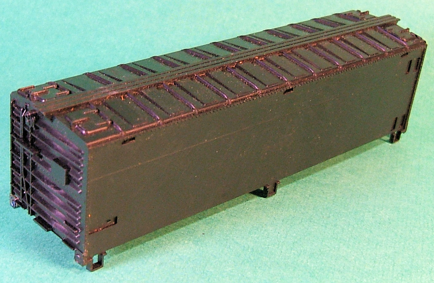

I posted this car a while ago, wondering what it was. I found out that it was a plastic Mantua body which was
designed to have metal sides. I decided to do something with it.

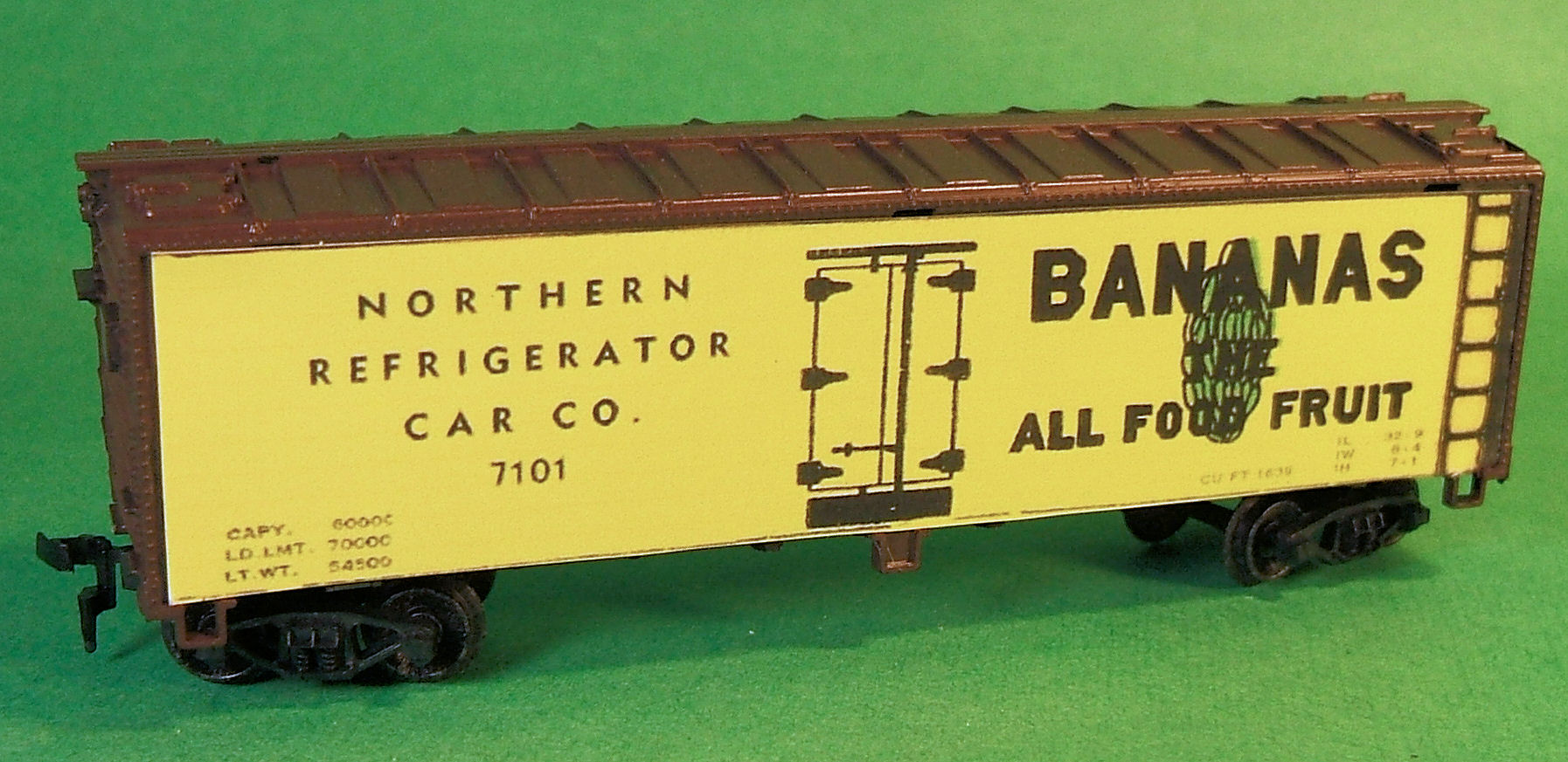

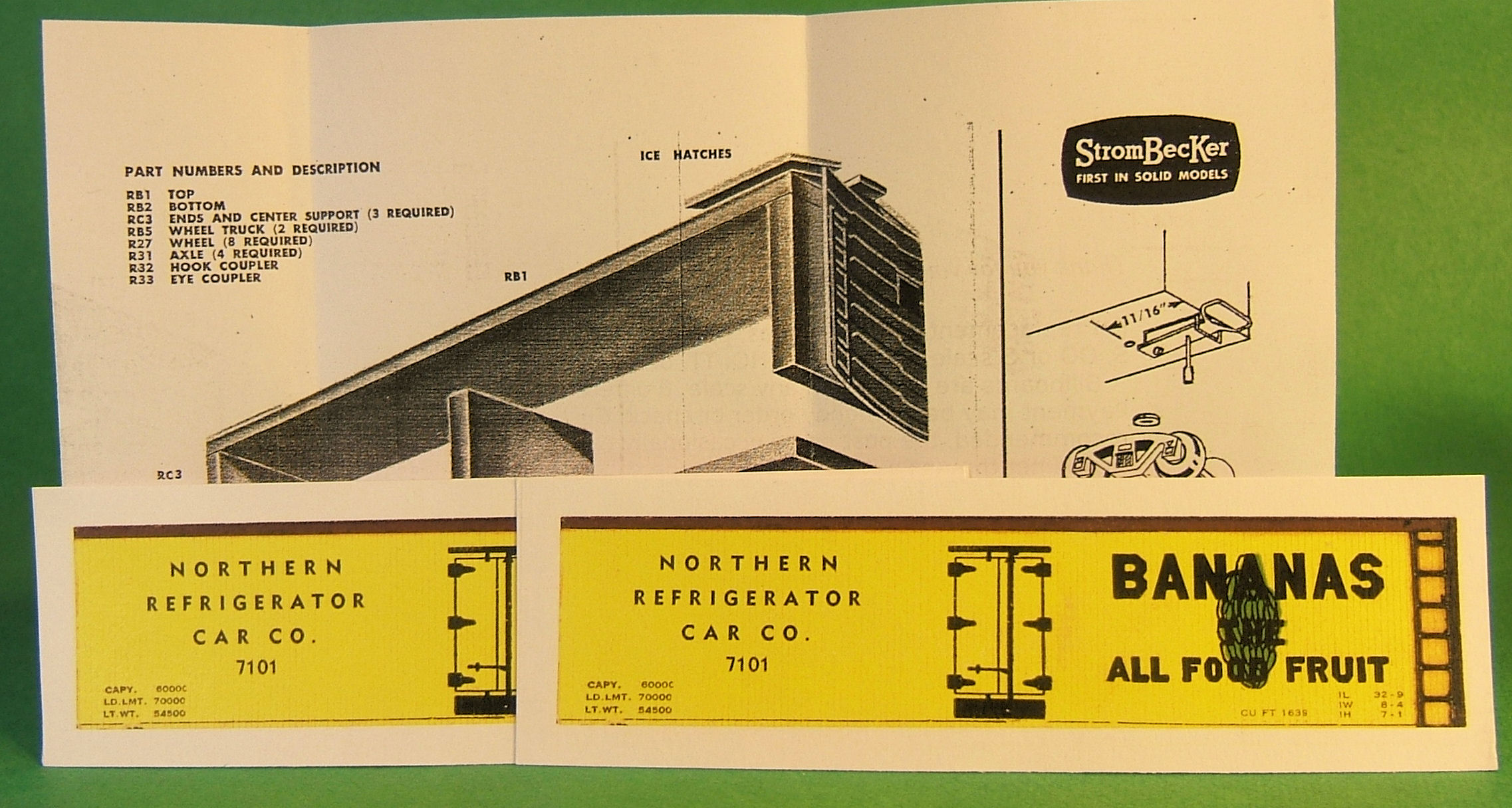

I got printed card sides from a guy who sells them on EBay. There were a couple of choices but I chose the “Bananas” sides
because they struck my fancy.
Of course the sides weren’t designed for the Mantua body and were about ¼ inch too long. I scanned the sides into my PC and used Paint Shop Pro to make them the right size for the Mantua shell. I printed them out on card with my ink jet printer. It took a couple of tries because it always seems the printed image isn’t exactly what the program says it will be.
Because it’s ink jet, I was worried about messing them up when I glued them to the car side. I gave both sides (front and back) a light coat of clear lacquer (Krylon from Wally World). I painted the shell brown because I thought it would look better with the yellow sides than the original black. I glued the sides on to the painted shell with contact cement.
I didn’t have a floor for the car, but a found an AHM floor (with trucks) in the scrap box. I was a little wide so I trimmed down the sides. I stuck the floor on with Elmer’s Glue. It will hold, but if some day I come up with an extra Mantua floor, it will pop right off.
