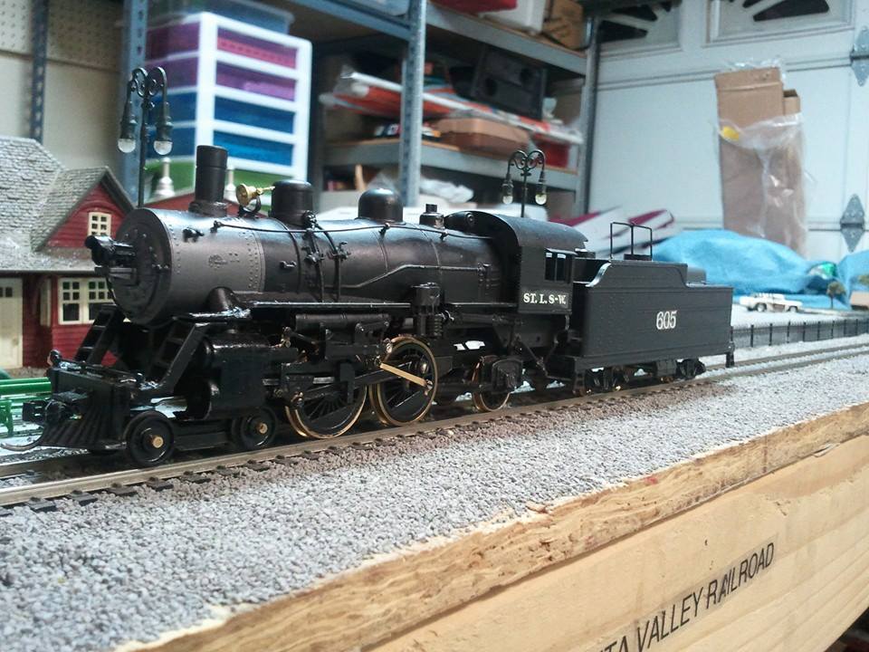

Desperately searching for someone who has an original brass rear driver to the MDC-Roundhouse 4-4-2 Atlantic. Anyone got one somewhere in a parts bin you want to sell?

If I wanted to get crazy I could without a doubt find, or make a driver similar to the one I need. And many tried to push me in that direction, but I want it to be an original Roundhouse driver that replaces the bad one. If it takes me weeks or months then so be it, just as long as I'm sticking to my plan. I don't want to take any chances, i.e. giving myself more headaches trying to get some other non roundhouse driver to work well with it. A lot of head scratching, headaches, and frustration can be avoided by me just finding a Roundhouse 4-4-2 driver.

Is the problem with the existing driver that its screw hole is stripped out? That can be an easy fix sometimes.

I've seen that driver on ebay. It's the front, geared wheel. I'm looking for the non geared, and or rear driver. Thanks though!
The problem with my rear wheel is the crankpin, in which the rods rotate on and the eccentric crank is screwed down to managed to somehow break off. I tried about 7 or 8 times to replace the crankpin but all proved unsuccessful. Rather then irritate myself trying to continue a cheap repair, I want something long term that will more likely be the permanent fix.

 Posted - November 11 2013 :  4:26:55 PM Link directly to this reply  Show Profile  Add NickelPlate759 to Buddylist
Hyde, I've drilled out broken side rod screws before, and it's easier than you think. If it's brass, it's soft enough to drill through pretty easily with a pin vise and a jeweler's loupe for magnification. Oil helps the process. Once I got it drilled out enough I could pull the remnants of the screw out of the threads. I always thought I'd have to fill & re-tap, but there was enough of the threads left in spite of the drill for a new screw to grab with no problem.

I think many of us are not understanding quite the problem. The long crankpin that sticks out of the driver, broke. Meaning a rod screw can no longer be screwed into the drive wheel.
I cut a metal crankpin off an old bachmann spectrum wheel I had laying around, zapped it to the wheel and kept doing adjustments trying to get it to work but the force that was put on the crankpin was too much which caused it to break after each test.
The picture shown aboveis just to show the drivers looks so y'all toocan look through your parts bind.

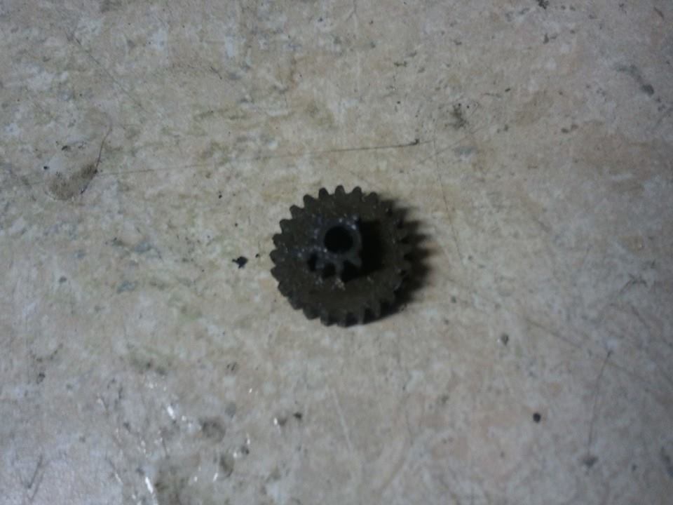

Well Randy I haven't touched it since January. It is almost fully put back together.
I had got your driver under the frame and all hooked up after installing the new timing rod, new expansion link, repairing the union link as well as replacing all the rod pins and screws but when it finally came time for test runs she wouldn't turn over much. Turns out the idler gear was mangled to death from years of use. So that ended her reign as top priority. The motor wire was also giving me fixes so I took it out and will make a new one soon as someone offers me up an idler gear for sale. All the new and repaired valve gear rolls perfectly so completion is not very far off it all just depends on the idler gear.

North West Short line (NWSL) makes gear sets for the MDC locomotives, They are pricey ans you may have to call to find the right set, But they are there.
