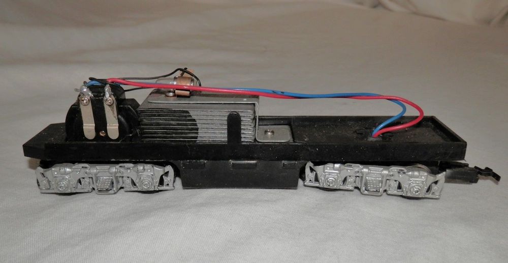

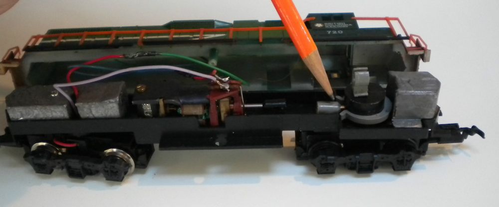

 Posted - November 05 2013 :  9:33:05 PM Link directly to this reply  Show Profile  Add Redwoods to Buddylist
The older Life-Like engines that I'm familiar with had either a truck mounted pancake motor, truck-mounted open frame motor, or a gear tower on one end with an open frame motor on the other.
Here are a couple of pics. I couldn't find my LL with the truck-mounted open frame motor, but I'll post it here if I manage to find it.
-Thomas
Adams
 Posted - November 05 2013 :  9:40:33 PM Link directly to this reply  Show Profile  Add Adams to Buddylist
Thanks, Thomas, for the pics. I'll let you know what I find when it arrives. Don't know if they upgraded anything before they got serious with the 'Proto' lines.
lvrr325
 Posted - November 06 2013 :  06:54:27 AM Link directly to this reply  Show Profile  Add lvrr325 to Buddylist
That grey socket on the gear drive I find frequently has cracked resulting in a unit which runs, but will not move as the socket/cup piece just slips on the shaft.
