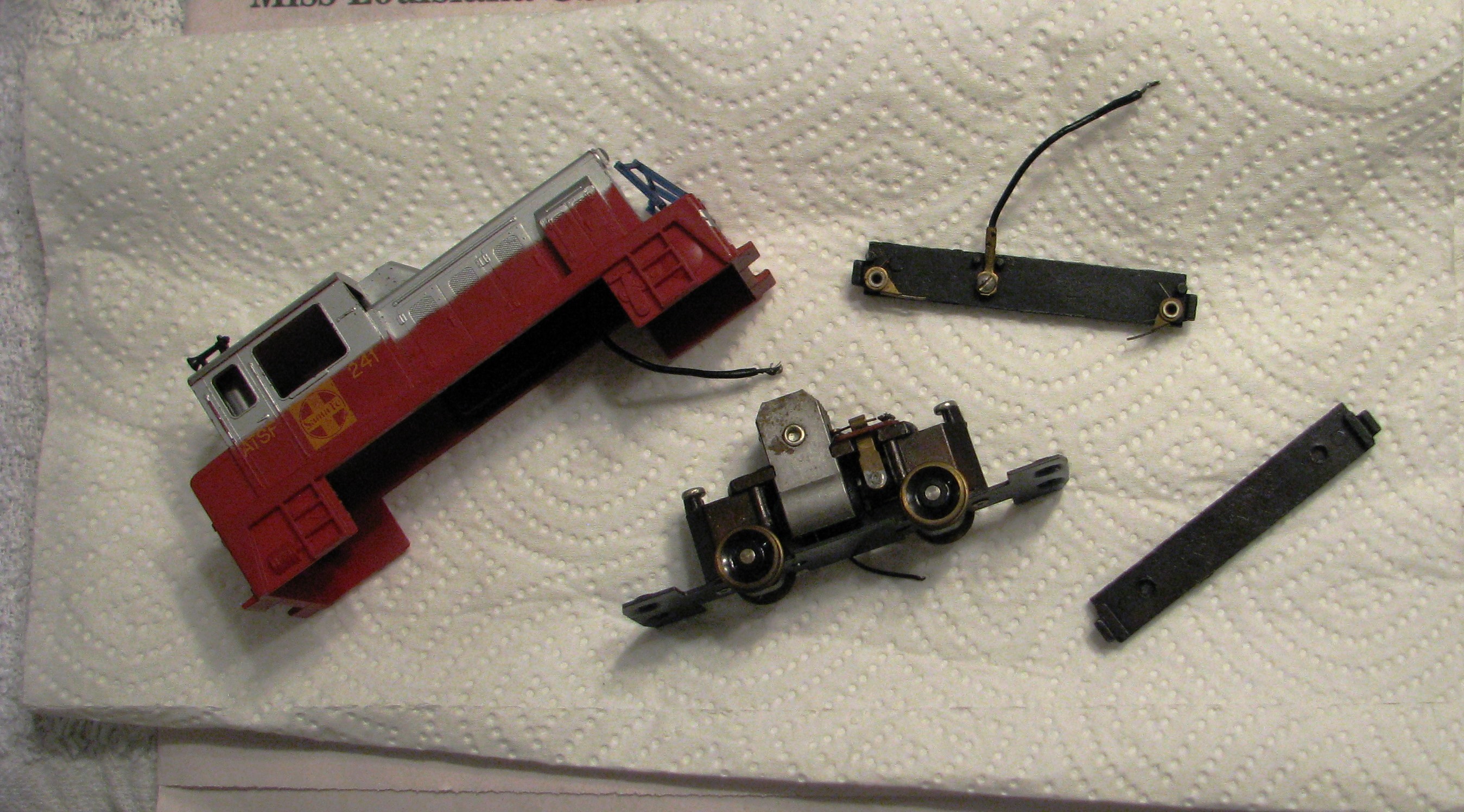

At a small train show today. I picked up this Tyco engine for free when I bought an Athearn GP35. The tag read parts engine - does not run. I brought it home, cleaned off the wheels and this engine runs great. The plastic wheels on the motor are not any good. The bottom plate that holds the wheels on are riveted so I don't know how to replace them. Also looking for the two wheel sets with the gear on the axle for the motor section. Any help
I was also given this one that said parts only but got home and it does run. I don't know how this one goes together. Any help would be appreciated.

You can pop the sideframe off on the side with the plastic wheels and pull them off the axle. Swap them for the plastic wheels from a junker, even from a Powertorque dummy truck, which are very common. You'll need to glue the sideframe back on, though.
As for the Plymouth switcher, I think it's missing 2 diecast weights for the front and rear. It's built basically like their other industrial switcher.

Mostly likely when you put the Tyco SF Industrial Switcher back together it is not going to run.... Why... because at the end of each sie frame there is a small insulator box. These are impossible to find if they are missing. I make mine from Paper Spackle Tape. I cut out the paper to fit into the slots where the side frame goes.
