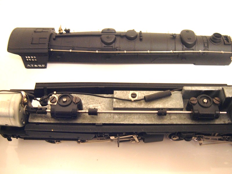

Which kit are you considering? The kits where you make the dogbones with lengths of 2mm shaft can be quite useful, like in the Y6b repower I did some years ago.
The universal sockets are quite small, though, so I don't use them for diesels where you need a deeper socket in order for the trucks to swivel. They have a set with a 1/4" socket and an adjustable dogbone that's better suited for them.

Nice clean work on that set up Nelson, hows that motor run that articulated?

 Posted - October 03 2013 :  12:30:06 PM Link directly to this reply  Show Profile  Add NickelPlate759 to Buddylist
John, it powers the Y6 just fine, but I also installed gear reduction kits (33% reduction), so I don't know if it would have enough torque with the original gearing.
