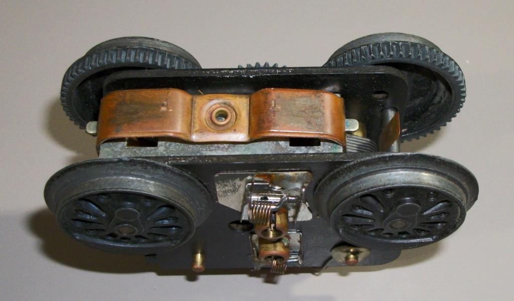

Hi All,
I am hopeing some of you could help me with a Marx O scale engine motor.
I just recieved this set. I tried to run it and it would not move. I checked the brass plate on the bottom and you can see in the picture that it is very dirty, so i cleaned part of it to do a direct wire check. It made a very very small attempt to move. I checked the brushes and they are good.
I see that the part of the motor that the brushes make contact with is VERY dirty. You can see this in the bottom picture center hole.
Is there a way to clean this without taking the motor apart? Soaking it maybe?
Does anyone see any obvious other problems?
Thanks for your help.
Mytyco

Make sure the commutator is clean. I myself own and run Marx 0-27. Rather cheap and like the Model T of 3 rail 0. Hard to beat beast!

Darn, that engine looks TOO clean otherwise! What I would do is see if Radio Shack has any electrical contact spray cleaner, you could spray that right on the armature, it won't harm the wires or varnish coatings on them, supposedly. They used to sell it, not sure if they still do. But with the motor that nice ( not rusted up , very little gunky showing except on the armature copper plates ), I'd just spray the contact cleaner inside on it, and then try it. I'll bet someone over-oiled it, and it got on the plates and gummed up. That way, with spray, you wouldn't have to take it apart.

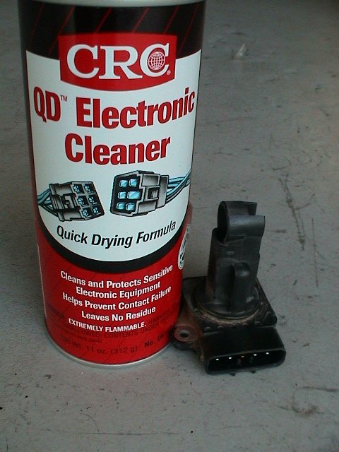

To add to Jerry's comment, I use CRC electrical contact cleaner on Tyco / Mantua MU motors. It works well. I picked up a can at the local Auto Zone for a few bucks.

That commutator NEEDS to be cleaned, and all the graphite powder needs to be cleaned out from the grooves inbetween the commutator plates. Use a small flathead screwdriver or knife blade to get the graphite powder between the commutator plates clean, and then insert a q-tip with 90% (or similar) isopropryl alcohol into that access hole and spin the commuator. Repeat until the commutator is a nice shiny copper color. Then give the motor a lube job (armature bearings and gears) and test her out.

[quote]SOME TYPES OF CRC CAN DAMAGE PLASTIC. So be careful of the type and how you use it.
Regards John. *********
Good thought John, the cleaner I use is specifically for electrical connections and connectors. I have not had any issues using it, I do remove the motor from the shelll first, I use the same cleaner on some of the plastic connections ands connectors on my car without any issues.

I'll check the can and see what the exact name is, will post later today. Here it is.........

A good spray of some sort of electrical cleaner, SOAK it..... let it drip out. then allow it to "dry" and then submerge the whole works in Alcohol to get deep inside. 91 % or higher if can be had.....Allow to soak for 24 hours.. and remove, allow to drip dry on a cloth.....Once dry.....take a empty spray bottle like that's used for cleaning glass windows.....fill with CLEAN alcohol, and spray it while it is suspended, to see if anything drips out of it....allow that to dry.....
THEN when this is done, the part of the motor between the 2 brushes that have springs pushing against them, add alittle grease on this, that's the Armature shaft and needs re-lubrication, and then on the other side of the motor, look for this same part, and add one [I]SMALL[/] drop of oil.....THEN this side is where all the gears are, add in some grease on these, BUT add sparingly.....DON'T over lubricate....And test again, hope this solves the issue!

Thanks for the picture and name of the electrical cleaner, That helps very much.

mytyco, I would NOT soak the whole unit. I don't know why anyone would, (except perhaps that they don't know the individual components of the motor, and so decide to soak everything). The fibre board could get damaged, and the soaking may not play nice with the insulating coating on the wires of the armature and field coil. It's going to take scrubbing, not dunking, to remove the built-up gunk on the commutator, and all the gunk between the commutator plates. Smokie's suggestion about the pencil eraser would also work.
Without power, set the motor on the track, push down gently, and see if you can get it to roll along the track. If it does, (and it likely will), the problem is not "gunked up lube". The problem is poor electrical contact. Again, clean the commutator.
I have a Marx diesel locomotive with a very similar motor block that was having similar problems. I cleaned it the way I described, and it runs smoothly, even with a burnt out armature winding (which will be replaced at some point).

I have not picked up the cleaner yet, but I did manage to clean out some of the gunk on the commutator. Also the brass piece on the bottom was not mounted correctly, so I fixed that as well.
She is now able to run on her own with no help from me.
It is a neat little diesel switcher I had not seen before, until a couple of months ago in a video.
It will still get the full cleaning and lube in a week or so, but it's nice to know she does work.
