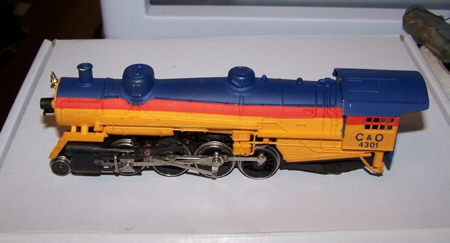

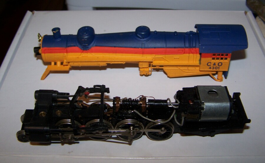

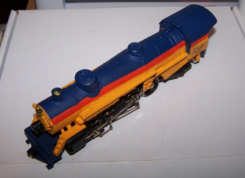

I got this Chessie steam shell from a train buddy out of his junk box a few years ago, but he had no running gear for it. I am assuming it's a Tyco, the 4301 number would seem to indicate that? Anyway, while rummaging for steam parts for EM-1 last night , I pulled out some 2-8-2 chassis's, and while photographing them, I decided to try one to see if it would fit. It's a perfect fit, my notes indicated they may be Mehano chassis's. The back tabs fit into the cab area slots, and the front mounting hole lines up perfectly. So, did Tyco borrow some parts from Mehano or AHM ? I thought TYco's Chessie steamer was a 4-6-2, yet this 2-8-2 chassis is a perfect fit. I think I will have to keep them now. :) I need a boiler weight to fit inside the Tyco? shell, and a tender , but otherwise it looks like it'll work fine as a 2-8-2 configuration. I'm stoked!

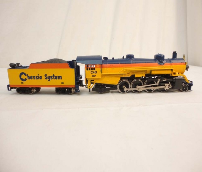

Well, while scoping out the Internet today to find Chessie steam photos, I ran across the goldmine I'll post here. Looks like my steam engine shell was made by AHM, in BOTH 4-6-2 Pacific, and 2-8-2 Mikado. That 4301 number threw me off, as that is almost exclusively used by Tyco, so I was sure it was that version. Nope. Here's the pics to prove the AHM heritage.
Most of the Chessie steam versions I've seen are the 4-6-2, until I found this photo proving the 2-8-2's existence , I wasn't sure it was real. But it most definitely is, and I most definitely have a chassis ( actually, 3 ) that fit the shell, and I got the parts off one of the others, the trailing truck, to make it complete now. Just need some screws, the boiler weight, and not sure if there's a standoff between the boiler and chassis, but now it's just minor stuff to find to get it going finally. I really like this shell ( and the road name, even if the paint scheme IS fictional ), so I want to be able to run it eventually.

Hey Tyco did have a Chessie System steamer BUT it was a 4-6-2 Pacific *WANTS!*
http://www.ho-scaletrains.net/steamengines/id8.html
Looks like to me it IS numbered 4301 too

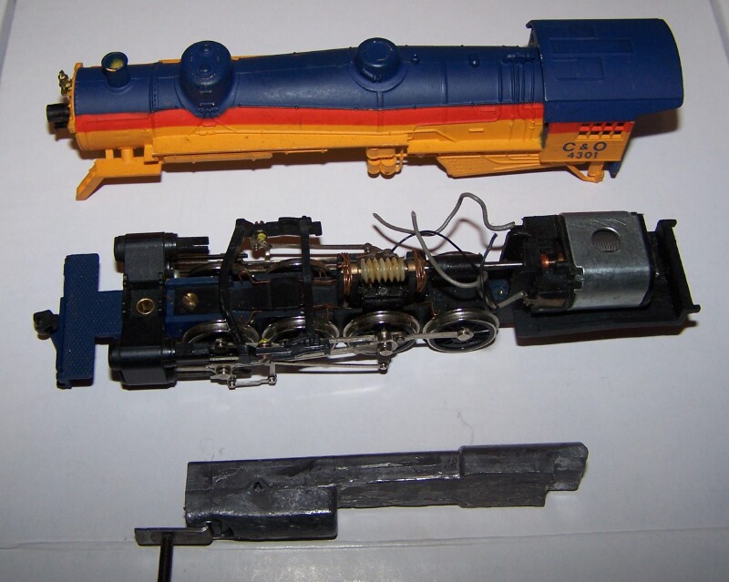

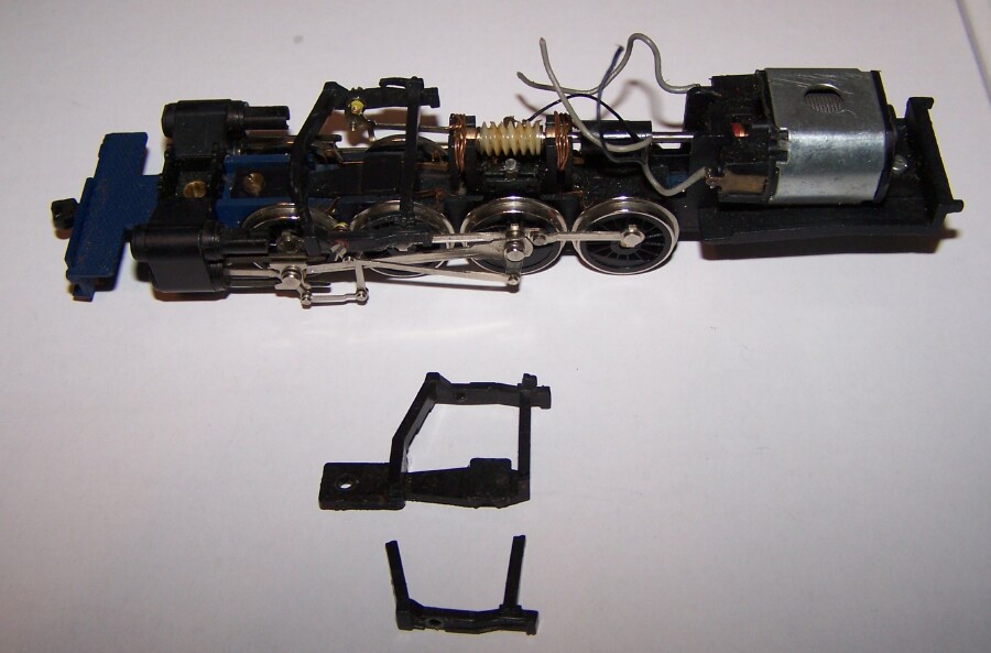

Well, i got the weight for the Tyco 917 in the mail at work today, and was eager to try it out. Once work was done, fire up the HHR and head for home! I started work on the engine about 10 PM, and was done in about 40 minutes. The frame on the blue Chessie chassis that attached the side rods was broken, so I had to take it off the chassis with the black front area I was gonna use, and put it on the blue front chassis. After sweating over removing the loc-tited screws, they came out of both units with no fuss. I swapped the parts, and then the tricky contact arms under the frame had to be JUST right. Got them in, then locked down the unbroken frame, then reattached the side rods. WHEW! My first side-rod surgery! Ok, maybe second, but this one was more complicated than the little Joe Docksider job. LOL!
Anyway, once that was done, I installed the new Tyco weight ( it fits perfectly ), locked the front down, then managed to find the rear screw on the 3rd broken chassis. I had to cut the wires to the motor to transfer it, and got a grain of wheat bulb that came with the weight, so I need to solder in the light, and the motor, and then it should be ready to run again!
I noticed that the front steam chests are riveted in, and that the blue front walk has black steam chest tanks, and is factory riveted, so this one didn't come with blue steam chests, it seems. No matter, the unit is about complete, and soon should be plying it's model trade on the rails again. Now if EM-1 can find me a tender to go with it, I'll be REAL happy!

Looking good Jerry! I tell ya, those valve gear hangers are brittle on most of them and doesn't take much to snap one, that screw that holds it in place, don't over tighten it, as that's the first part of the whole works to snap that hanger.....
