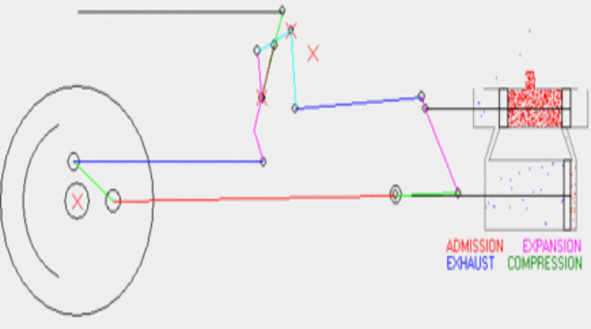

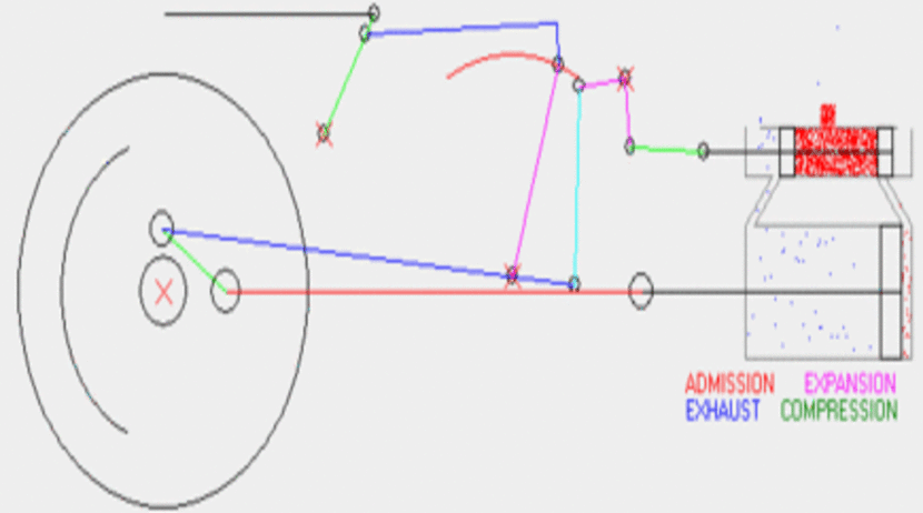

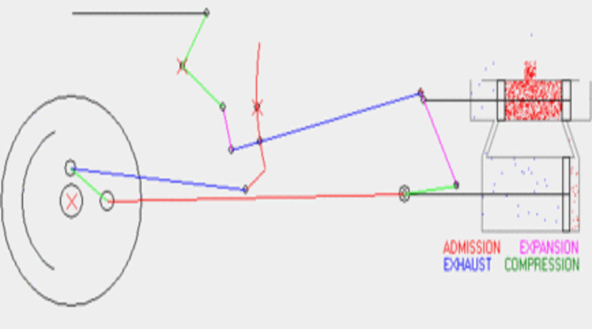

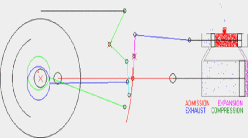

 Posted - August 11 2013 :  11:00:36 PM Link directly to this reply  Show Profile  Click to see EM-1's MSN Messenger address  Send EM-1 a Yahoo! Message  Add EM-1 to Buddylist
Guys, boy I got a load on this one....
Mantua? ALL the ecentric crank that were EVER used are interchangable....ON ONLY the locomotives that HAD full working valve gear from the factory.....Those that had no valve gear? Will not work!!! Why? The "Ecentric rod" length is different, and the amount of travel of the crosshead and yoke for this linkage, which goes through the Expansion rod, to the "Radius Rod", the Radius rod length is crucial, just as much as the Ecentric Rod!
See, The Crosshead, has "Crosshead Arm" that leads to a short rod, "Union Link" that comes off it, then leads to yet another rod, the "Combination Lever", to connect to another rod that goes into the valve cylinder, Valve Stem (top of the main cylinder) that functions the cylinder and has forward and reverse motion. Being said that, the radius rod has different lengths depending on the distance the whole rod prier to it, moves while in motion. See, the reason this is crucial, is one the 4-6-2, the rods have to span the cylinder in such a way that the rear most pilot truck is BEHIND the cylinder, and the cylinder is centered and has the main rod going to the CENTER driver.....On the 0-6-0, its shorter, as the cylinder chest is closer the front driver and the main rod goes to the REAR driver......See?
IF your following along, this is the change in the driver distance, which changes the rod length. On the 2-8-2 The Main rod connects to the 3rd driver from the front, this yet again, changes the Union Rod AND Radius Rod length and you can't interchange a 4-6-2 set of valve gear, from Mantua to a 2-8-2 Mantua, due to this rod length differance! There simply will be to much "play" in the rod movement and will jam up the linkages, OR the rods are to short, and it will lock up the movements.....These distances have to be taken seriously even on a model for it to move freely and without any restraint of the movement, in either direction!
The shortest rod, that connects to the MAIN driver is the ecentric rod, this rod has no length differance, where the rod that connects to it, does!
Below is the Mantua type valve gear, in motion....Which would be Walschaerts Valve Gear:
The following valve gear would be better suited for a steam switcher, which would be Bakers Valve Gear:
On the Bakers Valve gear, it be easier to get the distance right as its not as crucial, as what they at the Mantua factory, used!!!!!
Edited by - EM-1 on August 11 2013 11:06:06 PM

 Posted - August 12 2013 :  02:14:40 AM Link directly to this reply  Show Profile  Click to see EM-1's MSN Messenger address  Send EM-1 a Yahoo! Message  Add EM-1 to Buddylist
Barry,
I got a few more, in a little bit larger in size.....
See here:
Walschaert Valve Gear:
Baker Valve Gear:
Southern Valve Gear:
Stephanson Valve Gear: Used in Shays...."VERTICALLY"

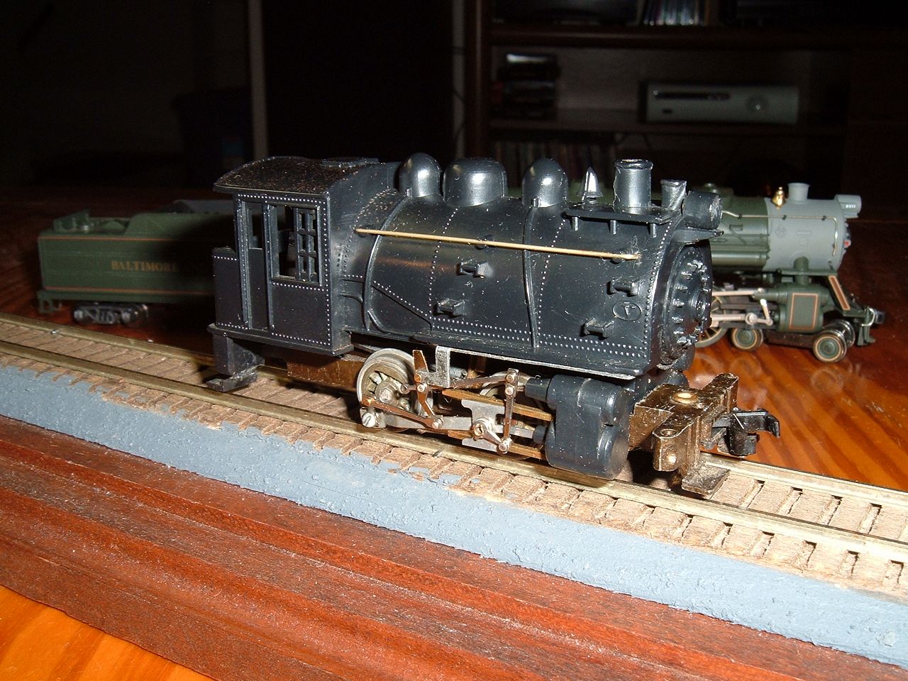

 Posted - August 14 2013 :  01:59:48 AM Link directly to this reply  Show Profile  Add NickelPlate759 to Buddylist
Didn't Varney have a full valve gear kit for their 0-4-0T Dockside switcher loco one time?
Originally posted by microbusss - August 12 2013 :  9:07:02 PM
Yup. I was lucky enough to get this one with full gear for a decent price in Allentown. It needed several rivets replaced, so I guess the original owner was a little overzealous in crimping them. It runs very smoothly now.
Others I've seen have the yoke as well.
 Posted - August 14 2013 :  02:17:22 AM Link directly to this reply  Show Profile  Click to see EM-1's MSN Messenger address  Send EM-1 a Yahoo! Message  Add EM-1 to Buddylist
Nelson,
That's a nice looking little B&O you got there!
I got a bunch of the Rivarossi ones.....the complete, working ones, run pretty good now that I re-motored them.....One tho, has a really good running original motor in it, that's not noisey.... which got me and I have run the ever-loving crap out of the little thing....Still it hums a little but its a coffee grinder like the others were!
The only thing on that plastic Varney is the shell, I'm not sure I could handle the handrailing as-is on it!!!!!I'd have to add more "stanchions" to have it look right, you know?
