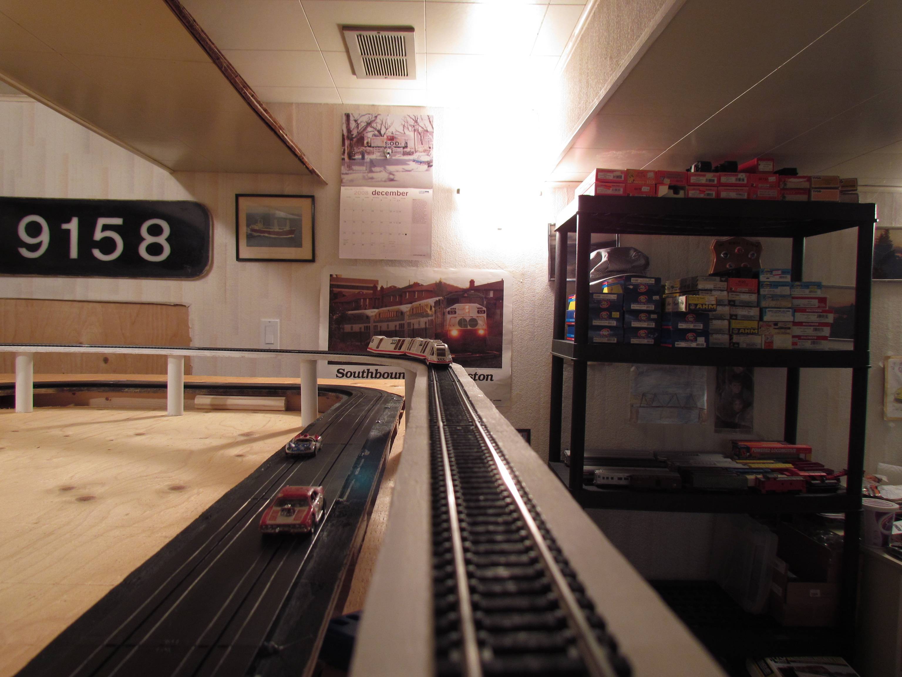

Today I completed all the wood work for the basic layout structure. The raised sections along the back and sides will be mountains/cliffs. The lower portion in the center of the track will be a lake (hence the name of the layout). The lower section at the front is probably going to be terrain of some kind, I haven't decided yet.
Next up on the to-do list is get the Turbo Train track painted and mounted. It will essentially be an elevated railway which circles the layout, overlapping the slotcar track. I'm a little worried about how much the railway will obstruct the drivers' view of the raceway, but I think it will be ok. The initial plan is to have a "pie on a stick" building in the center of the lake which will be serviced by the train. That's still a ways off though.
Here's the plywood base that will support the railway:

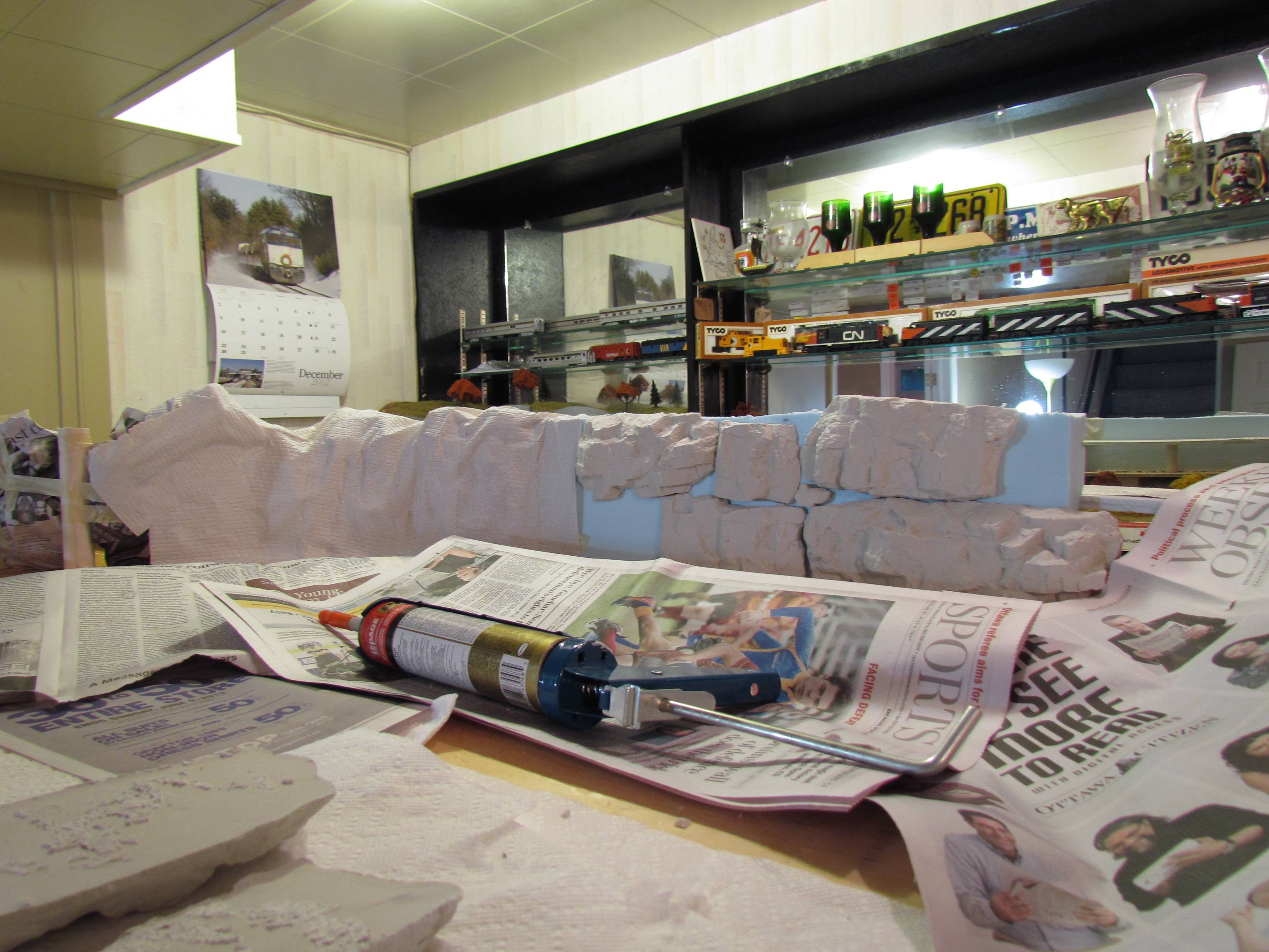

 Posted - September 02 2013 :  5:43:48 PM Link directly to this reply  Show Profile  Click to see DaCheez's MSN Messenger address  Add DaCheez to Buddylist
After several weeks of casting rock faces I finally have enough to get started on constructing the actual cliffs. Durabond turned out to be an excellent product for casting rocks, the only downfall being that it needed about 6 hours in the mold to cure (Hydrocal and Plaster of Paris take under an hour). The finished results are rock solid though, and easy to work with.
I started building up the cliff base using foam insulation board for the straights, and newspaper covered in Plaster soaked paper towels for the curves.
The castings have been attached to the foam using construction adhesive. Once the adhesive is dry the cracks between the castings and on top of the cliff will be filled in with Plaster.
Here's a section I've already started filling the cracks in. It will most likely need several applications. Once everything is painted the hope is that the cliff face will look seamless.

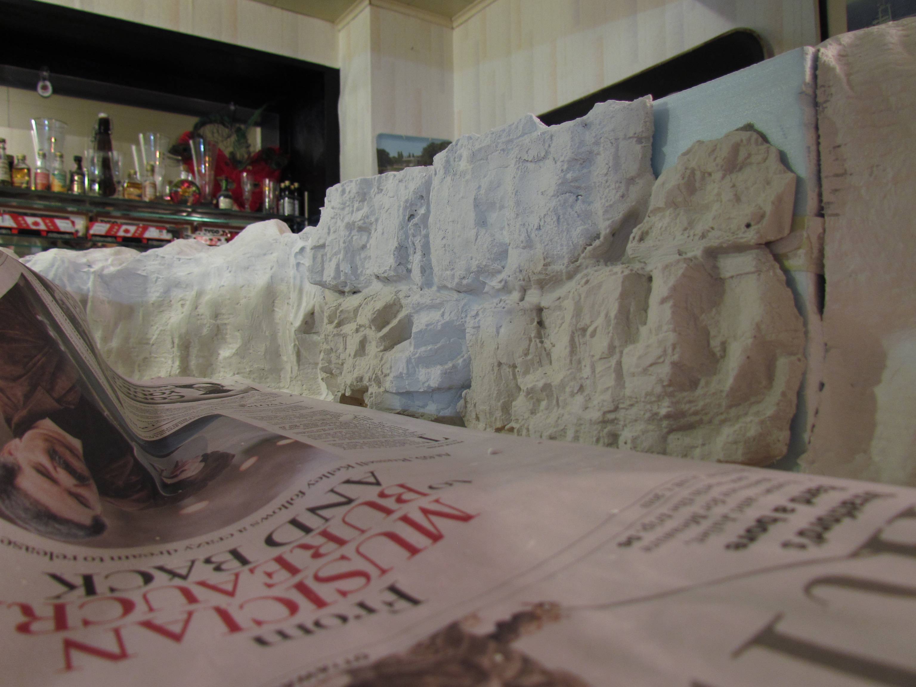

 Posted - September 06 2013 :  8:27:01 PM Link directly to this reply  Show Profile  Click to see DaCheez's MSN Messenger address  Add DaCheez to Buddylist
I pulled up the newspaper and masking tape tonight to have a look at everything. The cliffs aren't finished yet (not even close), but I wanted to make sure the rock faces gave the cars enough clearance, check the track for any plaster/water seepage, vacuum the loose bits of plaster up...and of course run some cars! So far so good!
Here are a few more pics...

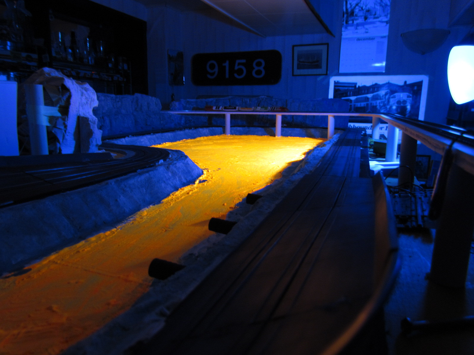

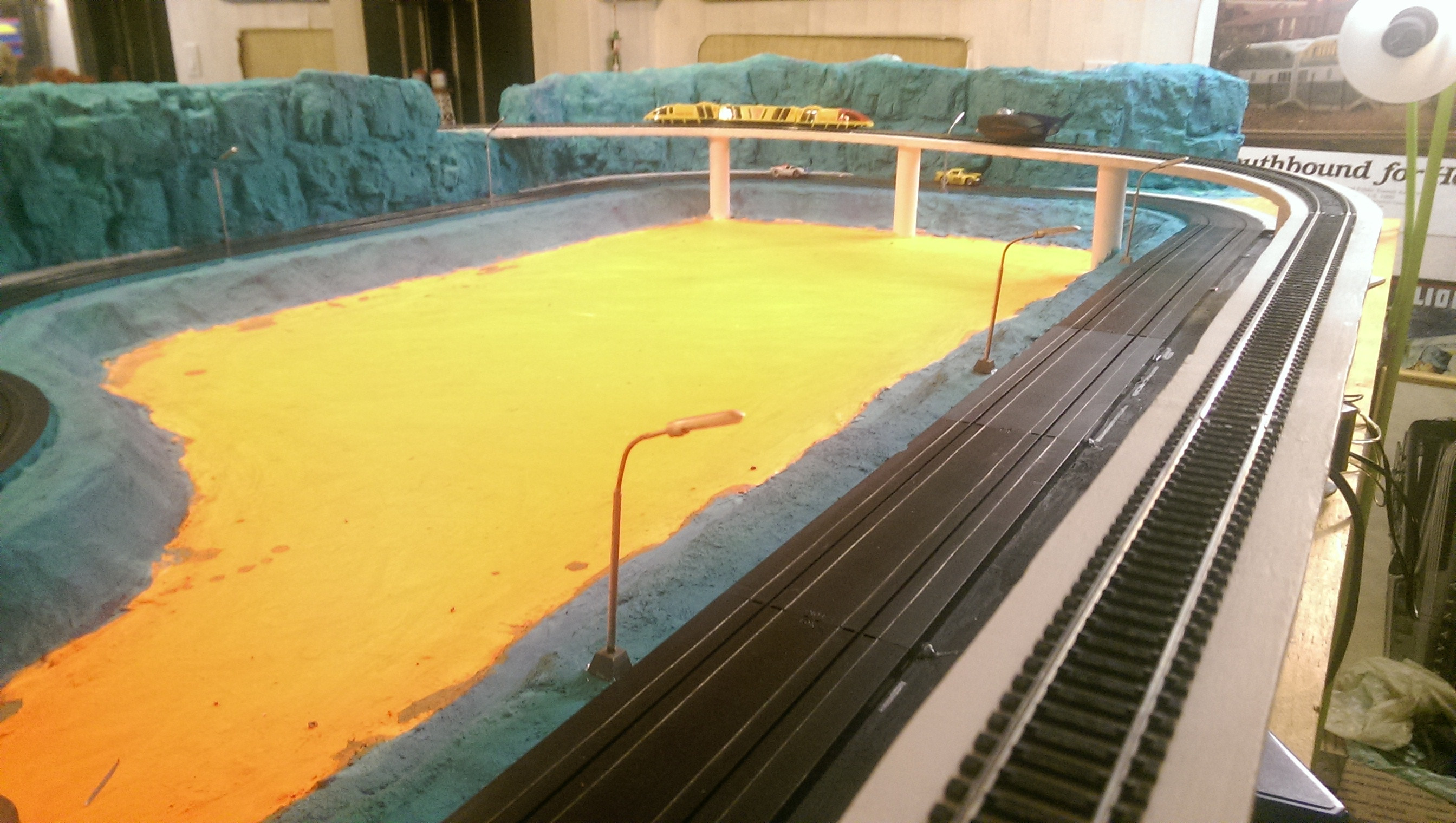

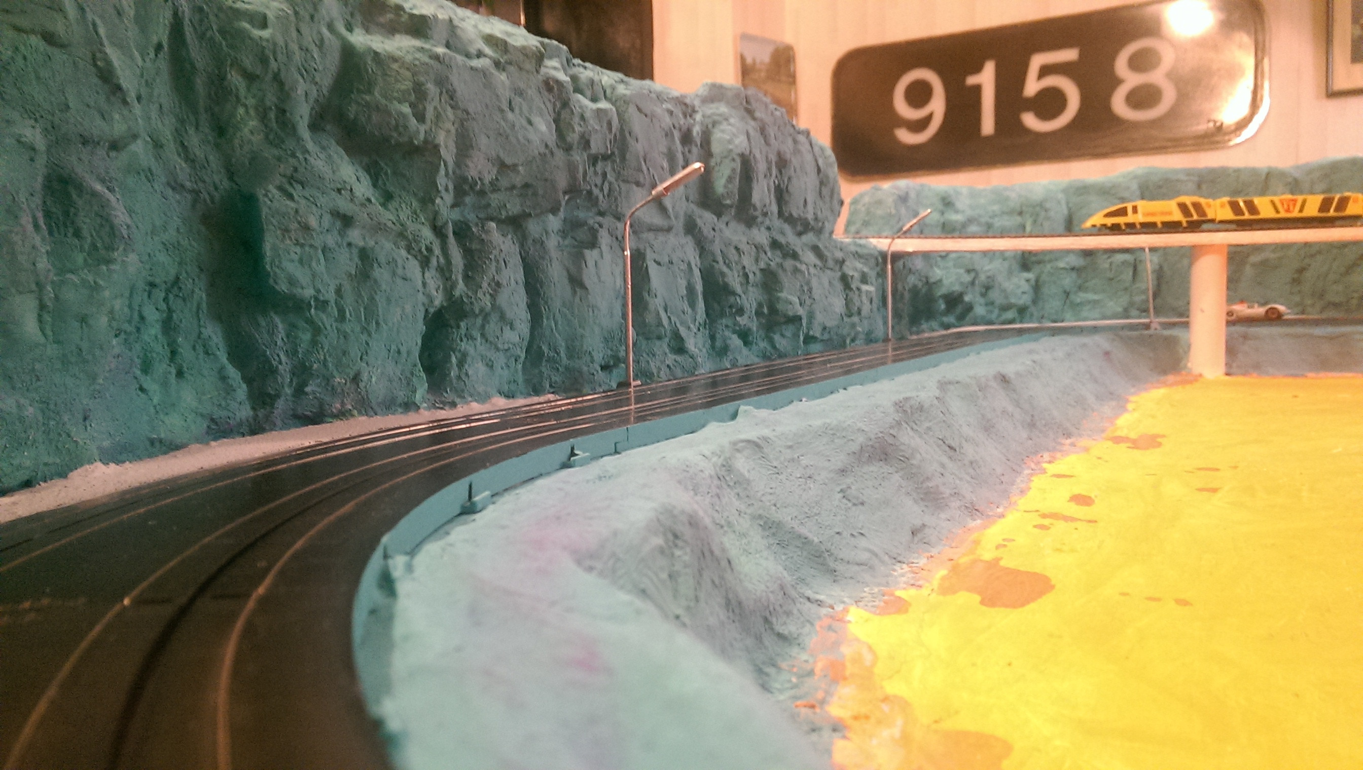

 Posted - January 05 2014 :  3:05:53 PM Link directly to this reply  Show Profile  Click to see DaCheez's MSN Messenger address  Add DaCheez to Buddylist
It's been a few months since I posted any progress. Plaster work is not the most exciting thing to work on and I'm a huge procrastinator. Anyway, the terrain is finally starting to take shape and I'll hopefully be on to some painting in the near future...
Most of the rock moldings have been blended together and the embankments along the roads are finished. In its current state it's mostly just a matter of blending the rock with the plywood and covering up a few gaps.
I also added some cork aprons on a few of the corners. They still need to be smoothed and painted.
EDIT: Forgot to mention that the rock behind the banked curve has been scrapped. I'm hoping to put in some sort of concrete wall instead.

 Posted - January 05 2014 :  3:24:08 PM Link directly to this reply  Show Profile  Add walt to Buddylist
Lookin' good, Eric. I like the pic with the cars along the wall...

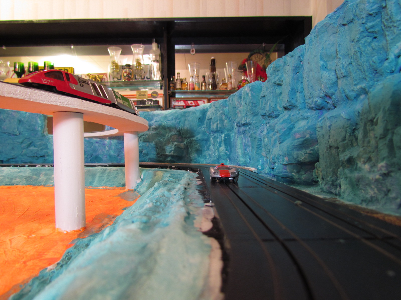

I started putting down the first coats/washes of paint today. The rocks are going to get green, purple, and black washes to make them a little more realistic (if I can even use that word ). The lake will get a few more orange coats followed by some water-based varnish. After that comes the smaller details (fences, signs, streetlights, a little bit of ground-cover, etc.). The wall behind the banked curve also needs to be done.
So that's how the colours look so far. I honestly can't decide if I love it or hate it at this stage. Once everything gets a little more detail I think it will look good. Any suggestions?
cheez
 Posted - January 21 2014 :  9:24:19 PM Link directly to this reply  Show Profile  Send zebrails a Yahoo! Message  Add zebrails to Buddylist
Suggestions? How 'bout a black & white photograph?
Lookin' great, DaCheez!
 Posted - January 21 2014 :  9:31:25 PM Link directly to this reply  Show Profile  Add scsshaggy to Buddylist
I used to have a co-worker who asked people what color the sky was in their world. He never asked about the lakes, though.
ChessieRR
BNSFAvatar
 Posted - January 21 2014 :  10:09:50 PM Link directly to this reply  Show Profile  Add ChessieRR to Buddylist
Cool! I like the colors. Is it a lava lake?
weekendrailroader
 Posted - January 21 2014 :  10:27:34 PM Link directly to this reply  Show Profile  Add weekendrailroader to Buddylist
Kinda reminds me of salt formations in the desert. I think that color might work really welll in a dark room with one or more blacklights being used to light up the scene. Add in some nite-glo pieces from Tyco, and you just might get a glowing layout that is feast for the eyes.
 Posted - January 23 2014 :  1:20:41 PM Link directly to this reply  Show Profile  Click to see DaCheez's MSN Messenger address  Add DaCheez to Buddylist
The lake is meant to be some sort of man-made reservoir containing radioactive water from an unseen industry. In the first two pictures you can see three large pipes that would dump the water into the lake. The water colour was a toss-up between fluorescent green and neon orange. I think the orange is a better contrast to the rocks.
weekendrailroader: I've been looking into different nighttime accents. So far I have some vintage Tyco streetlights and glow-in-the-dark paint. The blacklight idea is also a good one. I remembered after reading your comment that there is a blacklight in the floor lamp beside the layout.
As it turns out, the lake glows...

 Posted - June 04 2014 :  1:56:07 PM Link directly to this reply  Show Profile  Click to see DaCheez's MSN Messenger address  Add DaCheez to Buddylist
It's been a while since I posted anything here...life has been super busy the last few months (no complaints from me!). I've slowly been layering coats of paint on the rocks. Today I was finally able to get the streetlights installed!
Pictures of course...
cheez

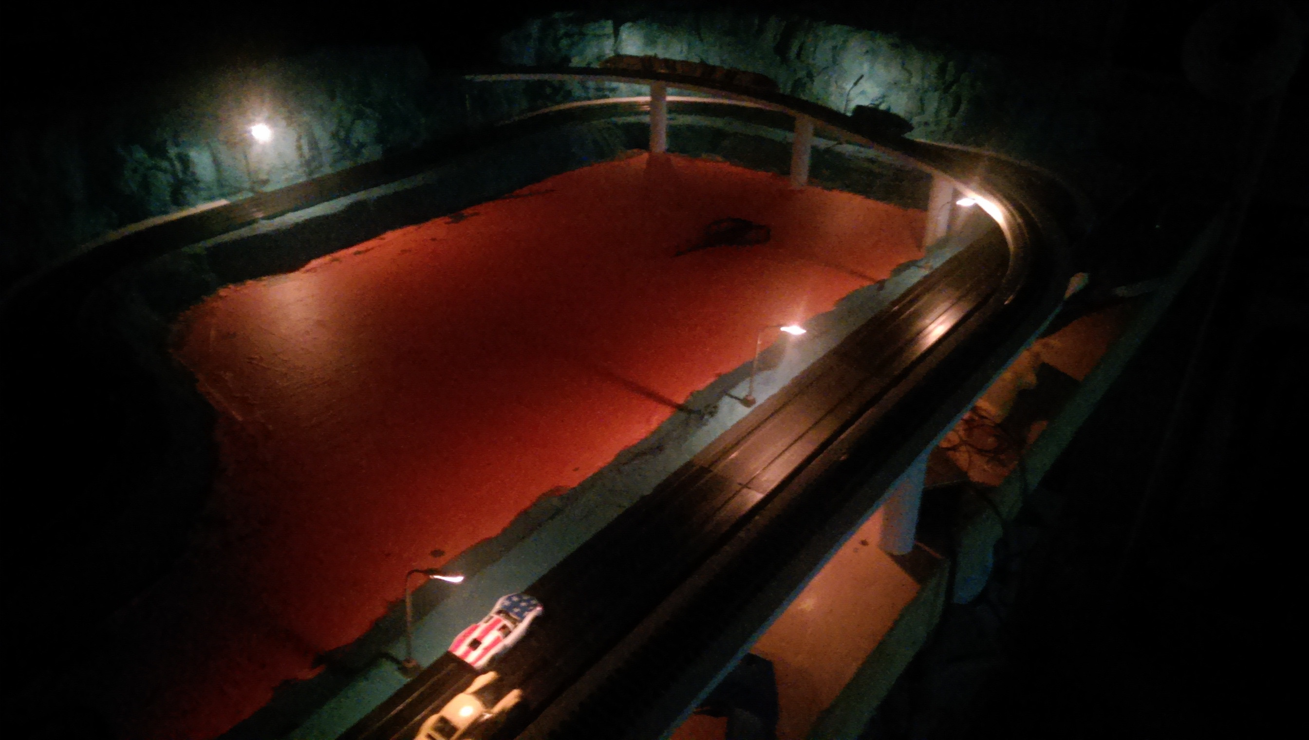

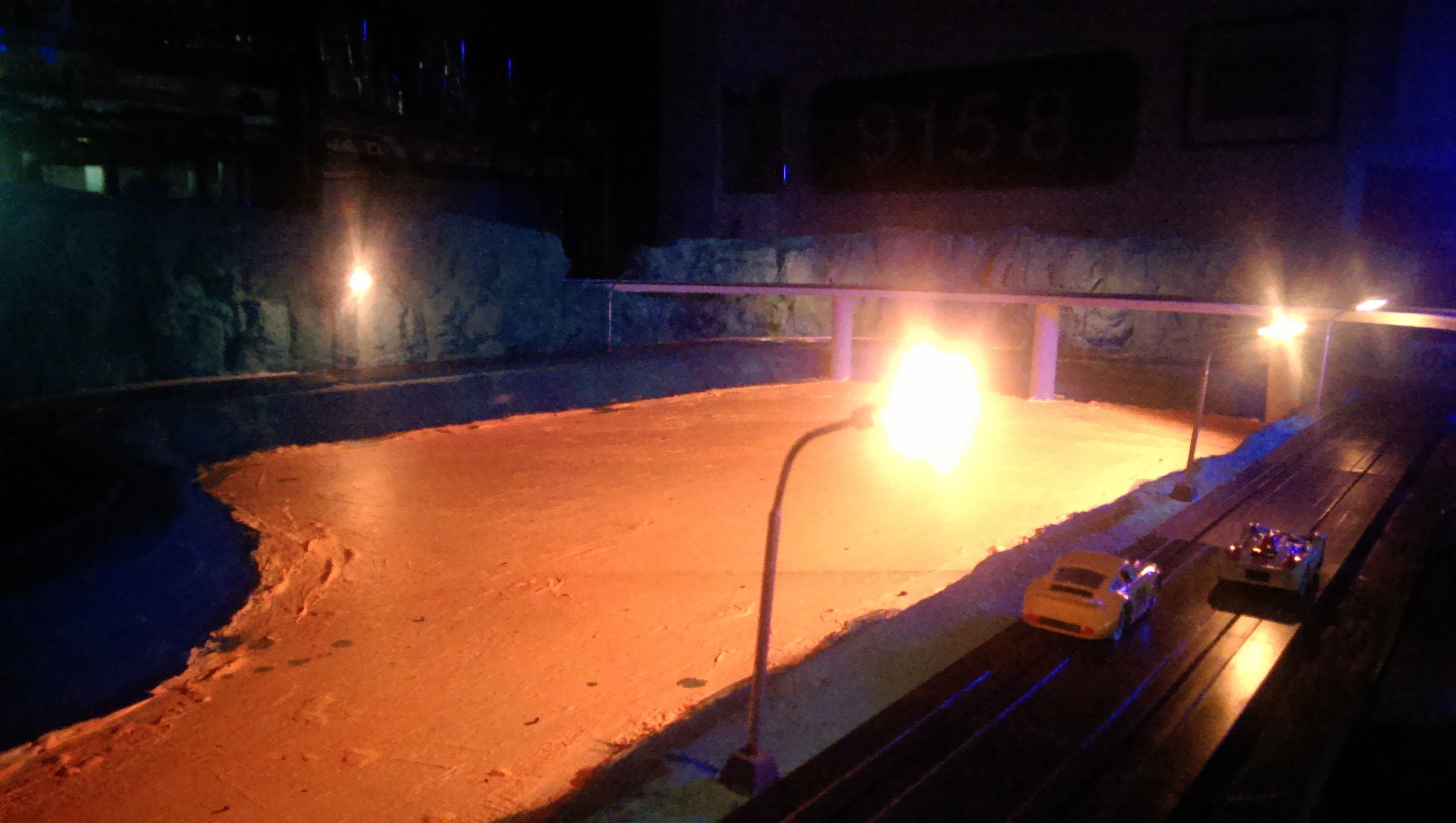

 Posted - June 04 2014 :  3:15:16 PM Link directly to this reply  Show Profile  Click to see DaCheez's MSN Messenger address  Add DaCheez to Buddylist
One more pic. The blacklight really brings the scene to life...
 Posted - June 04 2014 :  5:12:28 PM Link directly to this reply  Show Profile  Add JNXT 7707 to Buddylist
Wow............
I feel radioactive just looking at it....
 Posted - June 04 2014 :  6:40:41 PM Link directly to this reply  Show Profile  Add walt to Buddylist
Nice Eric ! The lights are a great addition! Nice! I now have 18 poles up. I have 78 more, not sure exactly how many I need for the 4 sections...
Walt
 Posted - June 04 2014 :  6:52:58 PM Link directly to this reply  Show Profile  Add NickelPlate759 to Buddylist
That's cool Cheez, very surreal. It looks like a course from Jeff Gordon's racing game from years ago.
