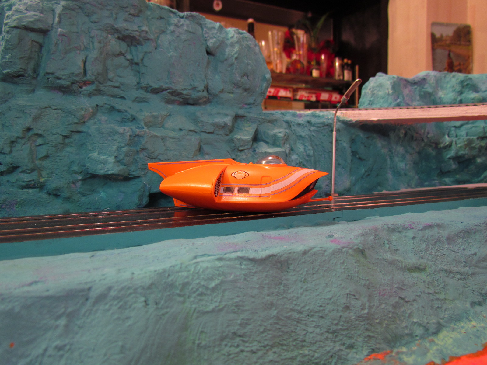

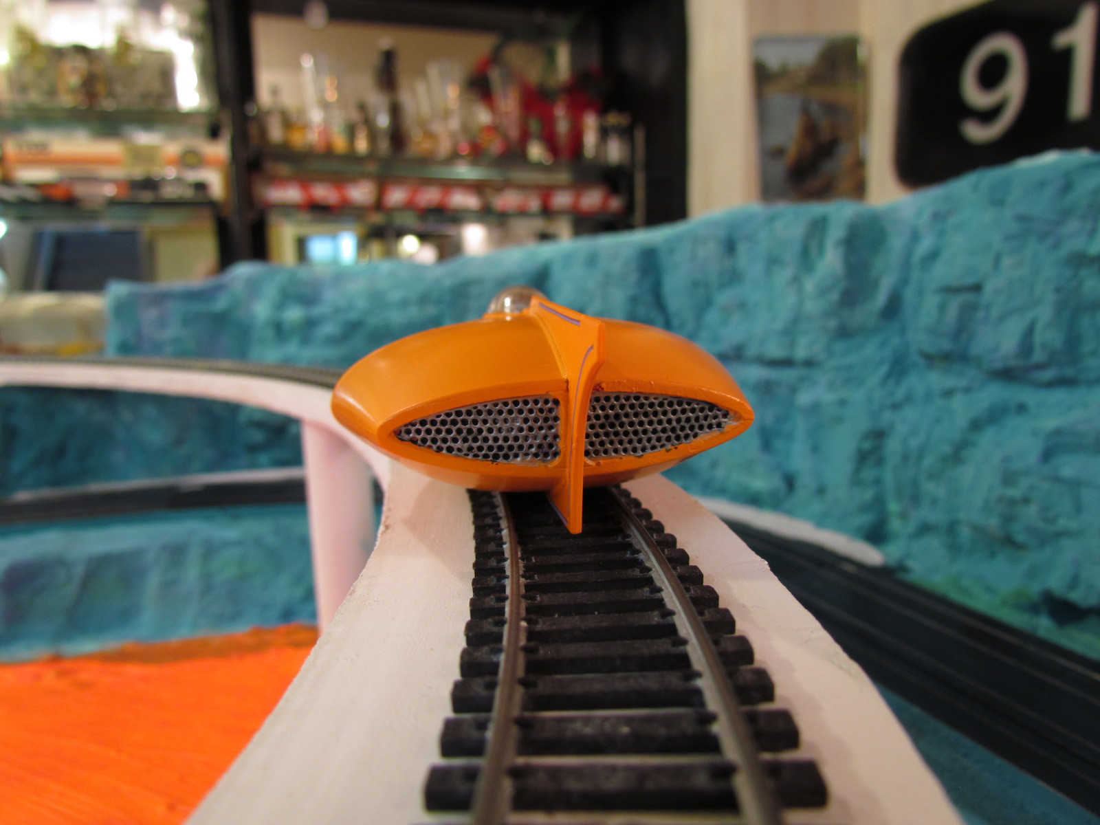

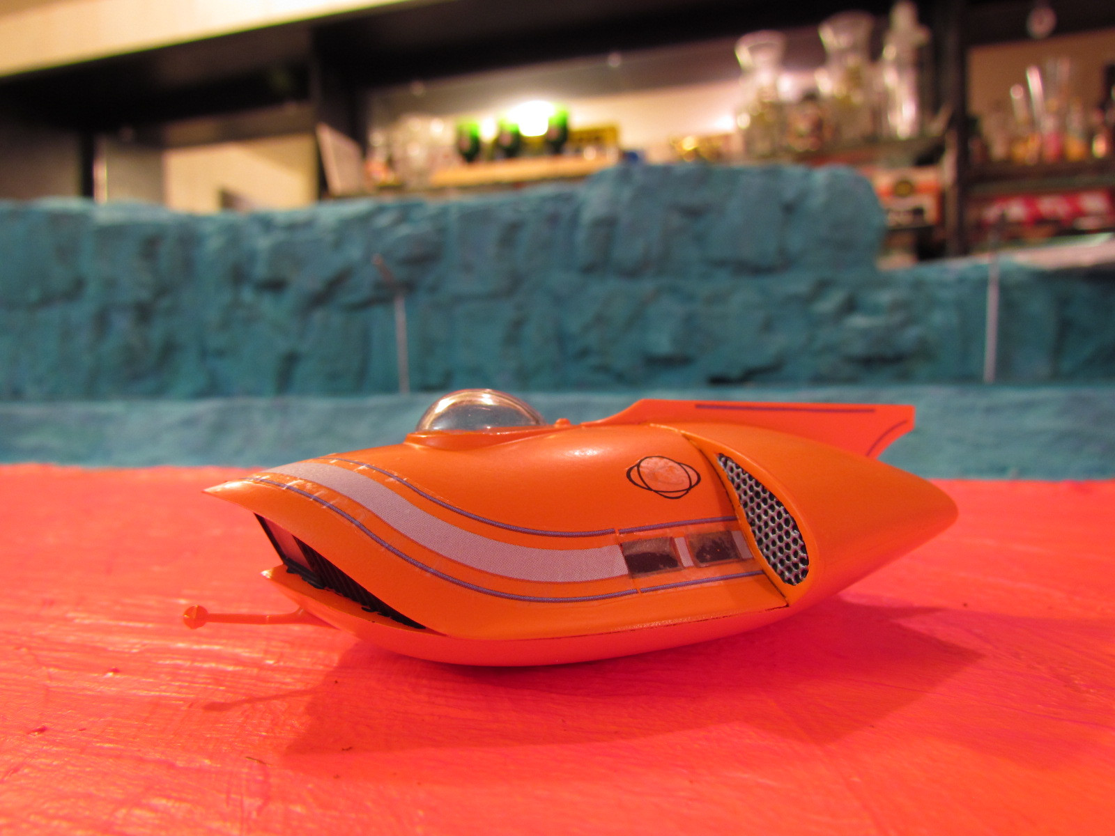

There hasn't been much progress on the layout lately other than a few more coats of orange paint being put on the lake. I did however finish the three spaceship models I bought several months back.
My most recent is the Spindrift model.

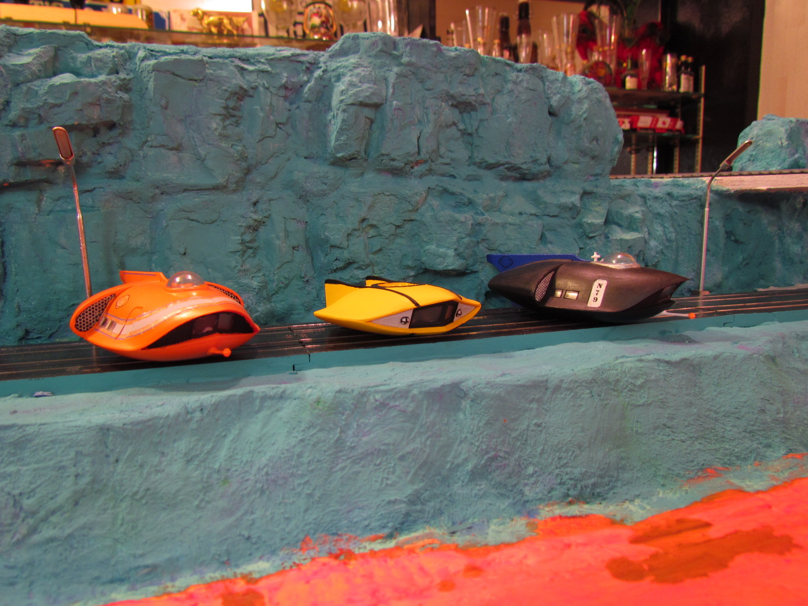

All three models together...
Two Spindrifts and a Flying Sub.

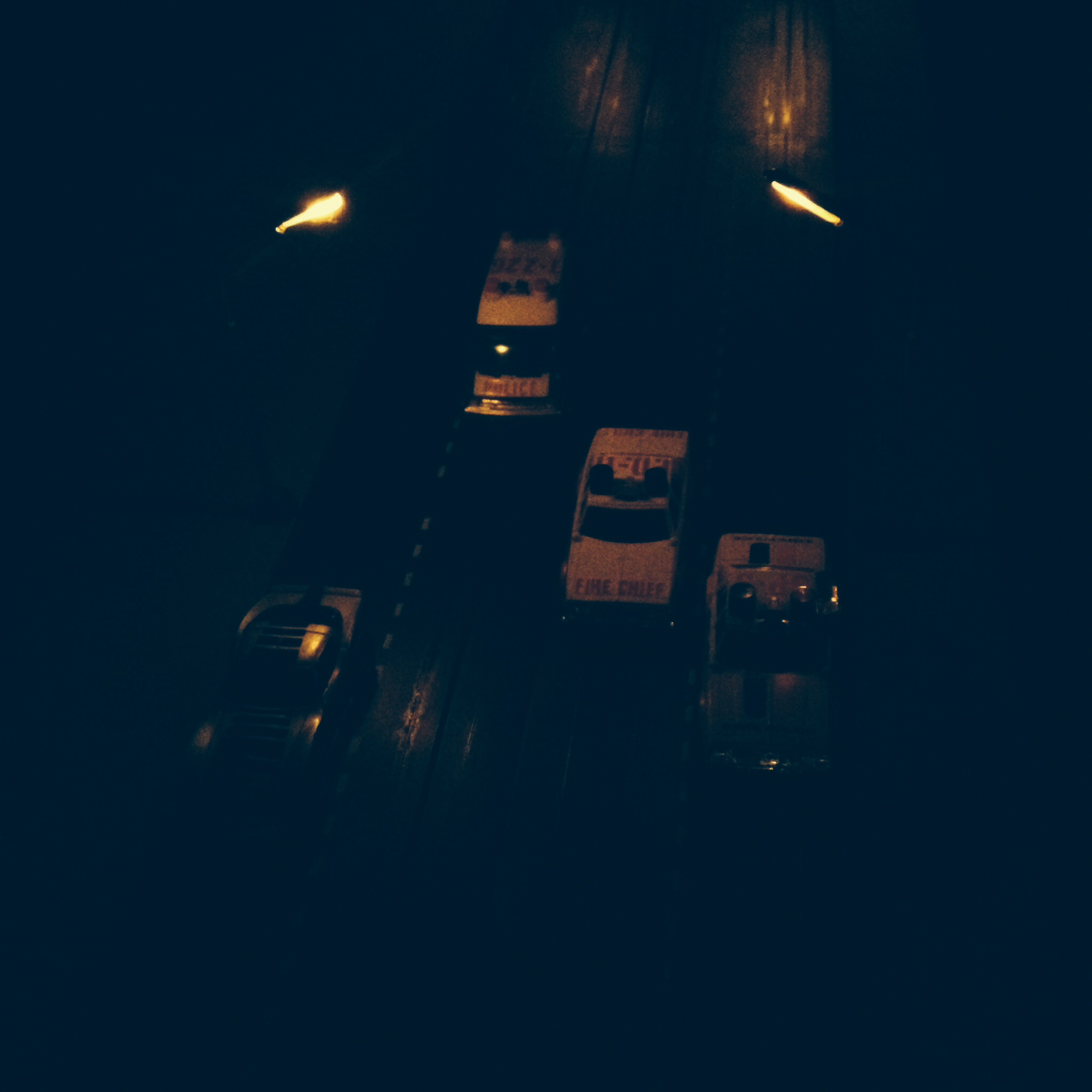

Today I wired a few more poles and have a total of 32 poles lit, using one Tyco train transformer on the A.C side for accessories. Today I found that the lights are giving a weak yellowish look. But after studying this after dark, I believe this look would be very realistic as real street pole lights are not really white bright. If you park your car under a street lamp, you can see the make of car, but may not be able to make out great details like certain or exact colors, etc.. The photo was taken tonight with the cars in view. I'm doing some thinking here.
To brighten the light poles, I can decided on cutting back on how many poles I light per transformer. Maybe 20 poles per transformer would look nicer than the 32, or 25... I will study, and deceide... I can cut the main power wires with ?? lights, then run another power wires/transformer to the next set of 20 , 25 or 32 poles.

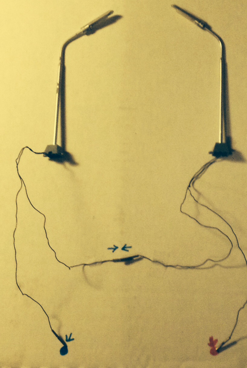

How I'm wiring; I bought 100 feet of 18 guage double strand wire. I started from the transformer with a 48 foot long piece that I run under the table, to power a section of the 4 lane. Before stapling the wire under the table, every 18 inches, I separated the wires and trimmed the plastic off. I staggered each cut so they are not beside the other to eliminate a short(s). This long red & blue wire is placed directly under the slot car track below the board. Tyco recommends to tie two light pole wires together, then run one wire from each to the power wires below (as pictured) This is how I'm doing the lights. I have been using just a little solder (using a quick heat soldering gun)to hold the connections...
UPDATE: After looking at earlier photos, I like the brighter lights better than the pic below.
Just come out of the basement and have decided on 16 light poles per transformer. Tomorrow I hope to wire the other 16 poles to the DC part of the same transformer. If this works without dimming the lights on AC, I will be able to operate 32 lights per transformer...
