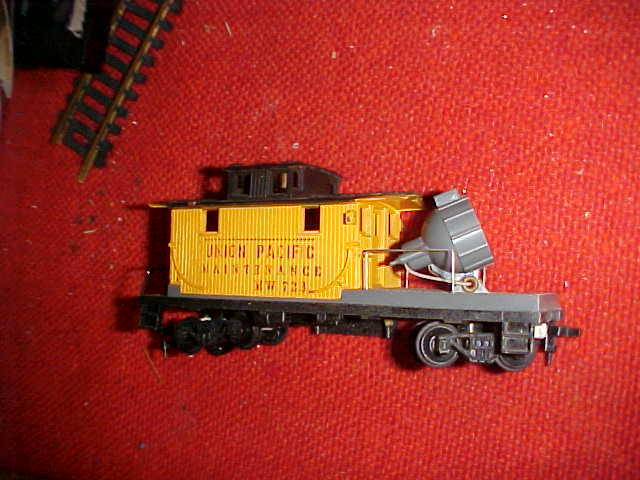

just picked it up it does not have brass wheels but it seems to have a battery clip in the cab
is that how its supposed to work

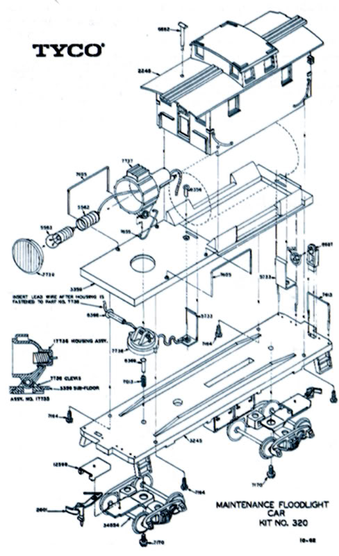

No, the old Reading, Pennsylvania, and Union Pacific search light cars are battery operated. If you put the battery in and it did not work then the light is broken. The other searchlight cars (Durango, Burlington, and Pennsylvania maintenance) as well as the lighted cabooses(Union Pacific, Santa Fe, and Pennsylvania) used the brass wheels to work. BTW, good catch on the Union Pacific, it is very hard to find and when they show up they are usually expensive.

Yeah thats the schematic I saw

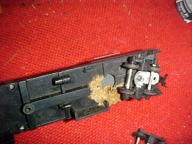

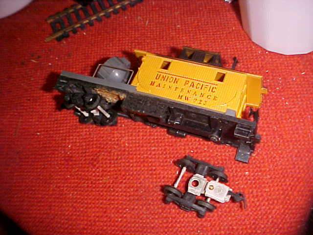

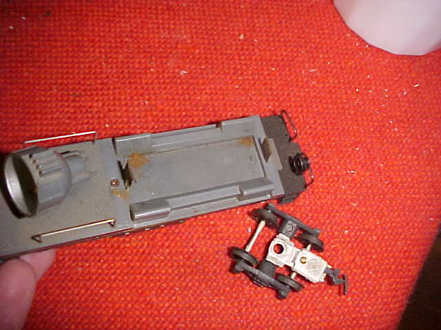

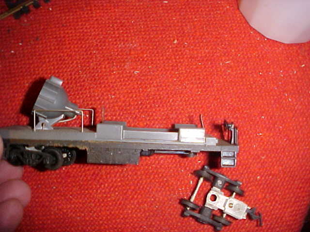

HERE ARE PICS THE ONLY DAMAGE IS ON BOTTOM
 Country: USA  ~  Posts: 1138  ~  Member Since: August 19 2011  ~  Last Visit: October 15 2026 Alert Moderator  Go To Top Of Page
 Posted - June 07 2013 :  9:23:47 PM Link directly to this reply  Show Profile  Add NickelPlate759 to Buddylist
As I suspected, it has damage from battery leakage. You should have just polished the contacts. That was an uncommon 1.5 or 2 volt bulb, so a standard headlight bulb isn't going to work.
