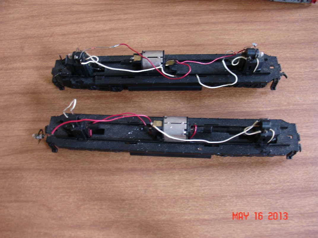

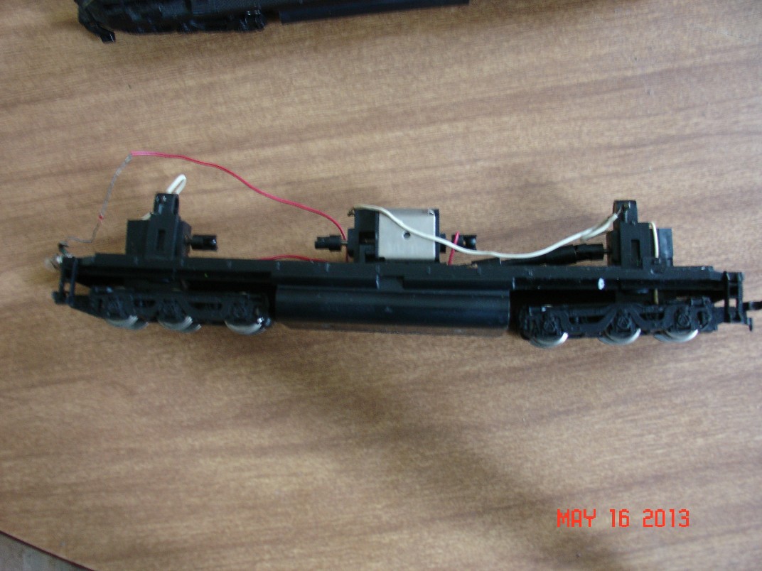

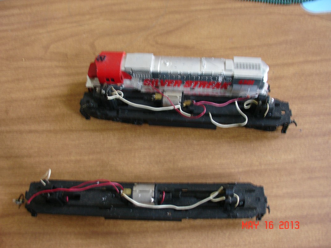

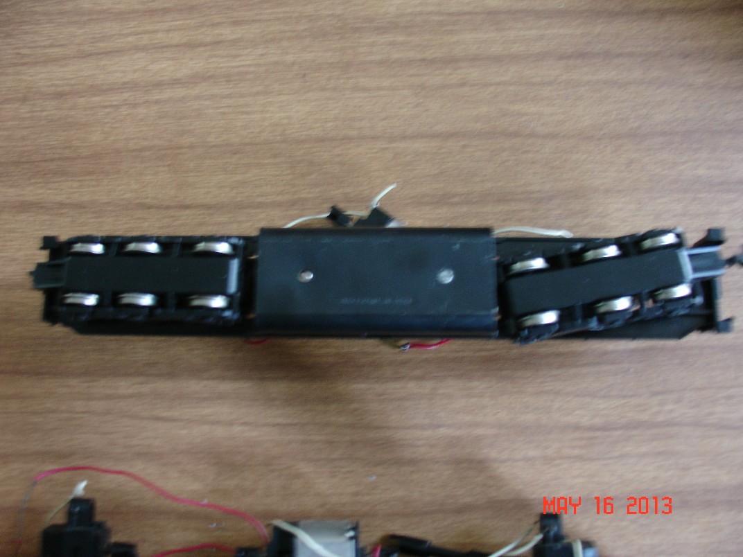

recently aquired these at a tag sale not certain who made them and what engine they are for
they are longer than a 630 and scale out at 47ft end sill to end sill
they have the ubiquitous made in yugoslavia and noting more
any help would be greatly appreciated

 Posted - May 16 2013 :  9:26:00 PM Link directly to this reply  Show Profile  Add NickelPlate759 to Buddylist
Mehano Alco 628.
http://www.ho-scaletrains.net/ahmhoscalelocomotives/id19.html
They were sold by a number of companies over the years.

thanks nickleplate I went to hoseeker and the only thing I could find was a blurred instruction sheet for it. I did find a better one for a MEHENO sd40 that was a little better. would like to rebuild these but parts may be a problem. for starters one of the motors is missing a brush and spring. I suppose I could improvise I checked out the MEHENO web site and the appear to only sell train sets and no parts. well I will set these aside for now , a good kit bashing project

Unfortunately the key parts on these are the driveshafts - I just cobbed one back together a while back. They're unique to these locomotives. Without those, all you have is some spare parts. But then with the handrails smashed off that's all they're good for anyways.
The motor is fully interchangeable with GP18, later RS11 and RS2, and the SD40-2, if you change the couplings on the ends. Later Premier versions of this loco they changed the motor and mounting somewhat. The gears in the trucks are also interchangable with some of the gears in the other locomotives. Truck clips are unique (I still need one).

Most of the 4 wheel and 6 wheel trucks have interchangable parts. I just wish a gear reduction kit was made for these! I say go ahead and add all-wheel pick up to. The wheels are on a insulated axle so no shorts will occur.
