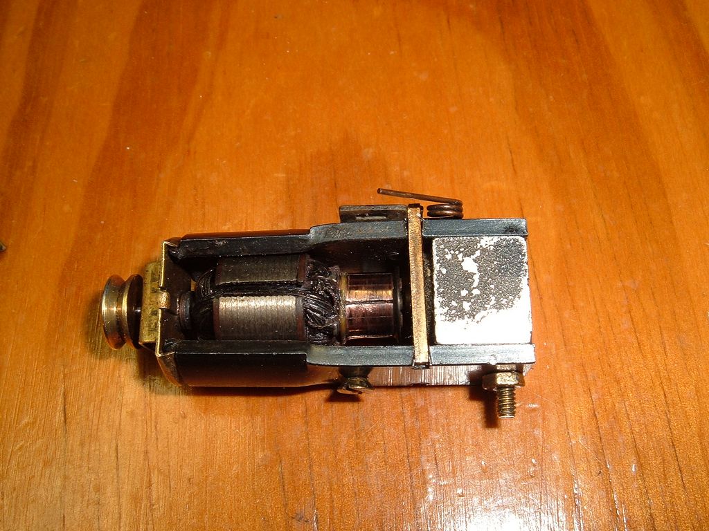

This is the motor from my Penn Line D1 Midget with a rebuilt commutator. It exploded on the first test run (the Midget was given to me in pieces), and I had to scour the room for all 5 segments. It was clearly subject to severe overheating, and the fiber disk against the windings was cooked. I tied the segments together with a loop of thread on the winding end, then sealed everything with CA, which also stabilized the cooked winding insulation. It runs well, but it has a balance issue that causes annoying vibration against the shell.
