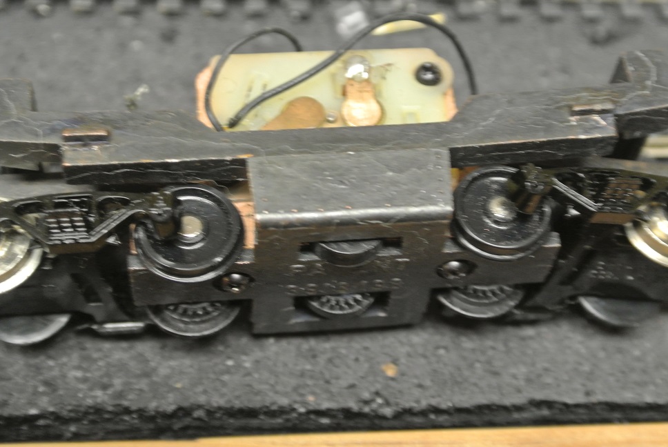

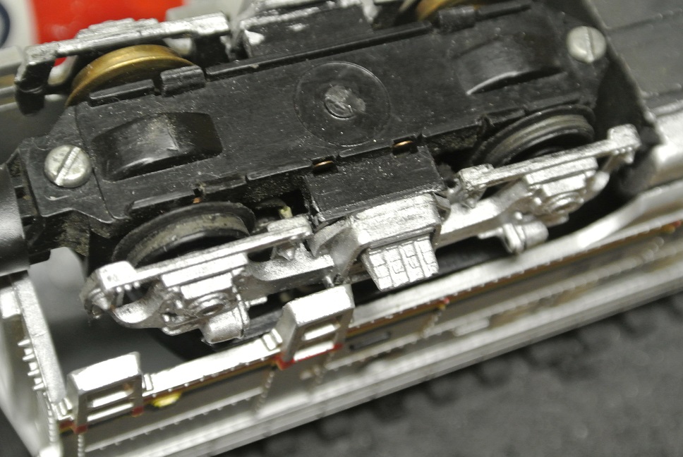

I have had good luck using super-traction tires available from catalogs or from hobby shops. They are a bit wider than the factory Tyco tires but can be pressed in to the groove for a good snug fit, it just requires a little more patience. You will be rewarded with a smoother rolling wheel in the end. As far as the cracked wheels go, if they are the plastic set without gearing, you can use older plastic Athearn dummy unit wheels and drill out the centers to make them fit the larger Tyco axles. If they are the geared set, try to find replacements, but believe it or not they can be removed and repaired with super glue. I have even had luck with hot glue witch can be used to fill the cracks and then carved and filed to get the wheel back in shape.

 Posted - January 05 2014 :  12:32:56 PM Link directly to this reply  Show Profile  Add metalsmith1 to Buddylist
Here is a picture of an MU-2 with Athearn wheels installed on the insulated side. If you notice, there are no traction tires.

 Posted - January 05 2014 :  12:44:11 PM Link directly to this reply  Show Profile  Add metalsmith1 to Buddylist
Here is an example of a Tyco tender drive with drilled out Athearn wheels installed
