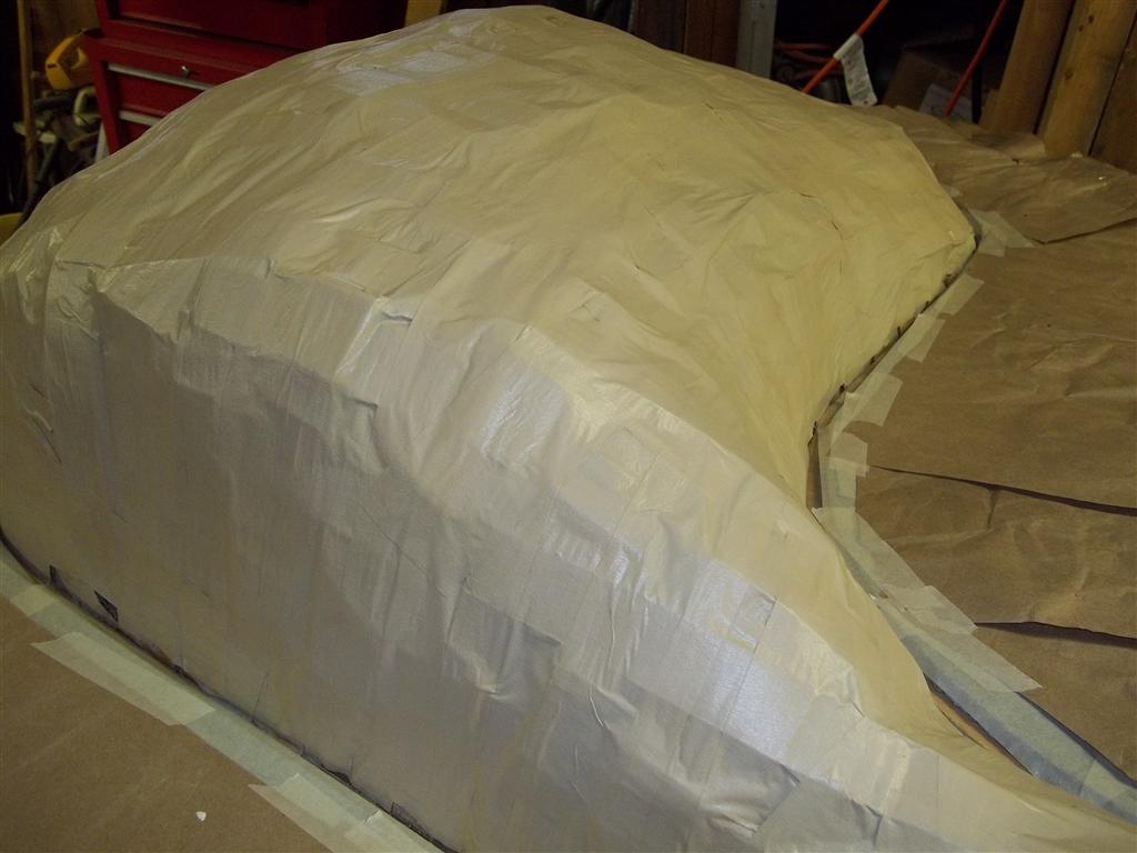

I don't believe that I will be using any foam board on this, unless it happens to be in the area that is shown in the one photo. I had wanted to try many different scenery techniques in order to work with them, and see how they actually turn out. The process that I have been using so far is shown below, the photos are of the large mountainous area shown at the far end of the layout. I am kinda thinking that this area is really to big and bulky and it may have to get cut out and replaced. We'll have to see how it looks as we go along.
I use cardboard strips that are glued to the track roadbed and fascia, crisscrossing each other forming a web. Then I cover that with masking tape and slap a coat of latex paint on it. The paint is more to give me some color if I don't get around to getting it covered right away, it also helps the plaster coating bite into the tape layer a bit better.

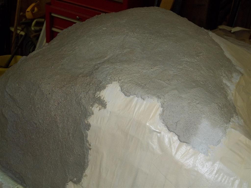

I use a mix of plaster of paris, vermiculite, portland cement, and baking powder for the scenery base. This is a formula that I got from Joe Fugate in one of his video series, (no advertisement meant there, just giving kudos to him for the formula). I have found that this formula gives a very natural and realistic ground texture. It naturally has a little bit of a coarse feel and look to it, just as a natural ground area would have. With a bit of practice I have found it easy to incorporate small depressions and rises in the scenery base.
Once the plaster coat dries out, I add my base scenery paint color to it. Adding a bit more paint here and there to get different earth tones and different levels of definition.
