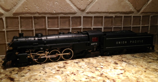

A picture of her

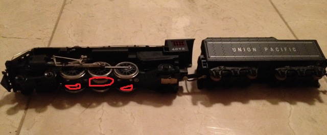

 Posted - November 29 2012 :  9:13:56 PM Link directly to this reply  Show Profile  Add SCVR66 to Buddylist

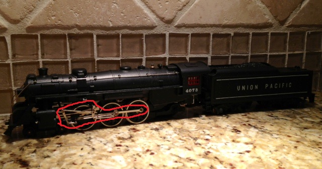

I crudely circled the important areas to oil. Every rods screw, basically everyhting that moves.

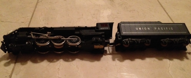

underneath view.. just cant tell what to remove first

 Posted - November 29 2012 :  9:25:14 PM Link directly to this reply  Show Profile  Add SCVR66 to Buddylist
You don't have to remove the cover plate. You can just oil the axles where it touches the frame, simply by pushing the drivers to one side then the other.'
Reminder, Grease the drive gear!
and no problem! I'm a young guy too! I will have HO and O gauge trains around the tree this year! Last year I got creative and had a custom built HO loop inside the G scale loop! Was a lot of fun!

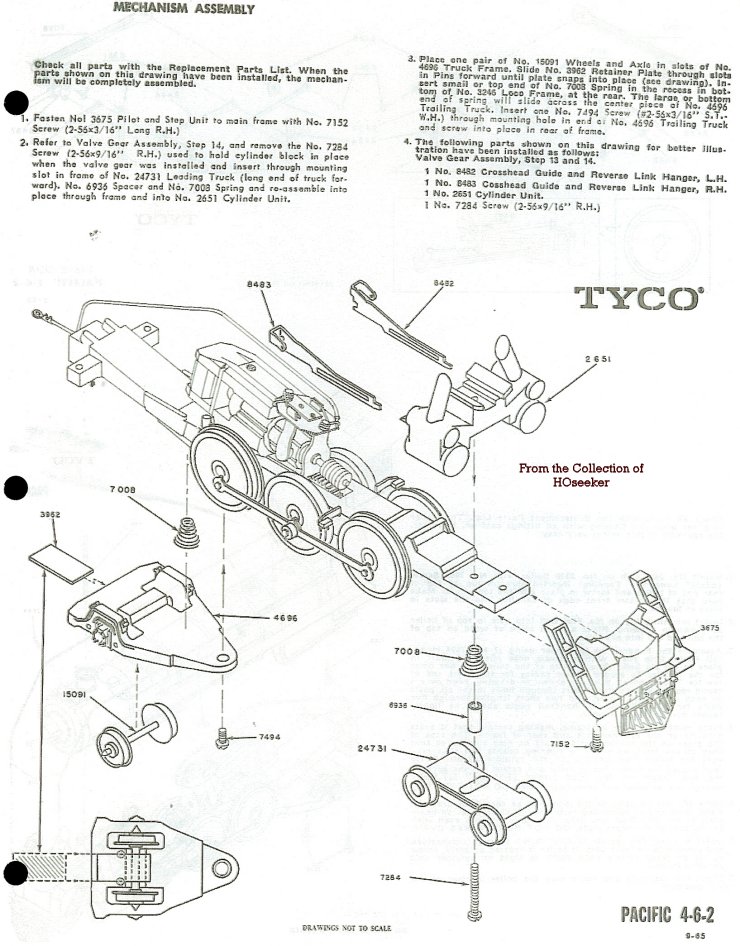

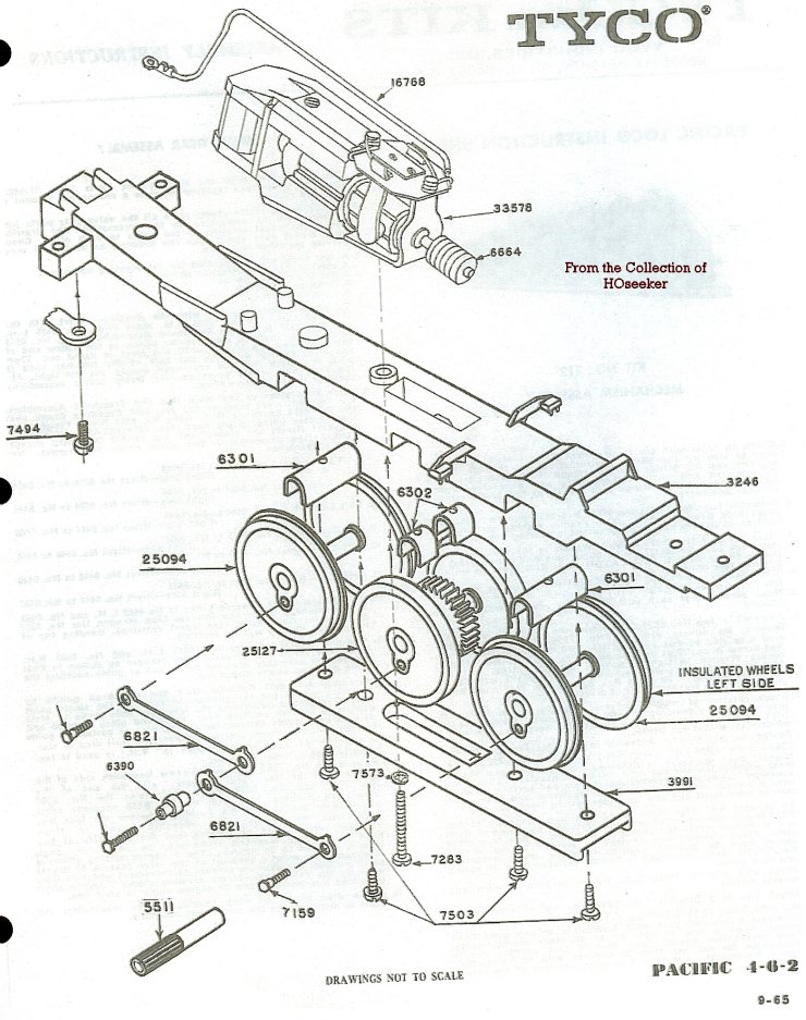

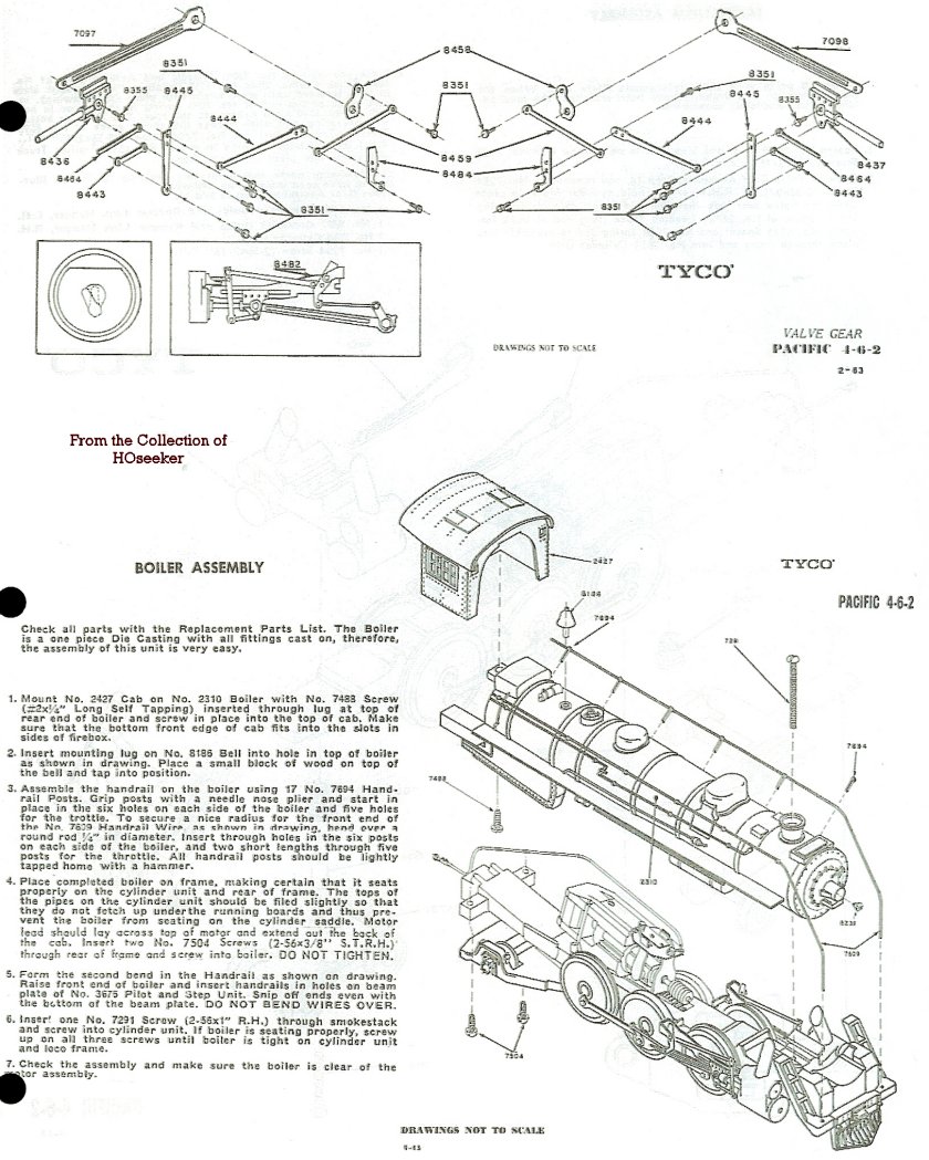

 Posted - November 30 2012 :  2:05:34 PM Link directly to this reply  Show Profile  Add NickelPlate759 to Buddylist
RTR, SCVRR is right, just go sparingly with the oil, otherwise it will work it's way down to the rails. A pen oiler with a needle tip is best, but you can put a small drop on the tip of a toothpick as well. You can reach the motor bearings without removing the boiler, but oil sparingly, especially the front bearing.
Here are some diagrams so you can see under the hood. The boiler is very easy to remove with just the screw in the stack, and the 2 under the cab.
http://www.hoseeker.org/assemblyexplosiontyco/tyco462pacificpg2.jpg
http://www.hoseeker.org/assemblyexplosiontyco/tyco462pacificpg3.jpg
http://www.hoseeker.org/assemblyexplosiontyco/tyco462pacificpg4.jpg
Bookmark HOSeeker... it can be invaluable. http://www.hoseeker.org/
