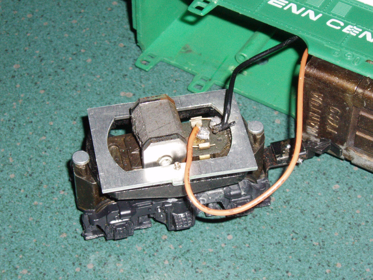

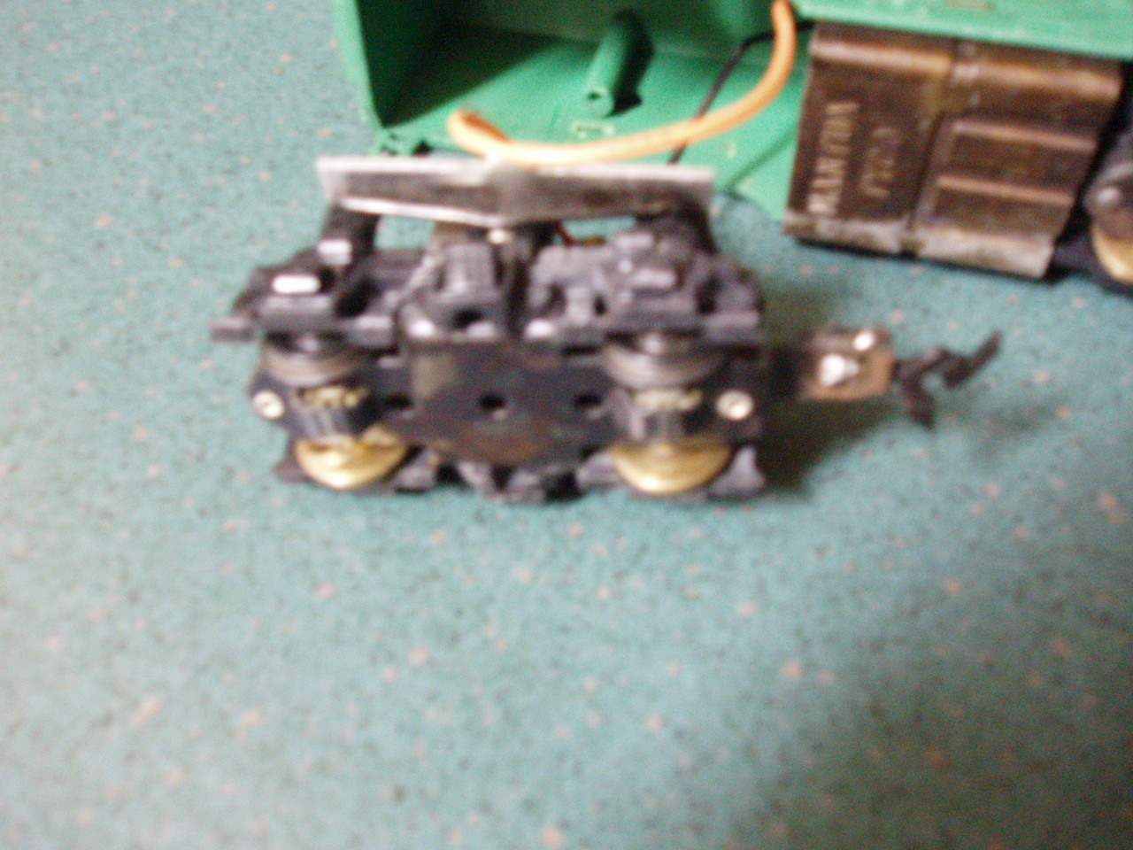

I am new to the forum and so far impressed with the help you guys pass around. My problem, really two issues, are - the motor does not seam to be able to be dismantled. At both ends it appears to have rivets. I could drill the pins from the bottom but are the pins (rivets) replaceable. The reason I need to dismantle - 2nd issue - is that the transformer is glowing at full power indicating resistance, although the Diesel still runs all be it a little slower . Resistance is some where and thought it could be a build up of carbon on the contacts, but not sure. Maybe someone could suggest whats up. I run Tri-ang, Life-Like and Atlas and can usually get to the armature and points to clean but not with this unit.
I have attached a couple of pics to show the motor.

The rivets can be drilled out, but don't usually need to be to service the motor. You can soak the whole truck in alcohol and clean it with a brush, and use pipe cleaners to get into the recesses of the motor if necessary. You can even snap off the sideframes for easier access to the commutator, but you'll have to glue them back on.
The orange wire makes me suspicious tho, because I don't think it's original. It should go to the back of the headlight bulb. Check the the bulb is properly mounted, and that a frayed wire or bad solder job isn't causing a short.

I had a hell of a time trying to get to the web site. I thought Sandy submerged the server. Good to know you guys are back on line - a lot of Aussies have been following both Sandy's progress and the presidential election race - hope this next blower is a fizzer. Thanks Nickelplate, AMC Gremlin & Weekendrailroader, I idn't want to go that far and remove the revits until I heard back from the forum. The PENN is too good a runner to experiment on. I agree - the orange wire is foreign and I guess the joint or something in the motot is causing the resistance. I'll follow through and check both - wire first. I will try cleaing without disassembling but failing that - the thin bolt and nut may do the trick. Cheers

After a second look, there's a pretty messy blob where that wire is soldered to the post. That or stray strands could be shorting to the other brush.
