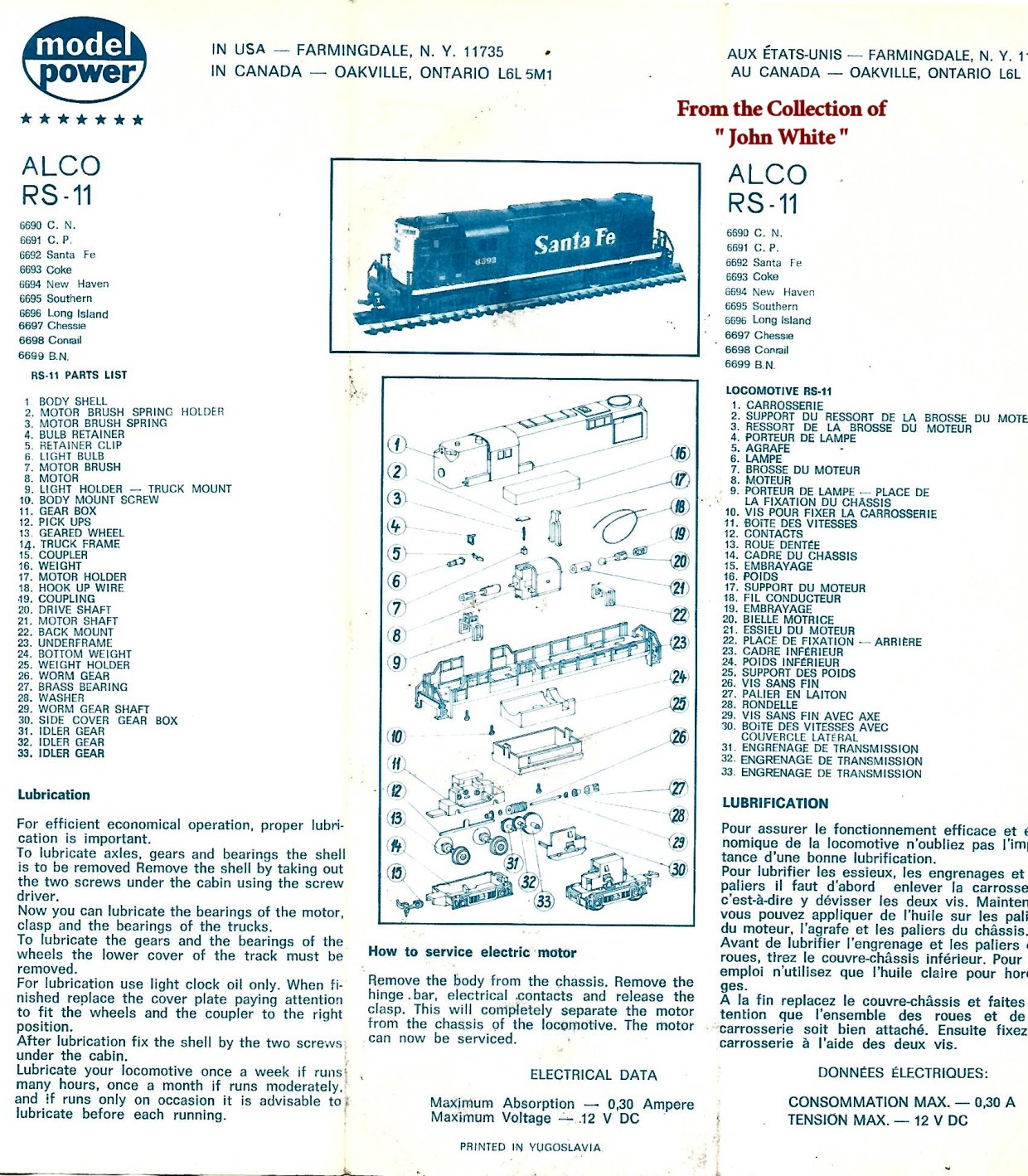

 Which drive type is this?
Author Previous Topic: American Flyer anyone? Topic Next Topic: Battery powered HO engine, Japan
Islanderh93
Catskill Mountain Railroad
 Posted - November 19 2012 :  6:46:56 PM Link directly to this topic  Show Profile  Add Islanderh93 to Buddylist
/tyco/forum/uploaded/Islanderh93/20121119183846_0 holy rs11.jpg
This is a picture from a listing on ebay, found here:
http://cgi.ebay.com/ws/eBayISAPI.dll?ViewItem&item=360509687326
I'm interested in the unit for parts in the rebuild of my AHM RS-2, which has a vertical motor on the single rear truck (in the cab) which has begun to overheat, smoke and otherwise indicate an innevitable electrical problem (fire). I'm curious to know if this shot, or any shot on the guy's listing, could identify whether this is the same verticle-driven locomotive, or if it is the later drive unit with a centrally mounted motor. I want to get one with the centrally mounted motor.
I have come to like ALCo RS-11 locomotives, but this one has a hole in the roof, which leads me to believe it is a vertical-motored locomotive that already had its burn-out. If I can't find a canidate for a chasis repowering this week, I'm going to start looking for a motor to remount in place of the existing 'smoker' motor. I'm searching the forums on articles pretaining to repowering an RS-2, because I know its on here somewhere.
and yes, I asked the seller if he could tell me (or show me) what kind of motor it has. At the price he's asking, I'd give it a try for parts, or maybe the shell... anyone know how to fix melted rooves?

It's Life-Like. http://tycotrain.tripod.com/lifelikemodeltrainscollectorsresource/id12.html

So is that an 8 or 4 wheel drive unit then? I had no idea LL/ Varney made such a locomotive!
 Posted - November 19 2012 :  7:19:59 PM Link directly to this reply  Show Profile  Add NickelPlate759 to Buddylist
Originally posted by Islanderh93 - November 19 2012 :  7:14:31 PM
They didn't. It's a Mehano unit that Life-Like imported, and somehow AHM never did, even tho it's got the same drive as the AHM Alcos. My friend had one in Green Bay livery when I was a kid.
That one is 4 wheel drive, but they later got 8 wheel drive when they moved to the Model Power line, as did the RS-2.

Okay, so it is a Mehano, as its underbelly would lead me. But then is there any way to tell how many wheels are driven? I guess I've got to wait until the seller gets back to me on that.

I'm not sure Life-Like had exploded drawings or even instructions for these. If they did, I've never seen one. The one in the auction is 4 wheel drive (note the traction tires). I don't think Model Power sold it in Green Bay livery, anyway.
Rivarossi and Mehano always needed an importer to handle their US sales, perhaps in part due to the language barrier. One of the AHM guys said recently they were interested in him as an importer (Mehano's still in business to some degree, making toys, mostly), but he's at a point in his life where he doesn't want the responsibility.
Btw, here's the thread you were looking for. You have to search for "coffee grinder."
http://www.tycoforums.com/tyco/forum/topic.asp?TOPIC_ID=7136
Also, the instructions for the MP version:
http://www.hoseeker.org/modelpower/modelpowerrs11pg1.jpg
Edited by - NickelPlate759 on November 19 2012 8:24:33 PM

I can't believe I didn't notice that in the picture. The traction tires. Darn.

One thing that I look for in these pictures (other than traction tires) are the metal bottom plates that are held on to the trucks with screws. These are usually on the 4-wheel drive units, whereas the Mehano 8-wheel drive versions have plastic bottom plates and no screws.

The vertical drive RS2 was manufactured from 1967 to 1974.
The dual truck drive was manufactured from 1976 to 1980.
I know they don't put production dates on the models but, it might be helpful in some way.
Vertical drive locomotives had the handrails and walkways as snap-in separate parts. The dual drive units had the handrails molded to the chassis and the walkways were a molded detail integral with the chassis.(same way as the AHM GP18). As mentioned before the screw type cover plates for the trucks or all plastic snap fit trucks is another way to tell the difference.

http://www.ebay.com/itm/HO-scale-Model-Power-Southern-Railway-ALCO-RS-2-locomotive-train-/181028973242?pt=Model_RR_Trains&hash=item2a262aeaba
So you mean to say that this locomotive should have 8 wheel drive. Hopefully the bid stays low enough to make it worth it. I've also begun the hunt for CD motors. I like this alco listed though, so I'm not sure if I want to take it apart....

That's the 8 wheel drive unit by looking at the external features.
Seller claims it is, also. Like that means anything.

Trouble is, the dual drive is almost a completely different animal - to make the older shell work you'd have to cut away the walkways and seriously alter it. I think it could be done, but it's a lot of work.
The RS-11, C415, RS-2 and Alco 1000 switcher all had that vertical drive when introduced. The GP18 seems to have come later and always had the 8-wheel conventional style drive. This drive was used in every one of these engines - the C628, FP45, SW1, even the AHM version of the GG1 got a variant. Even the FM C-liner got that drive towards the end of production (I see it most commonly in Bicentennial paint engines). The parts are all interchangable, and I can swap a drive from a junk chassis into a clean dummy unit in about 10 minutes with just a small screwdriver and some needlenose pliers.
