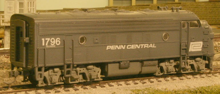

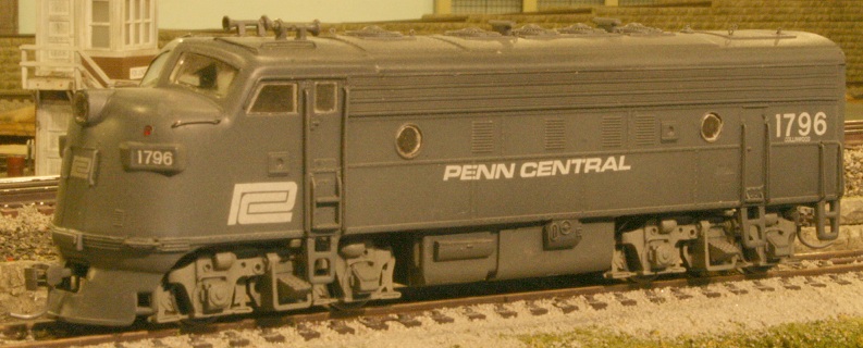

After building my Penn Central C430, I decided to make a dummy Penn Central F7 to use as a companion. This project involved striping a Tyco F7 shell of paint, removing the steam generator details and adding appropriate grab irons, lift rings, and window glazing. I replaced the original Tyco trucks and underframe with an old Athearn Hi-F mechanism that I found in the junk bin at my local hobby shop. The following pictures show my results.....
I especially like the Tyco shell for this project for two reasons, first unlike the Athearn shell, the Tyco shell has only one headlight. New York Central didn't order their F units with two head lights so the Tyco shell saved me from having to make an extra modification to the nose. Second, the real Penn Central was so broke that minor cosmetic damage to their units was left unfixed. For example most of PC's F units had side grills that showed distinct signs of damage. This is good news for those of us who want to use the Tyco F unit for this project because often times this detail is distorted on Tyco's shells. Molding flaws of this nature may look out of place on a model of a Santa Fe Passenger Warbonnet F unit but look just right for a PC freight beater!

Another impressive example next to you C430.
 Posted - November 17 2012 :  8:42:48 PM Link directly to this reply  Show Profile  Click to see EM-1's MSN Messenger address  Send EM-1 a Yahoo! Message  Add EM-1 to Buddylist
Scott,
Again, AWESOME work! I see what looks to be a Athearn frame under the TYCO shell? I swear by Athearn frames whenever possible! Gives those old units a new life! And as long as the frame never gets damaged, the parts for them are everywhere so......And not to bad to get!
Very realistic work and to that nice paint and all. again like the C430, looks AWESOME!

Very nice job... even the photos look period. You should power it. With Athearns it's not that hard (although you'd need powered trucks).

I considered powering this unit but decided against it. First of all I used an old Athearn Hi F rubber band drive locomotive frame for this unit and Athearn gear drive components are not compatible with the Hi F frame. What I might do instead is make a matching powered B unit starting with a gear driven mechanism. The other thing to consider is that PC operated their F's in four to six unit lash ups, I certainly don't need four to six powered locos to pull any of my layout sized trains! However PC needed to overpower their trains in the likely event that some of them died en route! Come to think of it, having a dummy unit that provides no tractive effort is just like a prototype PC train dragging a failed unit around in its consist.

The marker lights above your number boards, the red is that a bulb or a jewel? They look like they may light up and thats COOL!

Sorry, those class lights are just jewels but I like the way they catch the light and provide a little color to this otherwise drab looking loco..
