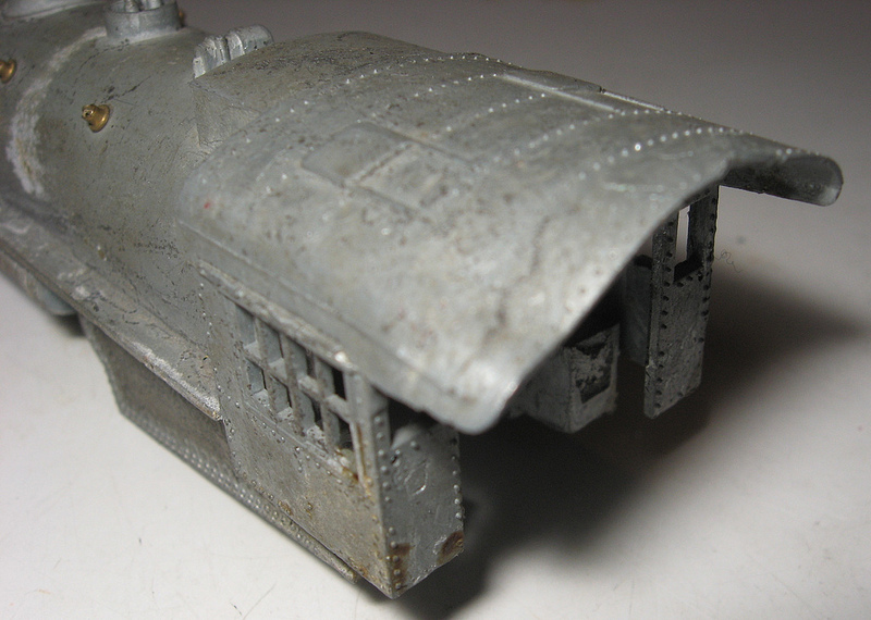

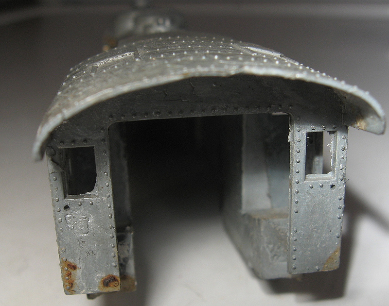

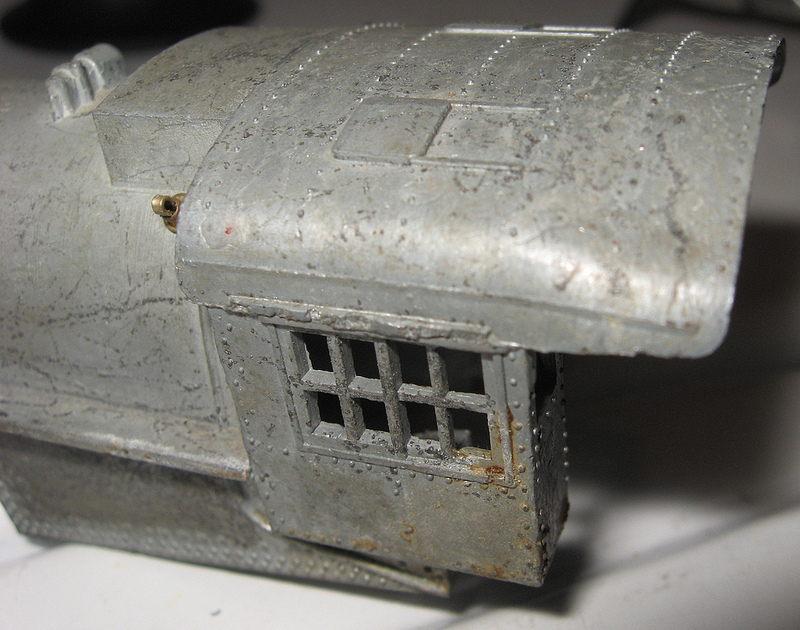

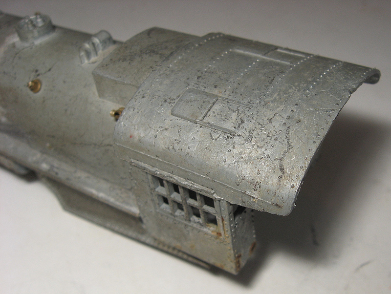

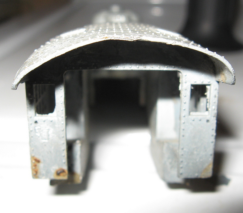

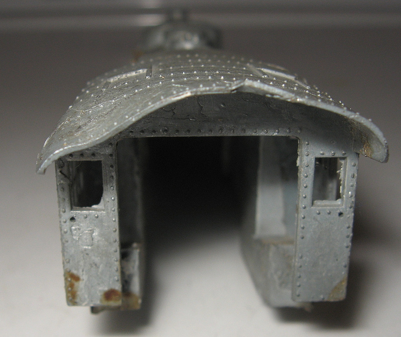

OK guys,
How many of us threw away that original die cast part because it was bent so bad that we knew if we tried to straighten it cold, it would crack and break off! Well, here is my solution...

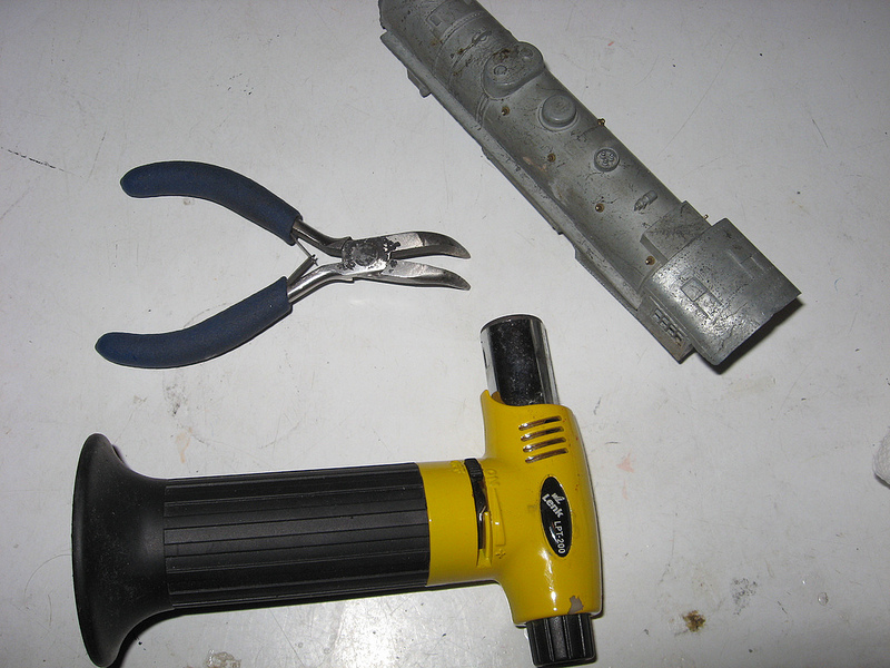

Using a pen torch and a smooth surface pair of pliers this repair is not only easy, but it is permanent, safe and fast!
See the series of photos below. The cab was so bent, I was not sure if I was going to be able to straighten it, but I thought it was worth a try. I have done this a dozen or so times already, but never took pictures as I did it. I figured this time I would. I have done this on engine and tender steps too. I cant tell you how many Pen Line Whitcomb mini locos I have received that had curled steps. After trying to straighten them cold and failing, only to break the step off and then be forced to CA the hell out of them, which was such an obvious F**k up that I just plain got disgusted with it. Since I have been doing this as a repair, I have yet to ever crack a single thin step!
The secret is to heat the metal with the torch, waving the flame back and forth at first. Actually, I use this torch that stands on it's own and I wave the piece back and forth. Cabs are easy because you can leave them attached to the boiler and use the boiler as a handle. The key is to get the metal soft, but not so soft that it starts warping and melting. (If it is RED, it is too hot and probably shot).
Apply steady but firm pressure with the pliers. Apply the pressure starting from the edges and gently work toward the deepest part of the dent, gently bringing it back into shape as you move along. If the dent is huge, do it in multiple passes with the pliers. Do not try to bring the dent completely out in one pass. Bring it out a little at a time.
See the below photos as done in series. As you can see, I took an intermediate picture showing most of the dent removed, but not completely. After a little filing with a jewelers file, it is done. The repair is as strong, if not stronger than anything else I have ever seen. To be honest, the impact dent, as long as the metal is not cracked, it can be repaired. It might even be the case that the heat actually relieves the internal stress that was applied to the metal from the impact and subsequent deformation. I have no way of testing this however.

Great idea, Sean. I'd never thought of heating it, frankly. I have en electric heat gun that should be sufficient for this. I've had luck cold bending very slight deformations in zamac, but beyond a certain point... *snap*.

I tried this technique on the valve gear mounting pins on a Bachmann I10 Consolidation, which are very thin and impossible to straighten otherwise. Just heating them with a Bernz-O-Matic grill lighter allowed me to bend them back into shape. Thanks!
