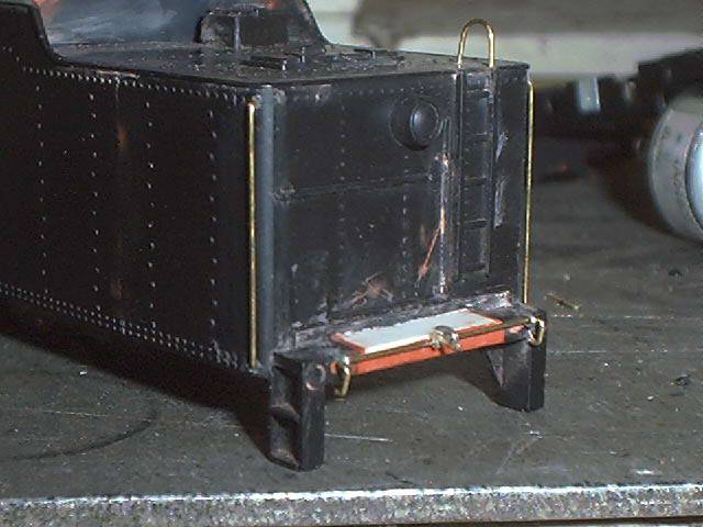

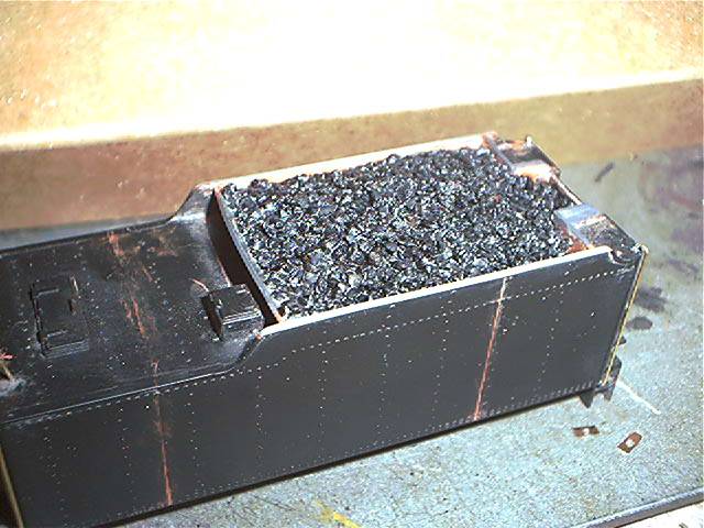

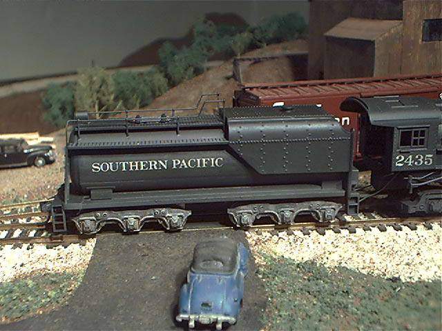

These are some photos of a Tyco 0-8-0 tender that I shortened and modified the sides of the coal bunker This tender was done in a similar manner as the one posted in this week's LOW
I made the cuts on this one to eliminate the mounting holes on the sides, modified the sides of the coal bunker and added a new coal load since the original coal load was removed due to the modification of the sides.
I am still looking for the in progress photos of the tender shown in the LOW to show where the cuts were and the coal load splice.

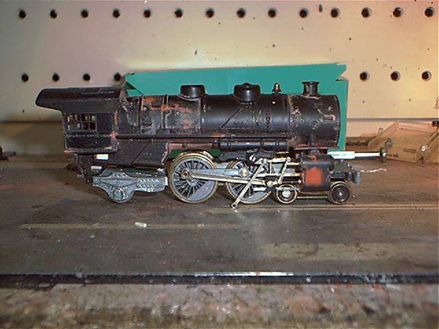

Here is a link to the locomotive build that the above thender went to. (hope it still works)
http://www.2guyz.info/Forums/viewtopic/t=395/postdays=0/postorder=asc/start=0.html

Thats AWESOME! You took, what looks to be a Brass 4-4-2 boiler and mounted it to a First One Models 4-4-2 frame?
The boiler front idea worked well! NOW ,if you had it not on the locomotive, I could make a mold to cast them in resin plastic!
Question on the tender, what did you use to make such fine cut lines and have no real "cut" mark and then glue to together so well with no line and what looks to have no sanding either......normally those 2 ideas don't go hand in hand!

It may be hard to believe but the cuts were made with a straight edge and a hobby knife. The sections to be glued back together were filed until they fit each other then they were glued together, then wet sanded. Honestly, there is some filler in those splices.
The boiler is a shortened Tyco 0-8-0 with a Model Power (or IHC).

Seamless splicing on that tender, Ray. I like the bunker much better. I could never figure out why the original was so tall when it didn't need to be to clear the motor block.
Neat little Atlantic, too.

Thats precision work and VERY clean as well. I must say with the cut joints, seamless to say the least!
I'm still pondering the cuts with a straight edge and a hobby knife! WOW! And I thought I made seamless lines with my mill and a good sharp spinning blade...

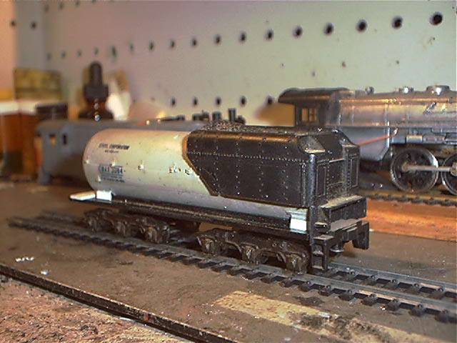

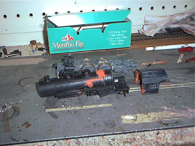

This was another Tyco tender kit-bash.
The rear and mid sections of the shell were damaged. I replaced them with part of an AHM tank car.
From this.
To this.

Ray, that's not so different from the actual Vandy tender Mantua made. I have one in NYC, and they used the long haul tender floor like that.

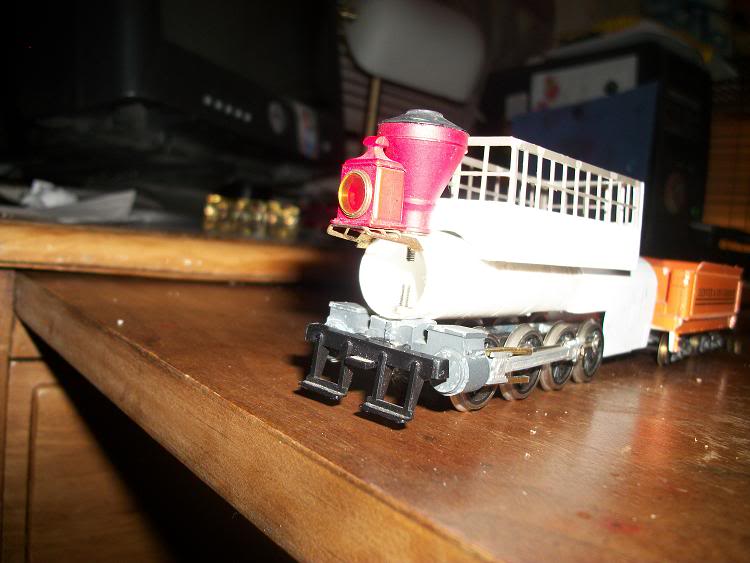

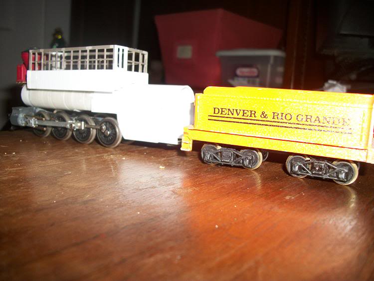

Ray, PVC works for ALOT specially round AND it can be shaped accordingly as needed....

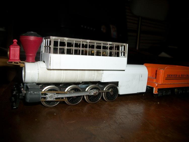

So, I'll post you something to see if it might have been me that done what you recall seeing:
This is a Winan's "Camel" from the 1840's that the B&O had many of them....ALOT had mentioned a few details not right, nope it isn't, the locomotive isn't done.... I took 1/2 inch OD PVC and turned it to be 4 scale feet wide. As these engines had, but as I say, I've got alot of work yet to do to it!
As far as competition, I'm not....I am a shop owner of custom work and repairs so......As you yourself do some real professional work!

Those aren't the ones but nice work.

Yeah? I thought it might have beem but thats OK, you see the Winans Camel I'm building, thats got all sorts of parts from other comanies in it, Rivarossi, MDC Roundhouse, IHC, Mantua, Bowser, and YTR built parts, along with some brass additives, (the gear box for the 3rd driver) and God only knows what else I'll be using in its constraction. As I am not done with it yet.....

Thanks Ted! Sadly, I can't wait to get her done, BUT, I got so many other projects so close to finishing, I had to put that one pictured here, on a back burner so to clear up other work I have thats pressing, so.....
Customer work, always comes first!

Cool Winans, John! What is the passenger compartment framing... wood strips?
Originally posted by NickelPlate759 - October 09 2012 :  11:44:23 PM
Nelson,
I am sorry, I didn't notice your reply till I went back and looked again!
Those parts are from a MDC Roundhouse old time passenger car "Coach" that I needed to make the lower half of the large cab, the "windows" you see, are parts from buildings I had laying around those are left over wooden sach windows! Cut, fitted and spliced to fit the lower section. I have to make a roof for it as it stands right now.....I used doors from a building too as they look as such, in the pictures I have of the real life locomotive.
The worst part, is the scale of the locomotive, they were odd sized! The real bloilers were only 4 feet diameter, and the boiler I made is slightly larger then that, scales out like 4 feet 4 inches in diameter, and the drivers aren't scale either, and sadly the drivers were like 48 inches tall.....The drivers I used are off a TYCO "tender power" 2-8-0....SO, this locomotive isn't 100% accurate but its close. The firebox as seen is not complete either, I have a ways to go on it as I have to add a slanted firebox "crown sheet" as the real one had and right now, its curved like the boiler, which will change! PLUS I did not make the firebox, the intended length either, its made to represent the rebuilt "Camel" as the B&O had them rebuilt with longer fireboxes....
