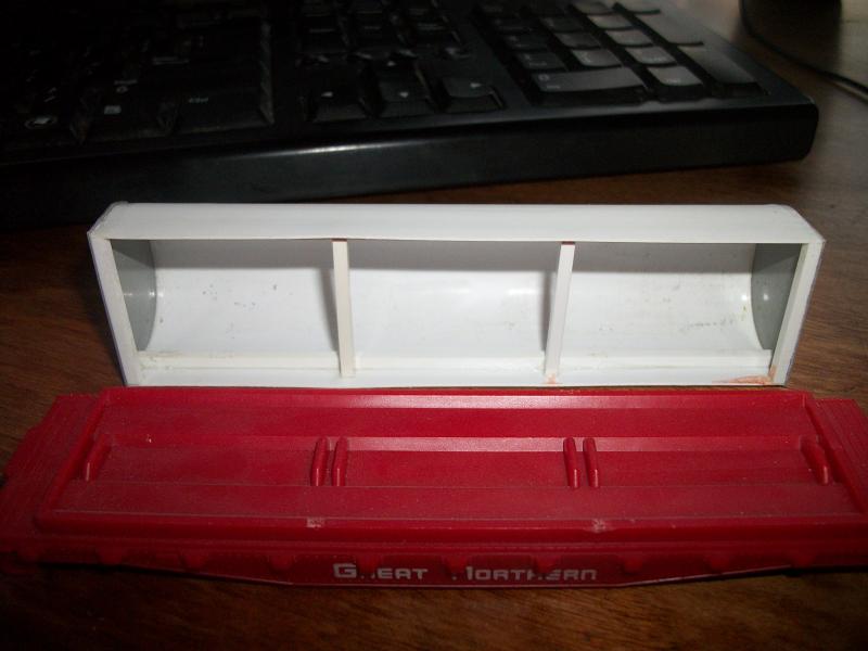

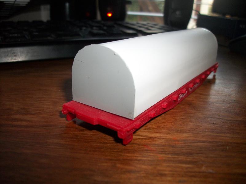

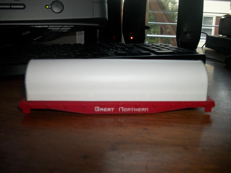

Well needless to say, I got to a point that I wanted something more....
All you guys know of these cars, SO, while up late last night, I came up with this:

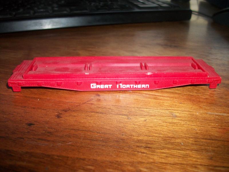

The following shows the under side details:
Im not sure I'm 100% satisfied with this, so I plan to try a few other ideas as I would like to mold these for sale in the future and working out the bugs, is a big job for the casting process!

I like the flat car cover idea. Maybe a lip down the sides at the same height that the lip is on a Tyco trailer so it can be lifted off like a trailer. The smooth sides will make for great logo placement.

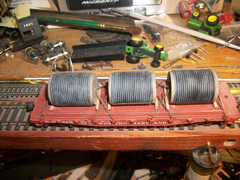

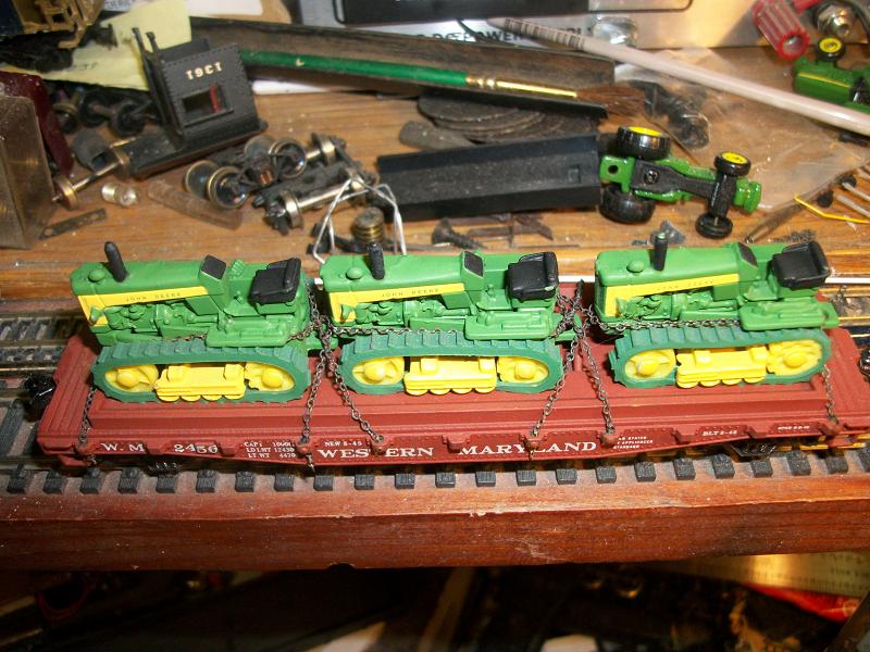

I really like the spools and the tractors.

As for the spools that load will be going with a "power plant" supply train, I'm working on that a few pieces have been revealed of the past month or so.....
The tracked tractors in John Deere, is going to be a whole other ball game with a mixed freight train. Sadly tho, I have multiples of these cars (I probably have 80 of these TYCO flat cars!) Which I plan to do different things with! WELL, being said that, the early railroad years of carrying steel coils weren't much different, on flat cars atleast, they then also used gondolas, covered or open top!

I just need to make the hoods to have less interior framing. As the casting process will not allow the 2 center cross braces in it, PLUS the casting process is done with Plastic Resin, which doesn't glue that well to start with so, here I am trying to make these that they can be casted without all the cross bracing to ease those who buy them from me of the extra work (I do the best I can to cut down on the consumer work needed for the added parts.....
I just tried to form a piece of .060 of an inch thick styrene the same way I did the first one, (not pictured as it failed my QC) so, the hood you do see is heat, vacuum formed and worked well, thing is, its from .020 of an inch thick styrene and needs to have the internal cross bracing to keep the edge of the plastic from curling inward.
The .060 of an inch styrene was formed by means of a section of copper pipe that was heated with a torch, and then the plastic laid on top of the hot pipe to allow it to curl around the pipe. Sadly the heat needed to curve a piece of plastic that thick is to much as it makes the plastic stick to the pipe for one, and the heat makes the plastic brittle when it cools.
I'm gonna try .040 or .045 thick stuff when I have a chance to shoot over to the hobby shop to see what I can do with less thickness, but thicker then the .020 stuff!
Also, guys the tractors, are Ertl, and yes are die cast, which adds alittle weight to the cars for one, and looks good chained down and then the whole works dullcoted as those tractors are some seriously shinny when new!
I also have yellow ones that are also JD, which are the commercial ones of the same thing the green ones are for farm use!
The spools, are craft store wooden spools turned in my lathe to give me a better flange for the wire, and then stained, and the wire was old stuff, that was Aluminum wire, I picked from a yard sale for a 30 foot spool of it and it works well for this sort of thing as I'll NEVER use Aluminum wire for anything so.....
