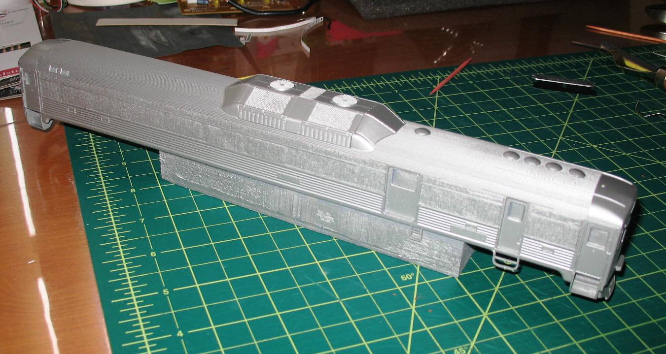

Well, as luck would have it, I managed to screw up the RDC-3 shell I had been given a free Alclad metalizing finish on. Here is the shell as I received it a month ago:
At that point, I was planning to apply Great Northern RDC Microscale decals. No sooner did I start the first one (Great Northern name) then it managed to get distorted in the water soak. I tried to fix it and managed to get it aligned on the shell. I noticed that it needed a little adjustment, so I put a very small bit of Solvaset on it- BIG MISTAKE! the solution started to eat away at the ALclad coating! I subsequently learned that Solvaset does not work well with Alclad, which is a laquer-based coating.
Next up, I had no way to repair the damage, so I removed all the Alclad and rethought the painting scheme for the RDC. I then used my Minnesota, Sioux Lake & Western colors to run horizontal color bands along the top of each car side, then masked those colors and sprayed the remained of the shell with Rustoleum Matte Nickel, which was significantly less "shiny" than an aluminim color and also less shiny than the Alclad (perhaps a bit more realistic, in my opinion).

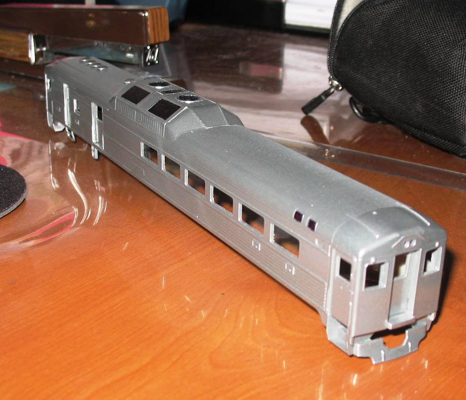

Here is the shell in the paint shop:

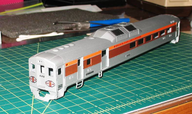

And here is the finished shell:
The roof exhaust ports are painted with primer dark gray rather than black- not much of a difference, but it is a bit more subtle of a "dirty look".
I managed to find a Budd logo online to jazz up the job (on the step riser)

When I gave the Alcad-painted shell a 91 alcohol bath, the paint came off in large "sheets" followed by the primer undercoat. I then found that the shell was a light-colored plastic, and a lot more delicate than it appeared at first, in fact, similar to a resin mold or 3D copier product.
