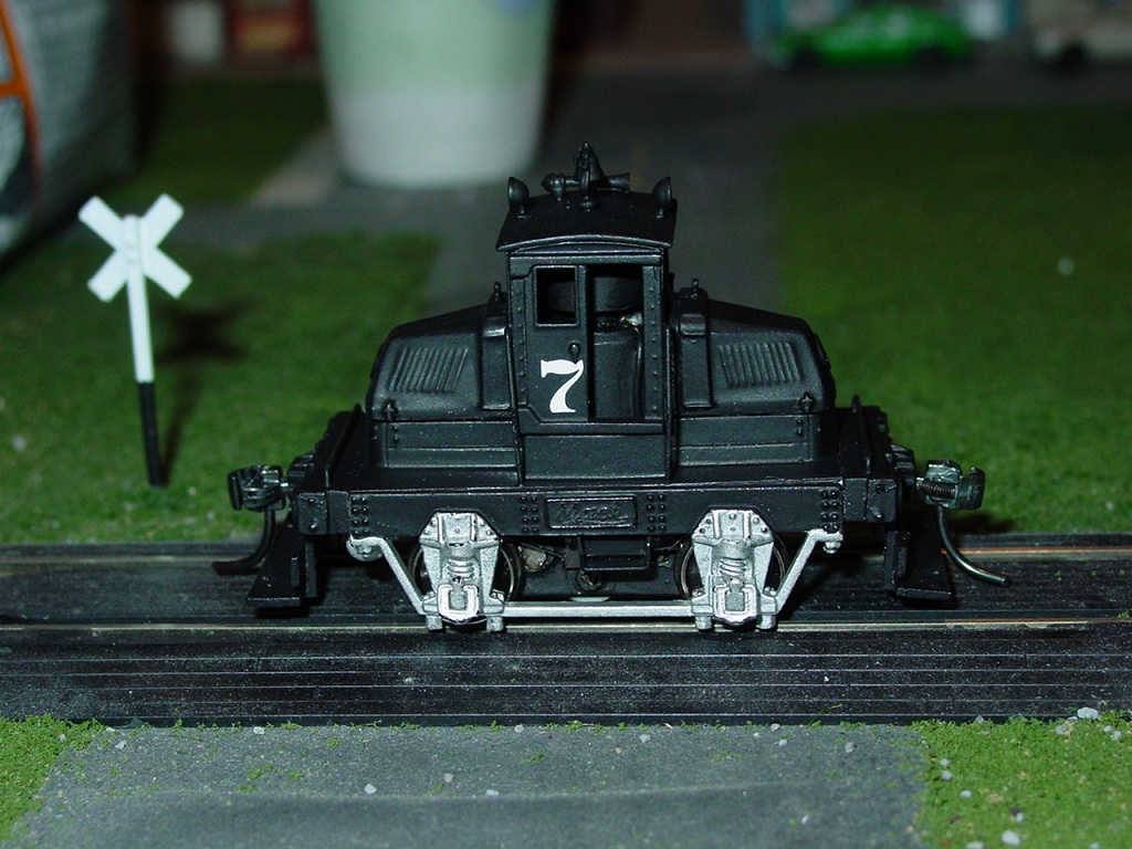

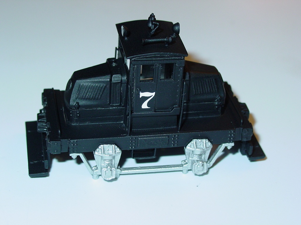

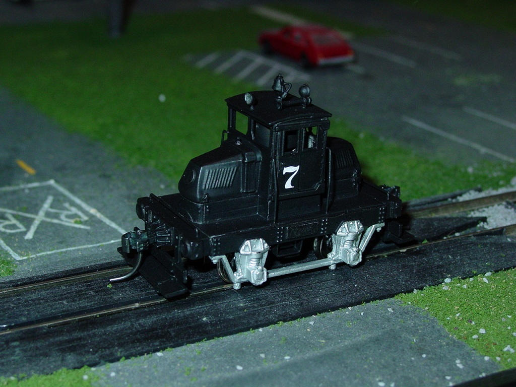

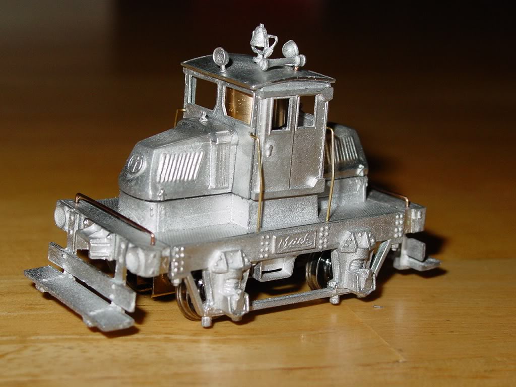

This is a project I started earlier this year, using the unpowered metal Mack switcher kit from Wiseman Model Services.

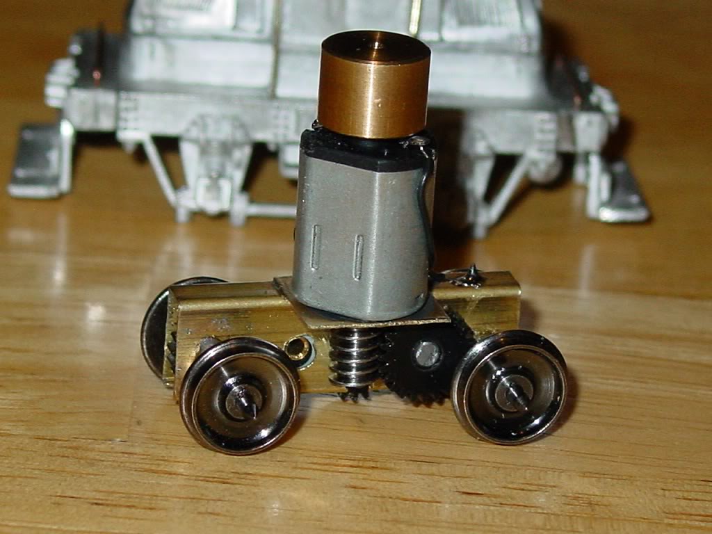

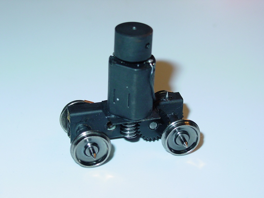

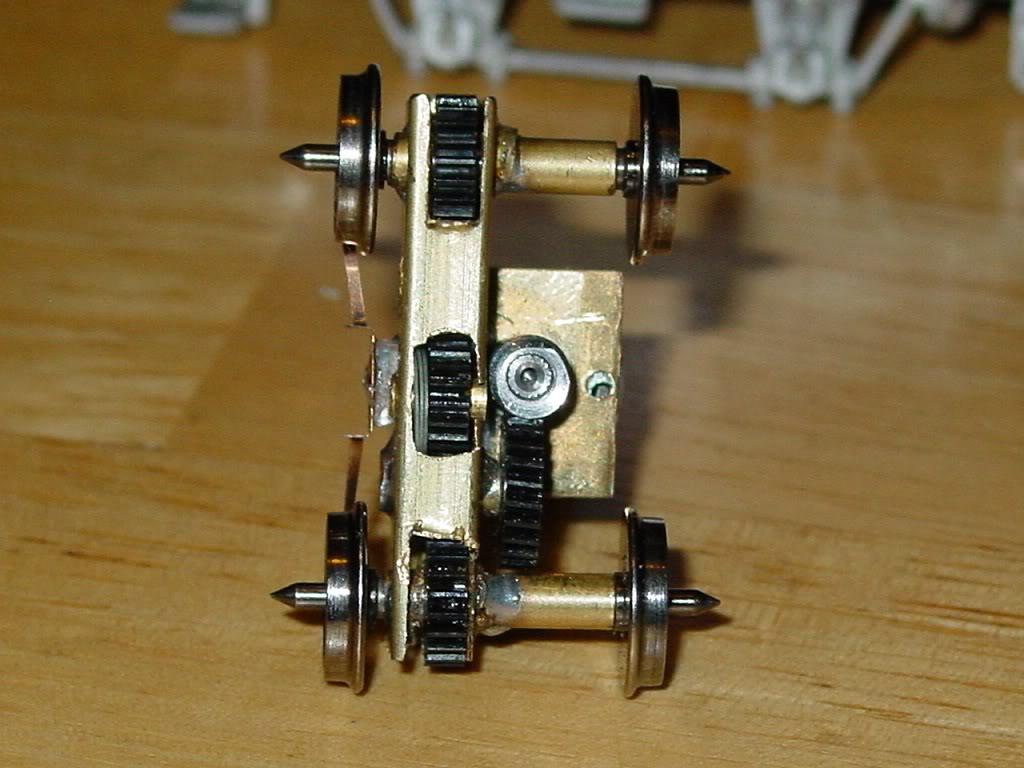

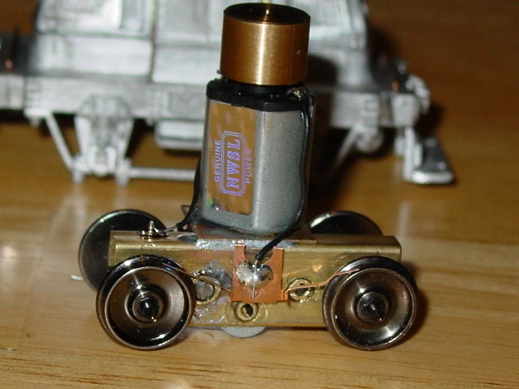

The kit was most definitely designed without motorizing in mind, and there's so little space to work with that I wasn't sure if a powered truck, like the NWSL Stanton drive, would be able to fit in there. So I made my own chassis!
The motor, flywheel, and gearing is all NWSL. The chassis is made from K&S brass stock, and the wheels are Intermountain 33" semi-scale. The motor is very tiny, but it's got more power than most other tiny motors, and the 32:1 gearing makes sure it has plenty of torque. The whole thing just barely fits into the metal body, which only needed slight modification to clear the motor.
The flywheel was actually just a bit too tall and had to have the edge ground down, but it all fits! And today, I finally finished painting and assembling it!
I think it turned out great! The body rests on the axle's needle point bearings, and everything works smoothly. The full speed is 30-35 (I haven't measured it) scale MPH, and it's both extremely smooth and quiet! And with the weight of the metal body, it can pull half a dozen freight cars no problem!

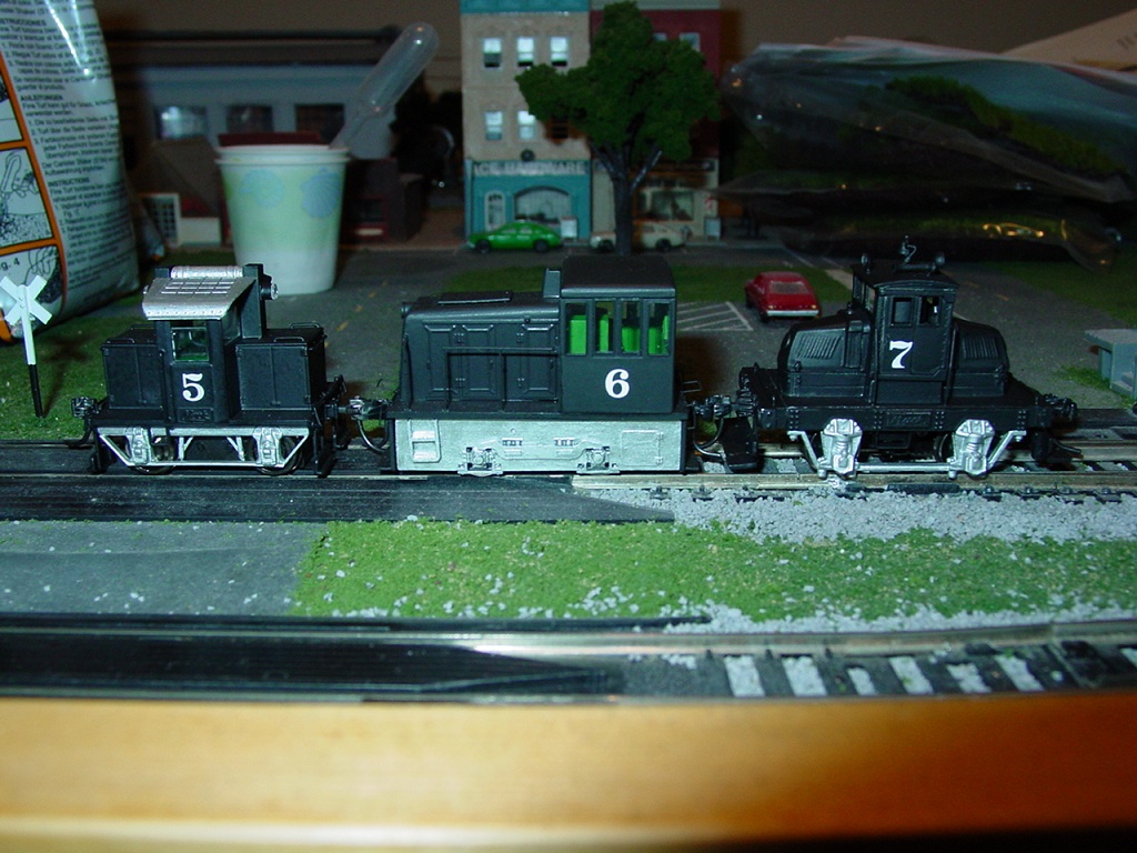

And now, here's my collection of powered critters that I've finished so far:
