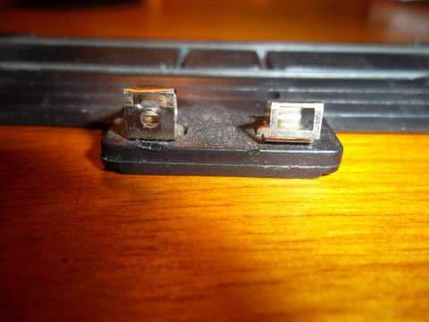

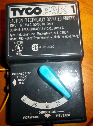

Here is the power supply I have and the terminal. The two connections on the terminal are different. It looks like the one is missing a piece on the outer connector that has the smaller hole in it that would hold the wire in?
Thought?
Thanks again everybody!
*I think I uploaded the pictures correctly*

Yes, the pictures uploaded fine. Yes, you are missing a piece on the terminal track. Some tight wrapping with the wire should be fine. Check your track connections, if they pull apart easily, they should be crimped * carefully # with pliers to make a tight connection, you should not be able to slide them apart on a slick surface with one finger on each piece of track. TIGHT connections equals great power transfer. Also check the metal wheels on the locomotive to make sure they're not gunked up with crud. Another major problem with non-running or jumpy engines. You said you had a TycoScene train, do you have the mat that track lays on to add scenery too? That's a hard piece to find nowadays. Post pics of your train and rolling stock too when you get a chance. We ALL like pictures on here.
