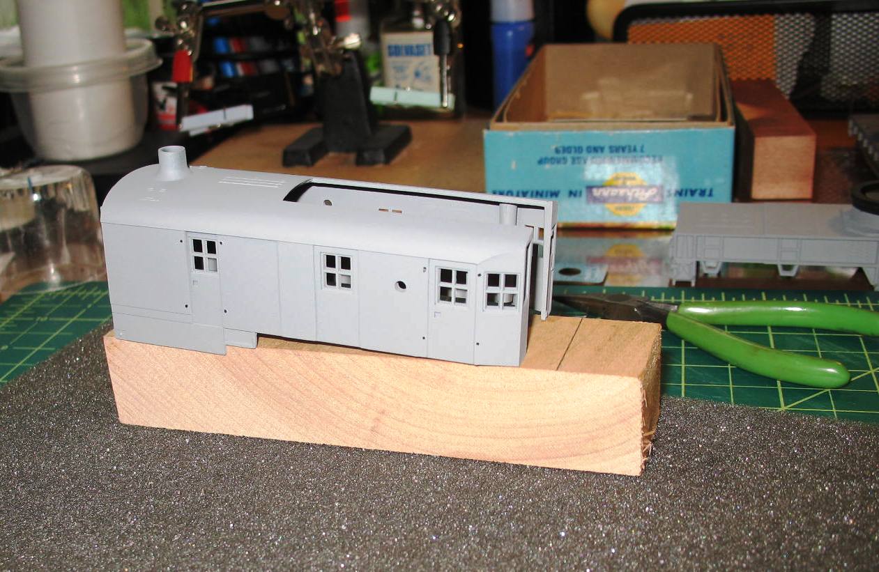

Recently, the Sioux Lake Shops finished refurbishment on an old Bucyrus Erie 200ton railroad crane.

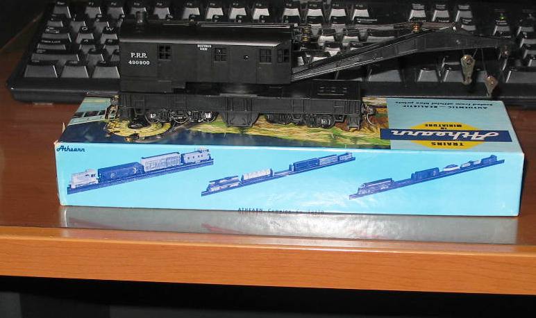

I started with an undecorated Athearn 200ton Crane. I had also purchased a second PRR one(in unpainted, but decaled black) at another flea market event earlier, so I offer this as the starting point for my project:

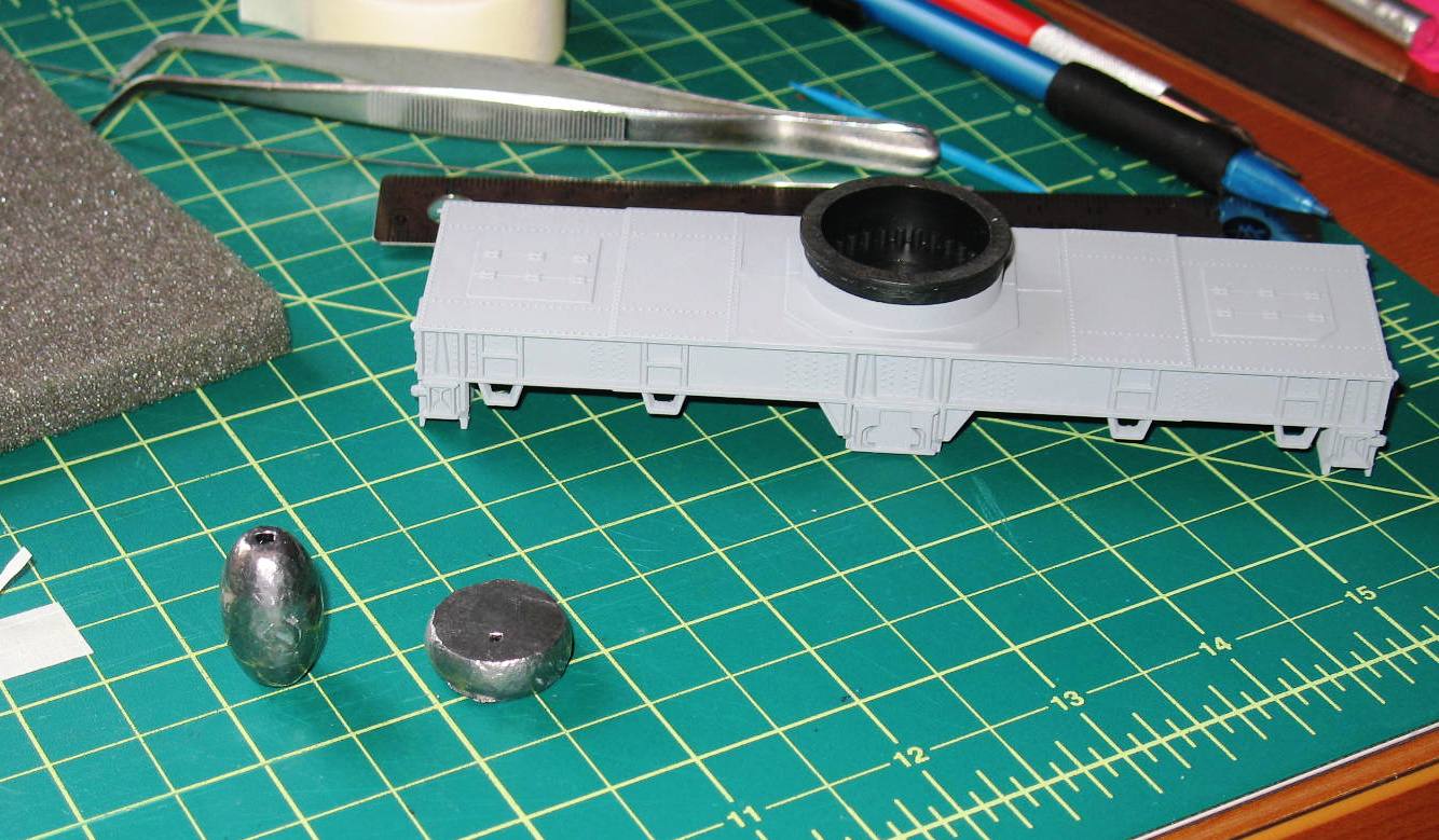

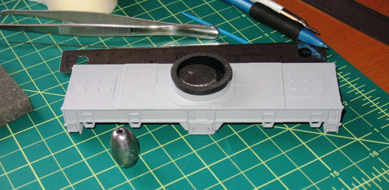

I had read articles about the tipping tendency of the model when the cab and derrick moved out to the sides of the car, so I was able to squeeze in a bit more weight:
These are the Walmart lead weights I "monger" in my workshop, and the result of applied hammering:
I located the weight in the center turret, as that was easier than interfering with the bottom weight of th car, and maintained overall balance.

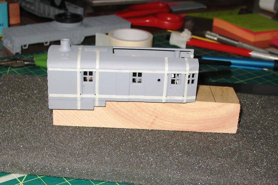

I decided to add grab irons for the doors on each side that appeared to open (there are two mid-body ones that appear to be fixed), so I used masking tape to find the exact intersections I needed to drill at. The grabs were made from .015 piano wire. I also made grabs for the deck of the crane base car as well.

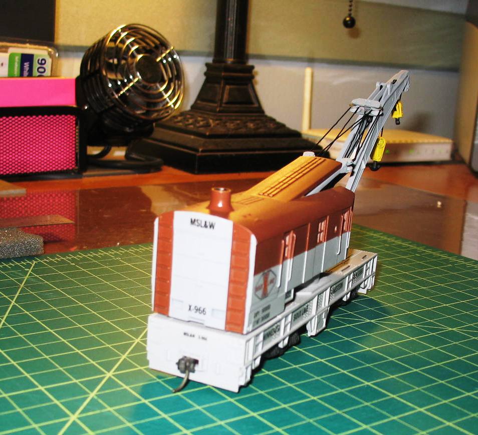

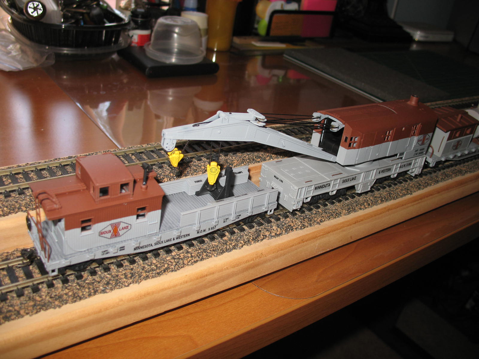

This is the end result:

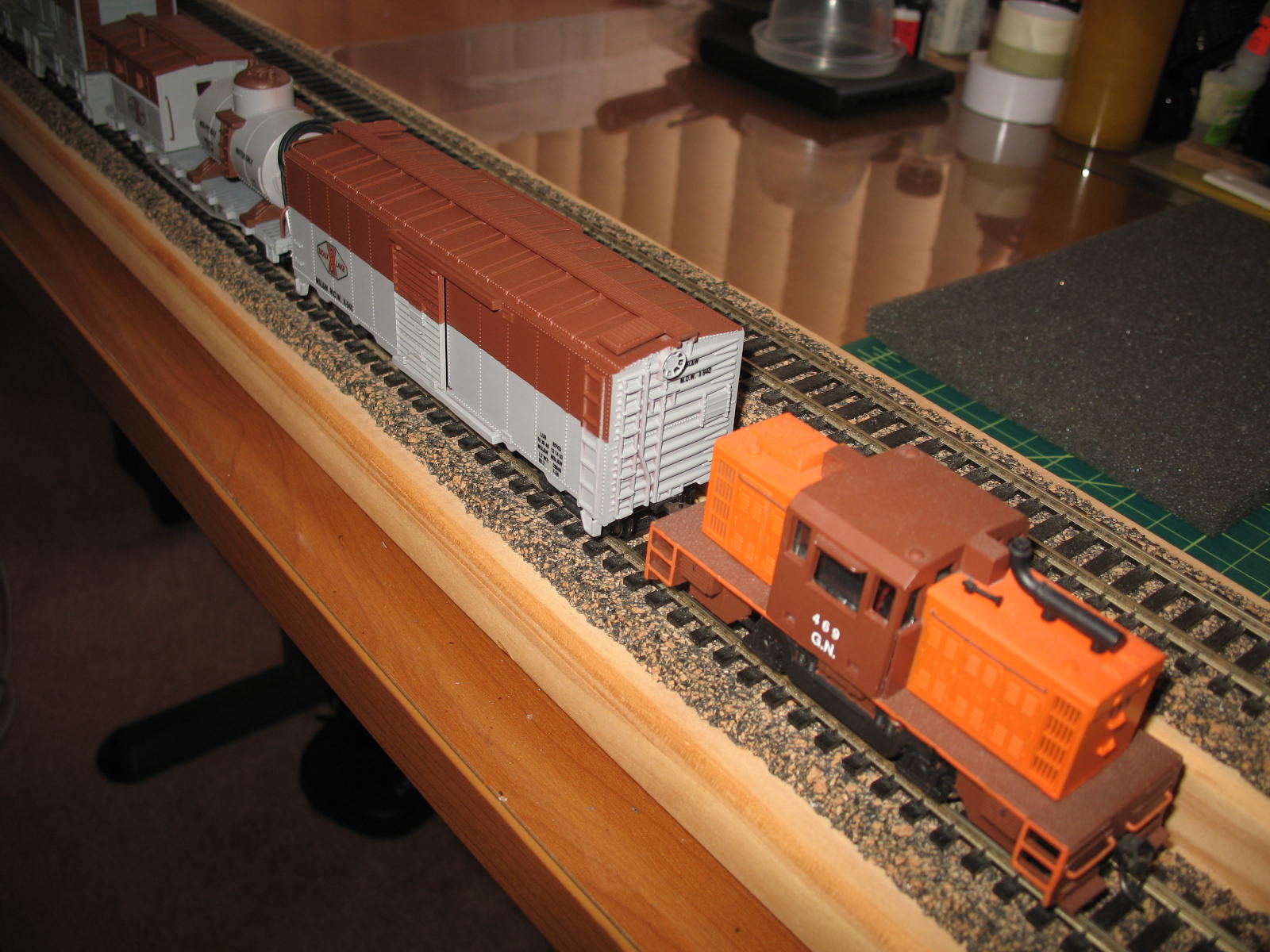

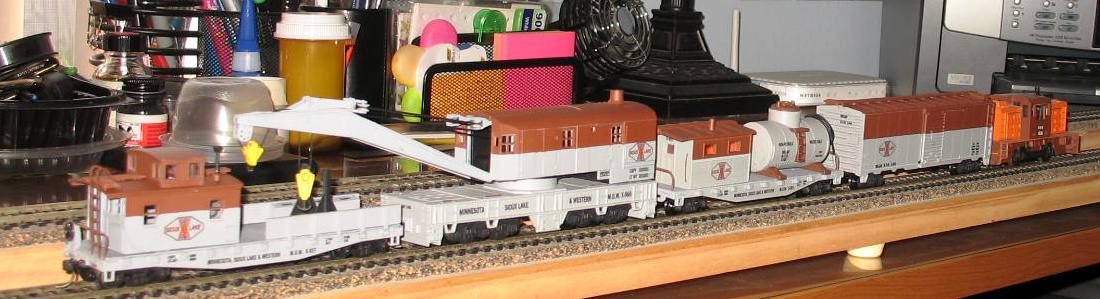

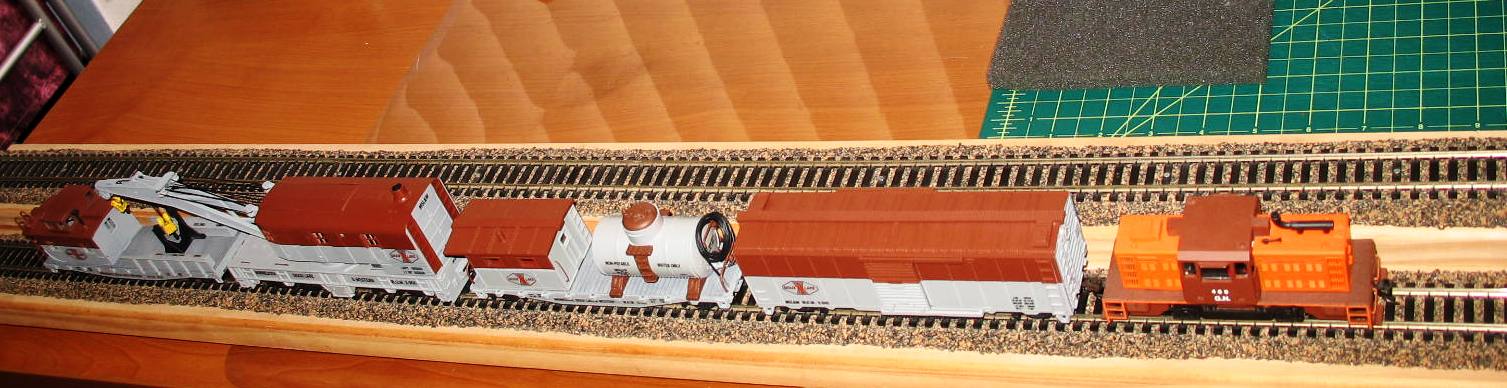

And finally, some family shots, with an old friend- the Center Cab- helping out!:

One question: Is the little Ge Center Cab strong enough to pull all that?
siouxlake
 Posted - July 26 2012 :  4:22:10 PM Link directly to this reply  Show Profile  Add siouxlake to Buddylist
Nelson-
I swear, as my beautiful and talented daughter was watching this morning, that lineup is on my test track, powered by Tyco, mind you, and that little AHM center cab moved the boys along quite easily ( if only for about another foot of track )! Both forward and backward, no less!
The reason for stopping at a 4-set of MOW cars is not only that it can become visually monotonous, but I am building a switching layout that precludes too much of any one thing.
The project was a skill-builder for decaling and making "something more" out of "plain vanilla", as two of the cars are $7.00 Model Power Hobbytown purchases, and the crane and tender are flea market old BBs. My total car cost for all of them was $30.00. The labor was free!
Ron
