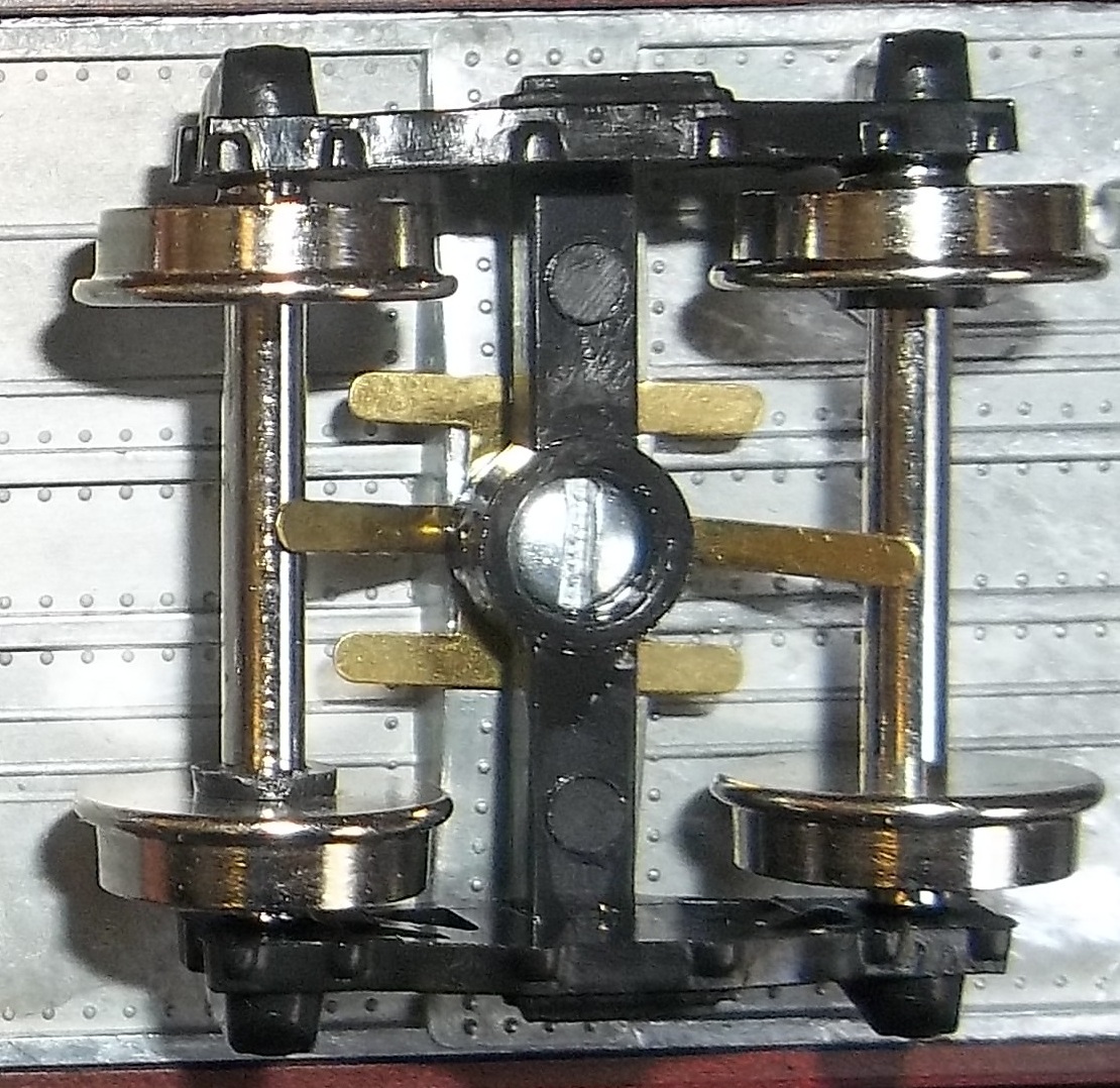

SCVR66
SCVR #2
 Posted - July 15 2012 :  6:58:49 PM Link directly to this reply  Show Profile  Add SCVR66 to Buddylist
heres a not so great photo but both tender trucks look like this.
I buy, repair, and collect
http://scvr.weebly.com/
Hyde.
 Posted - July 15 2012 :  7:00:30 PM Link directly to this reply  Show Profile  Send catfordken a Yahoo! Message  Add catfordken to Buddylist
you have mixed polarity on same trucks,both trucks should be negative one side positive the other not mixed on same truck ken
drivers side insulated,engineers side positive
in your photo the wheel to right has negative to top,where as the left hand wheels have negative to bottom
Edited by - catfordken on July 15 2012 7:07:35 PM
SCVR66
SCVR #2
 Posted - July 15 2012 :  7:12:18 PM Link directly to this reply  Show Profile  Add SCVR66 to Buddylist
Ohhhhh thank you very much Ken!! Guess I left that out when assembling the tender. Woops

 Posted - July 15 2012 :  7:20:18 PM Link directly to this reply  Show Profile  Send catfordken a Yahoo! Message  Add catfordken to Buddylist
just to make sure in my photo the wheels to top are insulated as are the other truck wheels,ie insulated wheels both on drivers side ken

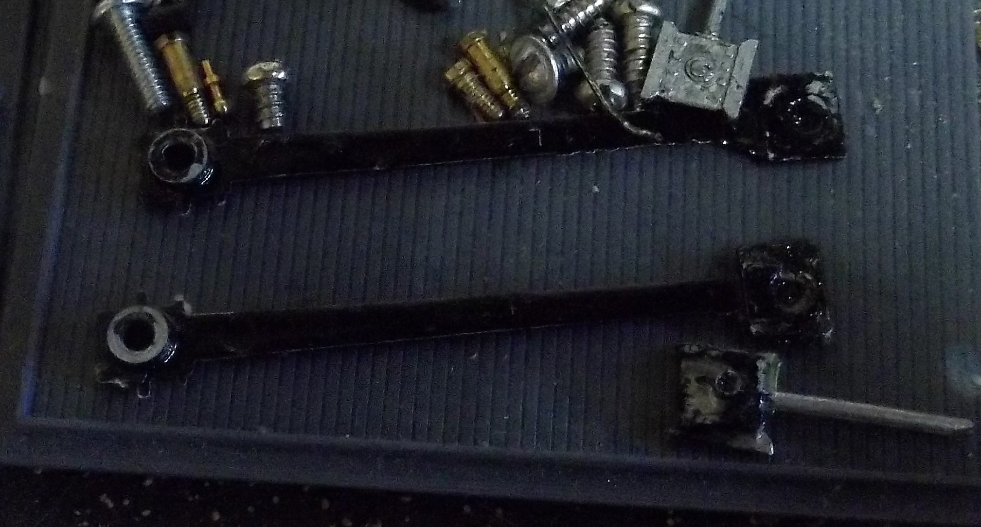

 Posted - July 15 2012 :  7:50:10 PM Link directly to this reply  Show Profile  Add NickelPlate759 to Buddylist
Sounds like you're not getting the rivet spread out enough. What are you using to flare it? An awl or tapered nail punch should do the trick.

 Posted - July 15 2012 :  10:20:06 PM Link directly to this reply  Show Profile  Add NickelPlate759 to Buddylist
If the rivet is mashed or damaged it would be hard to make it stay in place.
SCVR66
SCVR #2
 Posted - July 15 2012 :  10:42:37 PM Link directly to this reply  Show Profile  Add SCVR66 to Buddylist
the pin on the crosshead is fine but how am i supposed to keep the crosshead on?! The instructions make no sense.

 Posted - July 15 2012 :  11:30:24 PM Link directly to this reply  Show Profile  Add NickelPlate759 to Buddylist
From what I can see of the upside-down crosshead in your photo, it looks like the pin is a rivet that needs to be flared. The instructions don't make a lot of sense, I'll grant you.
I don't know if "slightly upset" means bend, flare, or insult it.

 Posted - July 16 2012 :  07:17:04 AM Link directly to this reply  Show Profile  Add shaygetz to Buddylist
They're asking you to peen the stud over...flare it out slightly without going too wide and gorming up the flexibility of the joint.

 Posted - July 17 2012 :  03:35:02 AM Link directly to this reply  Show Profile  Send zebrails a Yahoo! Message  Add zebrails to Buddylist
Originally posted by shaygetz - July 16 2012 :  07:17:04 AM
in english please sorry there are some terms i dont understand
Originally posted by SCVR66
[/quote]
Peened/Flare... make a mushroom out of the end of the rivet. But carefully as not too large because of possible binding and misfitting happens.
SCVR66
SCVR #2
 Posted - July 17 2012 :  11:12:56 AM Link directly to this reply  Show Profile  Add SCVR66 to Buddylist
oh okay but how am i supposed to do that? The flathead screw driver technique it says to use hasnt worked

 Posted - July 24 2012 :  01:34:49 AM Link directly to this reply  Show Profile  Send zebrails a Yahoo! Message  Add zebrails to Buddylist
Originally posted by SCVR66 - July 17 2012 :  11:12:56 AM
Screw driver, flat head... no.
Phillips, or a Rogers (boxhead), directly in the middle of the stud... to spread it out.
Sometimes, a "nail-set" tool is useful.
The idea is to make that rivet wider than the hole. The same principle as a pop-rivet gun.

 Posted - July 24 2012 :  5:14:24 PM Link directly to this reply  Show Profile  Send zebrails a Yahoo! Message  Add zebrails to Buddylist
oh okay thanks john!! I've put off the completion to work on other engines, but now i'll get back to work.
Originally posted by SCVR66 - July 24 2012 :  11:23:38 AM
A previous quote you had some weeks ago...
" While running her crosshead on the right side rod broke off the main rod well I thought they had finally attached but guess not."
Broke off? Perhaps you need to make sure there is enough "rivet" or "stud" in order to "disturb", flatten, mushroom, peen.
Dismantle the rod-set, put the "stud" through the hole, flatten (etc) the rivet, reassemble.
Oh, take pictures of this progress.
I believe other people will find this process very helpful AND instructional!
Who knows... you may get your OWN COLUMN in this forum.

SCVR66
SCVR #2
 Posted - July 24 2012 :  6:06:24 PM Link directly to this reply  Show Profile  Add SCVR66 to Buddylist
well a few weeks ago i sprayed paint onto a little toothpick then swabbed it all over the pin. It held up pretty well but i just did this to see if it ran well with the rods and if the valve guides were good. I'l get to work on it soon. Later today im going to see a craigslist add to possibly purchase so that'll come first
