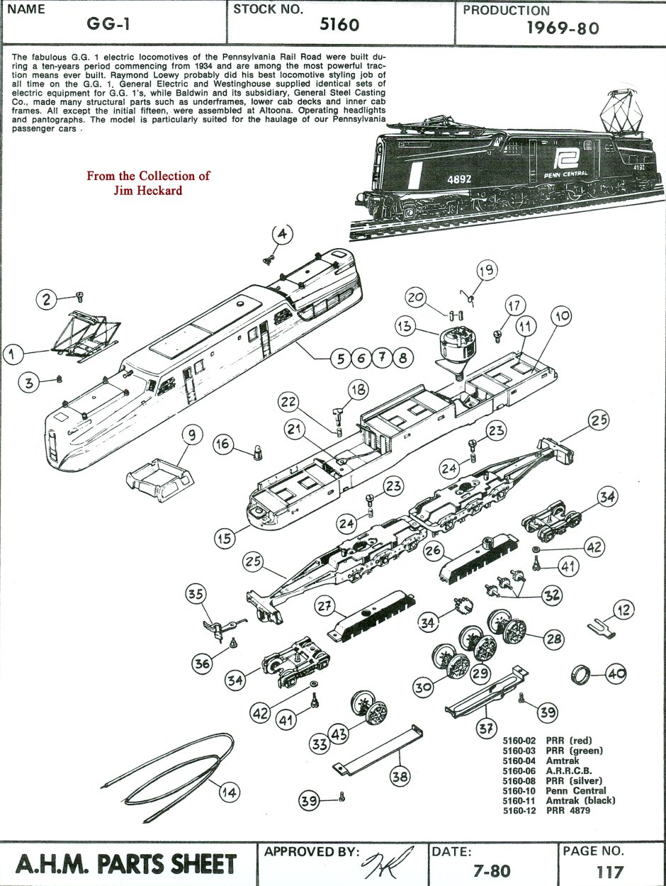

I need help my recent acquired GG-1. I can;t get that darn shell off for one. Seems as if both coupler boxes/pins are missing. Also, how does the front truck mount and how hard is it to find a replacement?

 Posted - May 23 2012 :  11:15:33 PM Link directly to this reply  Show Profile  Add shaygetz to Buddylist
Like any diesel model, just pry the sides open and let the mech drop out. Mounting the trucks changed over the years, you'll have to look for your specific time line.
http://hoseeker.org/AHMRivarossiassembly/ahm2cc2gg1pg1.jpg

Just to clear up the confusion... the Rivarossi GG1's were all the same, one of the few models they never revised, not even the motor. Don't confuse the later Pemco/Mehano, or IHC/Mehano GG1's, which copied some aspects of the Rivarossi design (mainly in the shell), but had totally different drives.
Both front and rear trucks on the RR are retained by pivot screws 17 and 18, and the motor is held in the power truck with a mounting fork.
