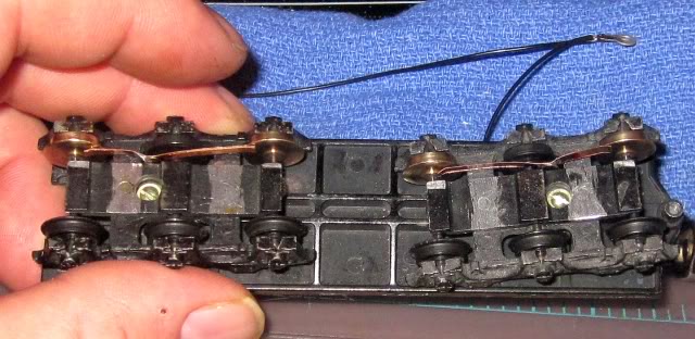

 Posted - May 11 2012 :  07:30:00 AM Link directly to this reply  Show Profile  Add shaygetz to Buddylist
Because of those Mantua needle bearings Justin is talking about, their pickup isn't the most reliable...I ended up adding axle wipers to the tender trucks...

 Posted - May 11 2012 :  11:58:23 AM Link directly to this reply  Show Profile  Add Redneck Justin to Buddylist
How handsome Bob! Gotta post a tutorial on that!

 Posted - May 11 2012 :  6:40:10 PM Link directly to this reply  Show Profile  Add shaygetz to Buddylist
Originally posted by Redneck Justin - May 11 2012 :  11:58:23 AM
By your command....
http://misterbobsmodelworksemporium.blogspot.com/2011/08/mantua-ho-scale-cm-rr-2-6-2-prairie.html
http://misterbobsmodelworksemporium.blogspot.com/2012/01/mantua-4-6-4-heavy-pacific.html

 Posted - May 13 2012 :  12:19:17 AM Link directly to this reply  Show Profile  Add shaygetz to Buddylist
LOL Nelson, WE ALL DO! I been at this for some timer and I too, still assemble the truck wheels on the wrong side, (Not paying attention to those on the locomotive!
Originally posted by EM-1 - May 12 2012 :  11:21:26 PM
Those who know anything about Mantuas can see in the picture where I was heading to electrical disaster on my tender...
 Posted - May 13 2012 :  12:52:38 AM Link directly to this reply  Show Profile  Add NickelPlate759 to Buddylist
Originally posted by shaygetz - May 13 2012 :  12:19:17 AM
Obviously you need to flip the drivers over.
