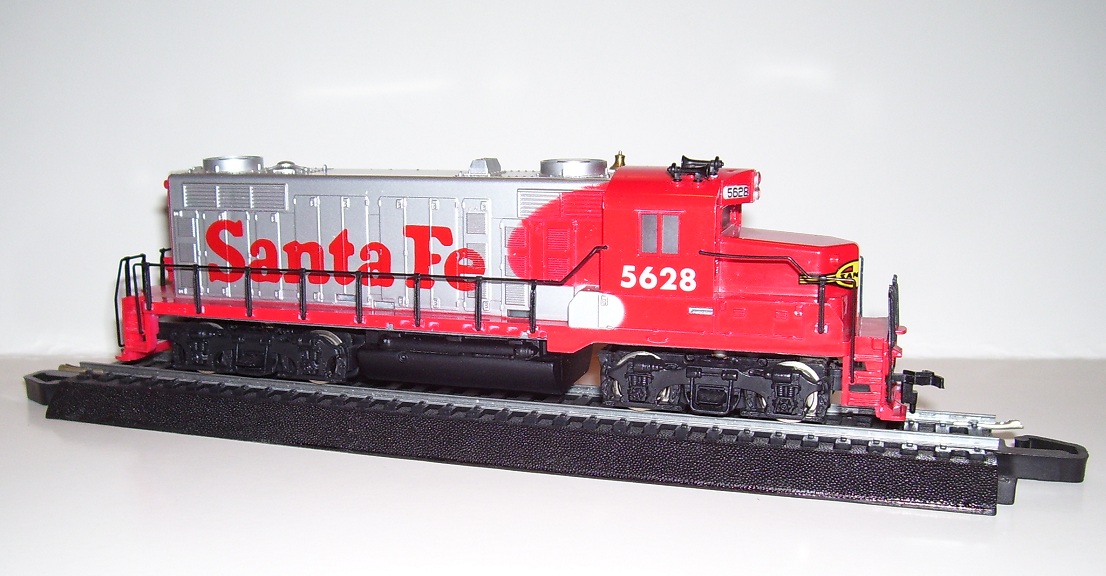

I recently put a Tyco GP20 shell on a modern GP20 Mantua chassis. I cut the front pilot just enough that I could spread it open and around the chassis mounted coupler after I had slipped the other coupler through the other pilot and then the shell onto the frame. The shell did require some grinding down of mounting pads and stanchion pockets to make it fit right, and it's reversible and reliable and different.
